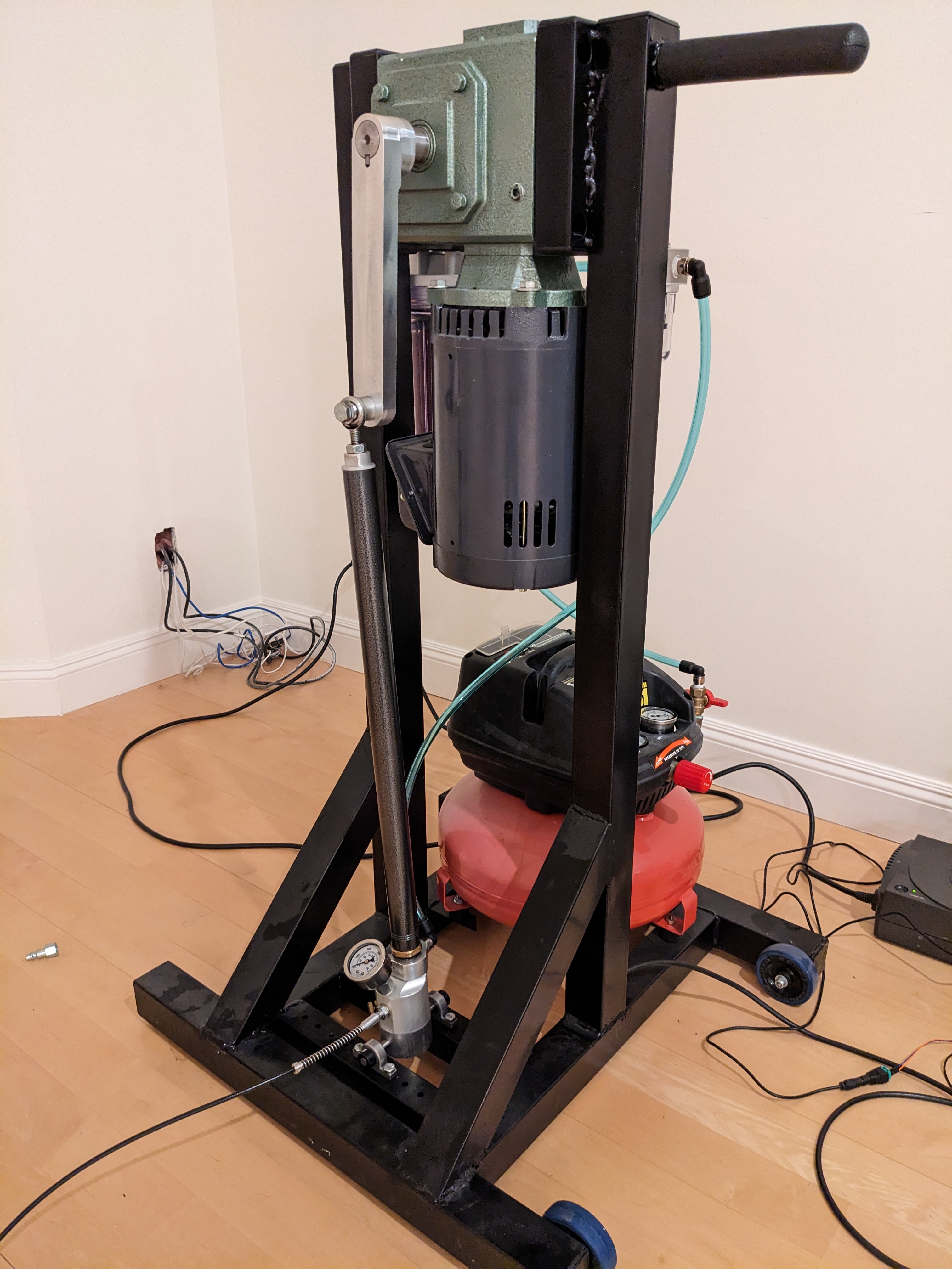

I even used it to fill my small Benjamin 90 cubic inch bottle. But that takes some babysitting. I'm planning to update the electronics to automate filling of even large tanks. Of course it would take a very long time but I won't have to sit and babysit it. For pumping times of less than 2 mins it can fill the equivalent of 20 liters of air at 1 ATM a minute at 300 bar. For sustained use needing cooling down time the fill rate is only about 1.8 liters per minute. The fill rate is faster at lower pressure because the pump doesn't heat up as much, so the on duty cycle is longer. Starting from an empty tank the fill rate is over 60 liters per minute slow down to only 20 liters per minute at 300 bar.
The Hill MK3 is a solid pump. I'm using to over 300 bar (4500 psi) over its rated maximum. I forgot to open the valve on my tank and it redlined blowing up the gauge, but no other damage to the pump. I'm still on the original o-rings. I stop pumping when it gets warm a let it cool down for 10 mins. At 300 bars that about 60 pumps.
Of course I started this long before they had decent low-cost compressors that work OK. I wouldn't recommend anybody build such a thing today.
What's the little pancake compressor for? Are you boosting your air a little before the handpump or just sharing a drier or something?
Yep, it boost the inputs pressure to the hand pump and has a filter and large desiccant dryer. Starting with 0 psi pump output, the boost can be more than 60 psi, at 4500 psi the boost can only be about 10 psi without overloading the motor. I'm planning to add a motor current sensor and stepper motor to control the pancake compressor to automate the input pressure. Keeping it at the highest level without overloading the motor.
I have just bought a quiet 4.3 gallon Kobalt compressor to replace the super noisy pancake compressor. The old compressor was way too loud and really couldn't flow enough at the higher boost levels >25 psi. The Hill pump doesn't seal the boosted input well. So additional flow is needed to compensate for the leaks. I'm going to add a pneumatic valve to only output the boost pressure on the intake stoke of the pump. That should cut the leak air by 1/2. Since I can't run both the boost and the hand pump motor at the same time on a single 20amp circuit the compressors tank has to hold enough air for a complete on cycle of the hand pump.

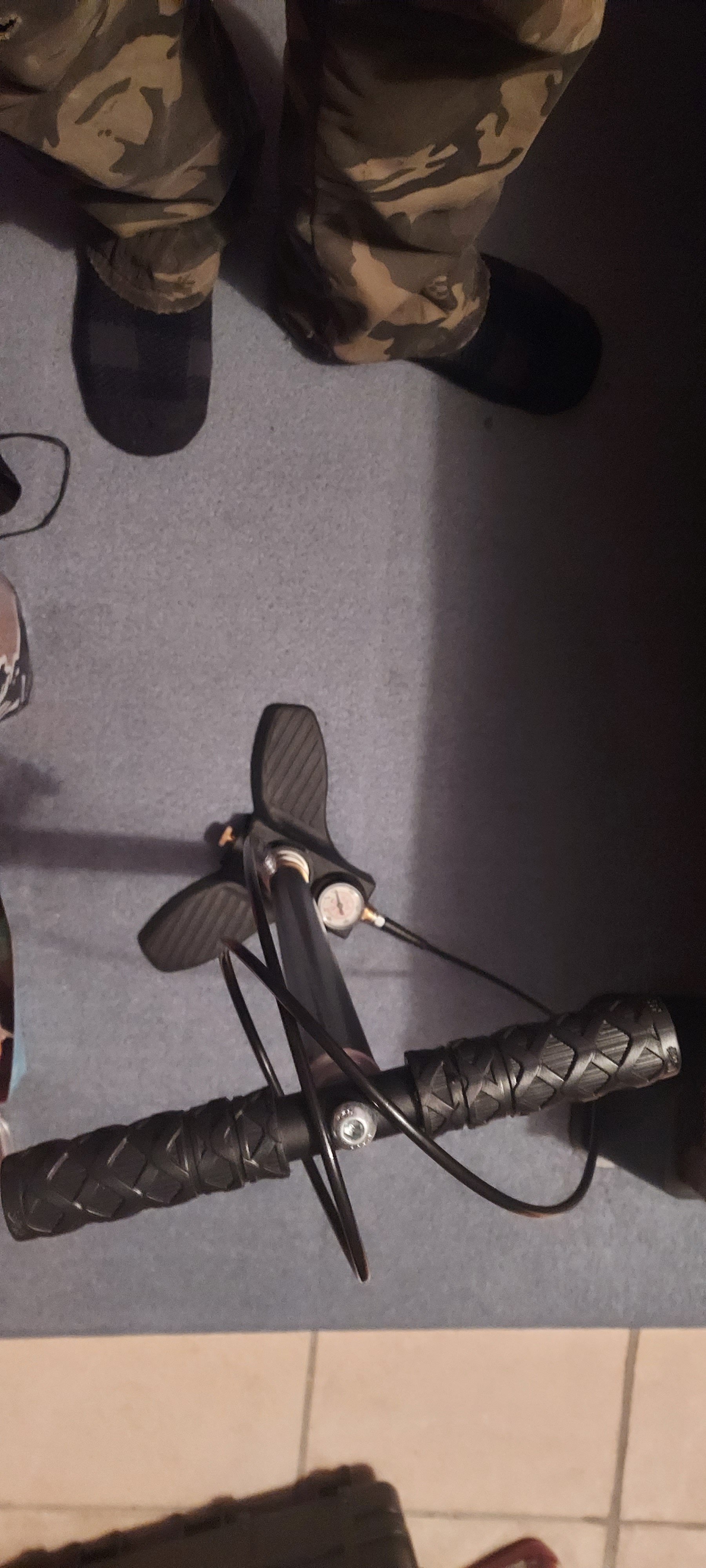

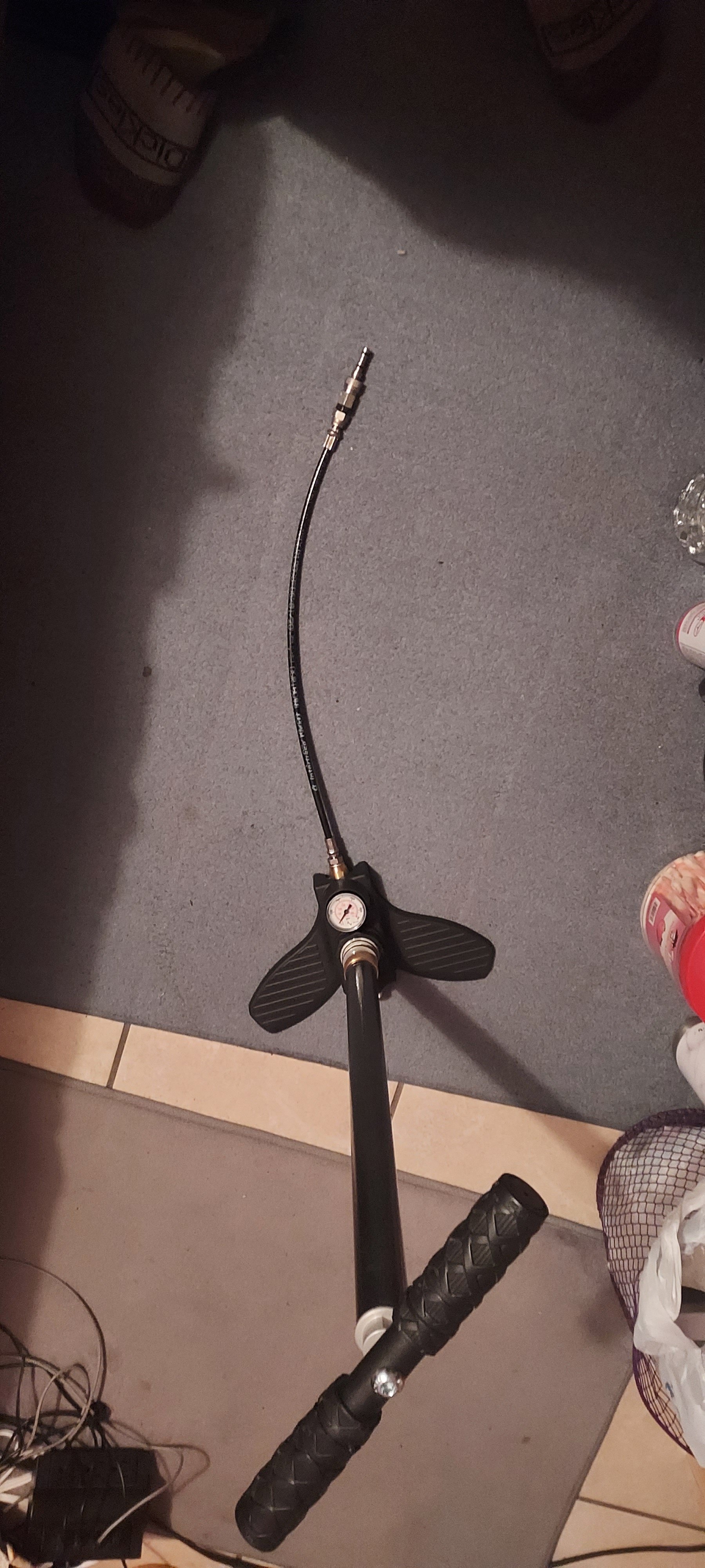

I recd my new to me MK5 Hill pump and gave it a spin tonight. Actually I didn't find it too bad. I topped off my Caiman to 300 bar. Yeah it's a little boring, but a little better than I had expected. Easier than pumping up a Jeep tire by hand-lol
The Hill pump seems to work fine, although I am not fully impressed by the build quality like I had hoped. Does this pump need any lubrication with use?
I did notice the gauge on the pump is little ahead of the gauge on the Caiman?
Didn't try pumping the Daystate up, but the tank on it looks larger, probably more work!
