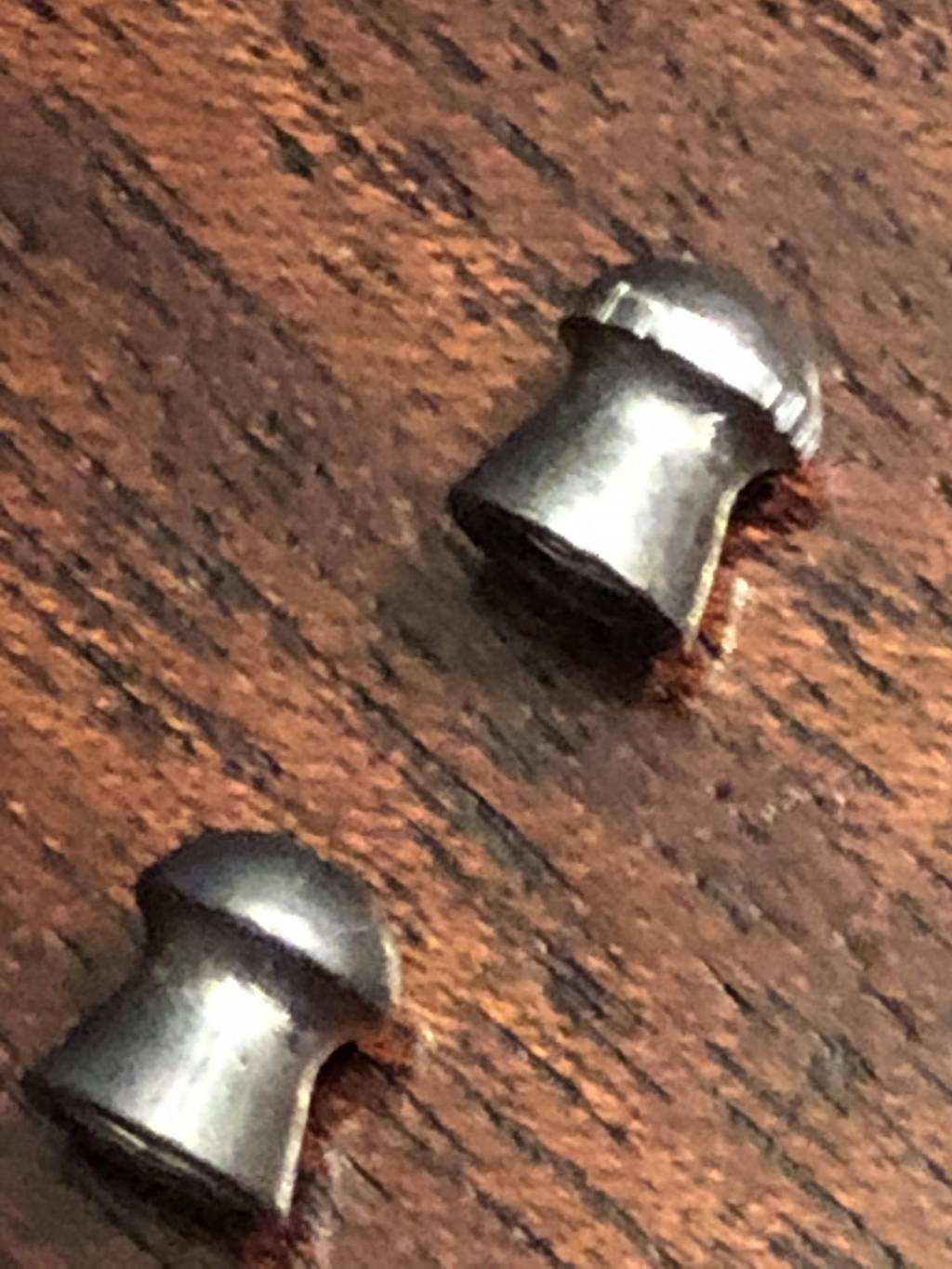

The pellet was the Crosman 14.3 HP, I’ll post a pic.

The G2 was designed as a high-power hunter made to sling heavier pellets very accurately. The rifle out of the box has no way to adjust the power down to handle something like a 14.3gr Crosman. As I demonstrated in my Complete Review of the Gauntlet 2 in .22 caliber, accuracy for the Gauntlet 2 doesn't start to shine until you get that speed below 900fps. The Gauntlets all have a 1:20 twist rate and produce the tightest groups when the projectile is traveling somewhere between 850 to 900 FPS. It has been my experience that 880 FPS produces the most common favorable results in the Gauntlet 1 or 2. In my review, the JSB 18.13gr projectiles were traveling at an average of 995 FPS and the JSB 25.39's averaged 891 FPS. In my opinion, the groups got better with the heavier ammo because again we started to get that rate of travel below 900 feet per second. I am willing to bet you are driving those Crosman premiers somewhere around 1050 FPS. The high rate of travel combined with the hard lead are causing issues.
In your case, you have two things against you.
  1. Crosman is one of the hardest lead pellets on the market today.
  2. Crosman Priemers only weigh 14.30gr.
    [/LIST=1]
    Because of the harder lead, the pellet to lead in interface is much more difficult. The elevated force required has the potential for the rifling to carve the lead in a nonconcentric way which would impart grooves on obscure angles that ultimately will cause the projectile to fly unpredictably.
    So there is one thing you can do right out of the gate to improve your experience. Get softer lead 25gr+ pellets like JSB, Air Arms or FX pellets around the 25 to 26gr range. These will chamber easier and be far more accurate.
    If you have your heart set on Crosman Pellets, you will need to slow the rifle down and have some barrel work done to stretch out and soften the lead in.
