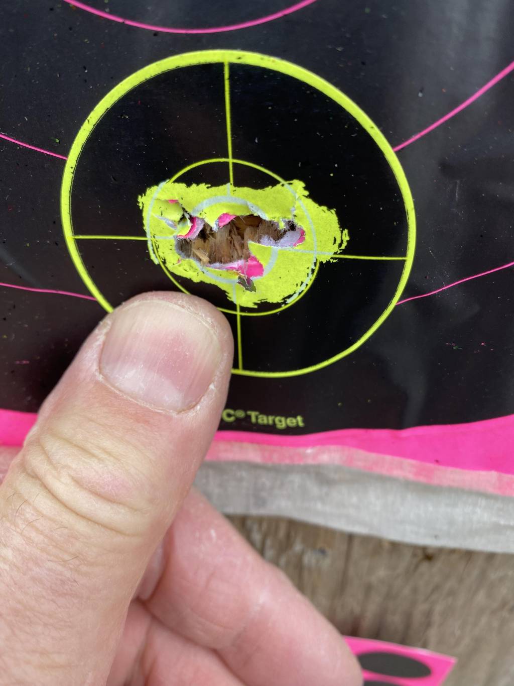

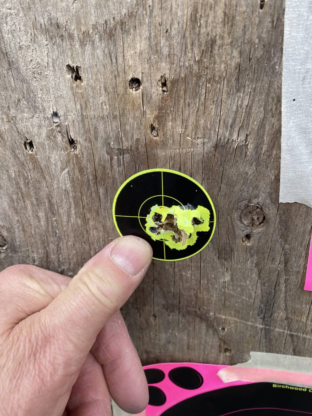

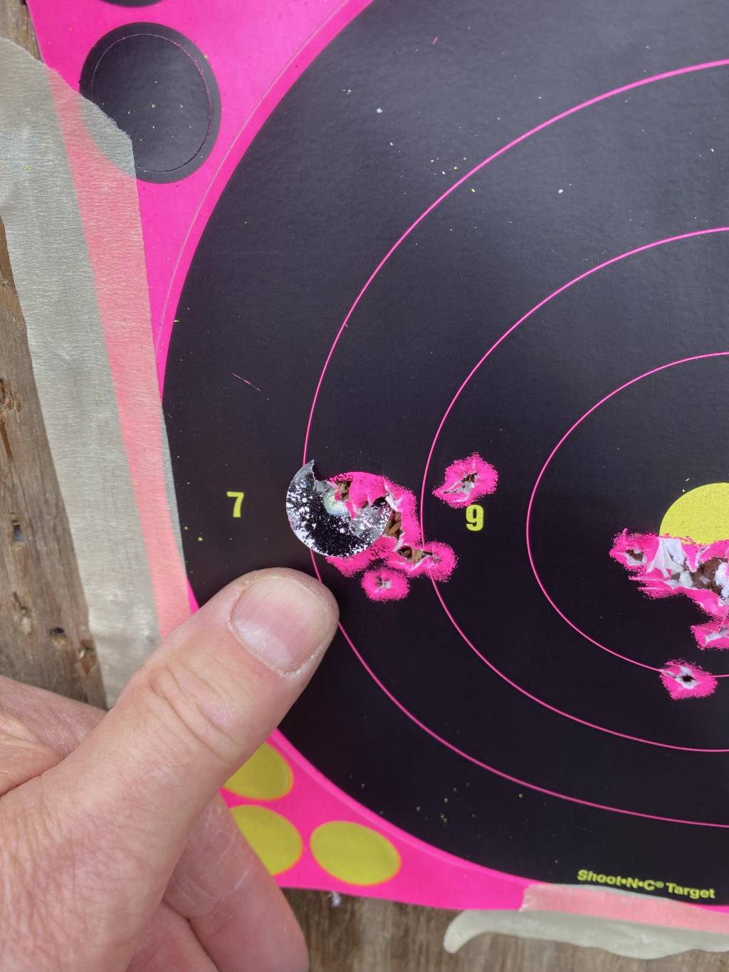

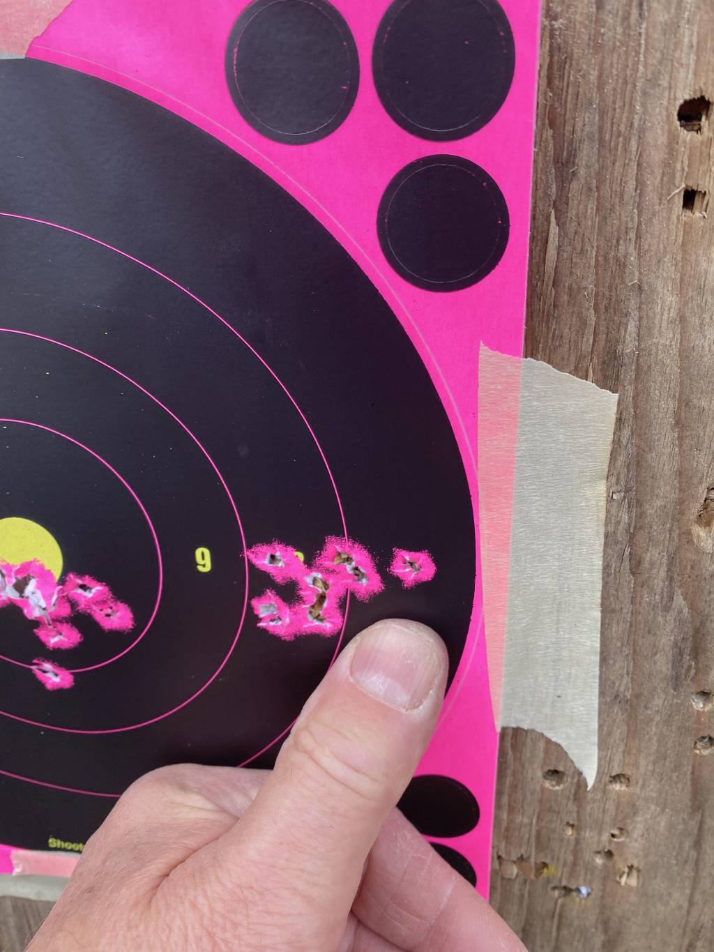

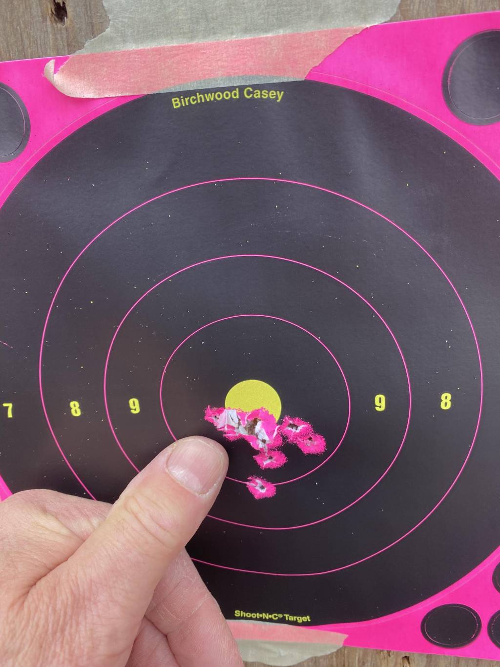

I wanted to compare the JSB 10.34 VS. Hades. All shots are 25 yds. and each target is 10 shots. Couldn’t get my crony to pick up the .177 rounds.
The first rounds Hades
 The second round with JSB 10.34.
 I thought maybe the Hades didn’t get a fair shake, go again, All shots with HW98, one of my favourite to shoot
 rifles. Next let’s be fair 10.34
 Again the dome wins, not surprising. Maybe I was off, third roundwith Hades.
 Last with dome. Going for #8.
 I personally thought the Hades would have performed a little better. Still a fantastic round. I’ll likely try this with .22. cal. My thumb nail is a little bigger than a dime. Crow

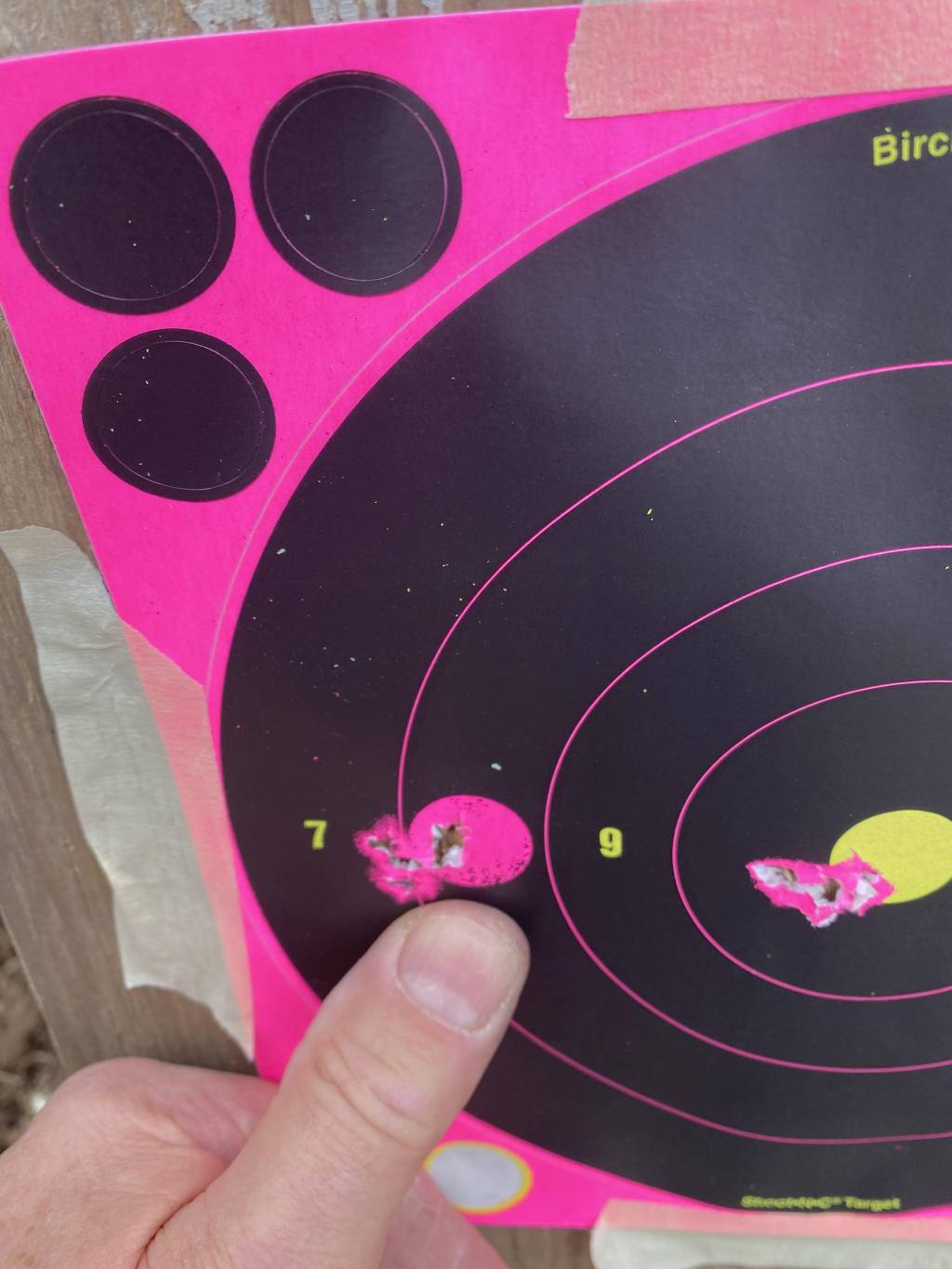

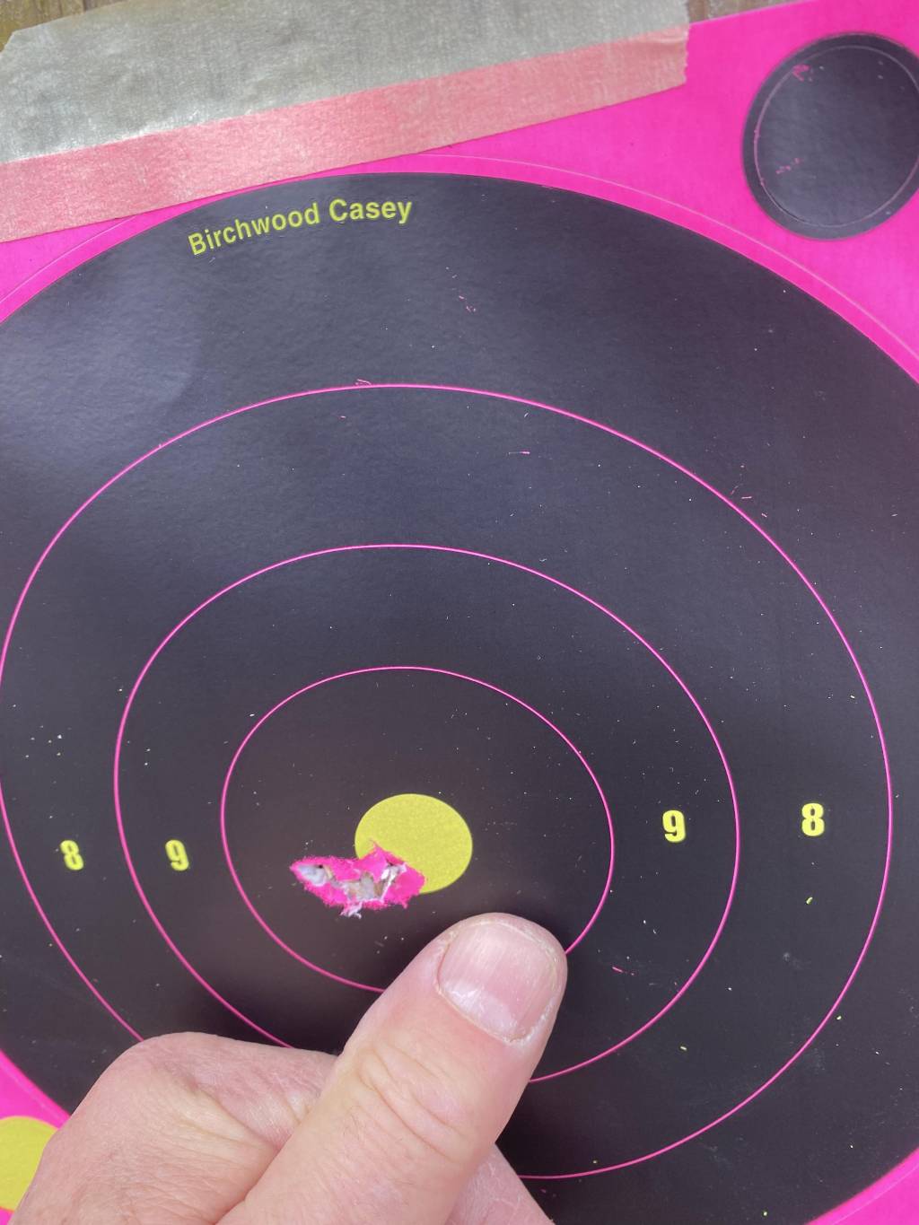

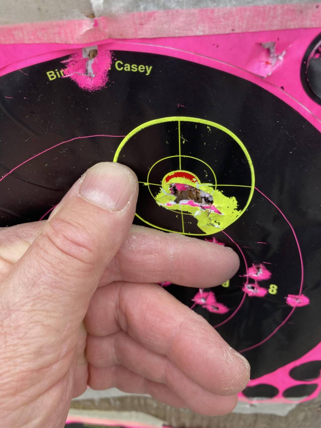

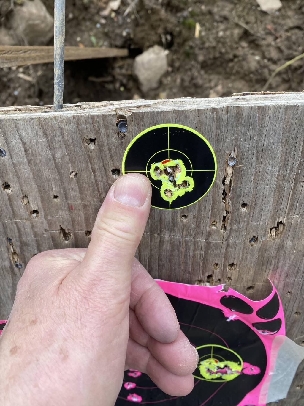

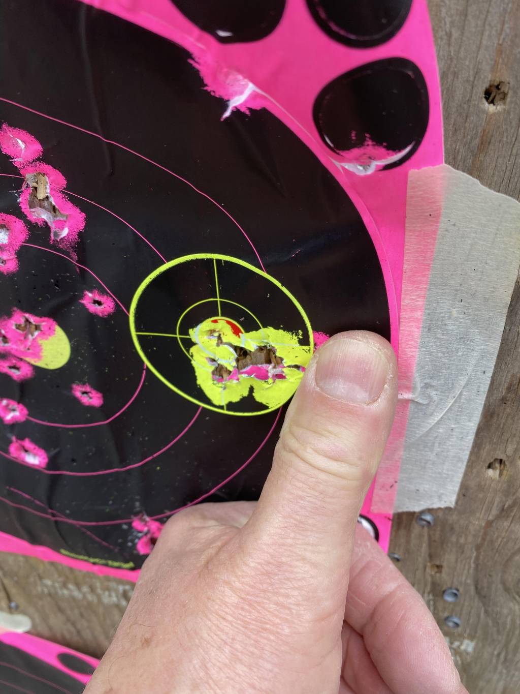

Well I didn’t get much work done today. I got my .22 HW98 out to
 compare. First Hades.
This next is with a Dome. Again 25 yds.
Hades
 is tightening up. Pulled a few.
15.89 Dome
Third round with Hades. All
 shots were consecutive.
Last round Dome.
 Seems to be a little closer with the .22 for me. I’m going to grab a gel block next time in town and compare the two. Crow

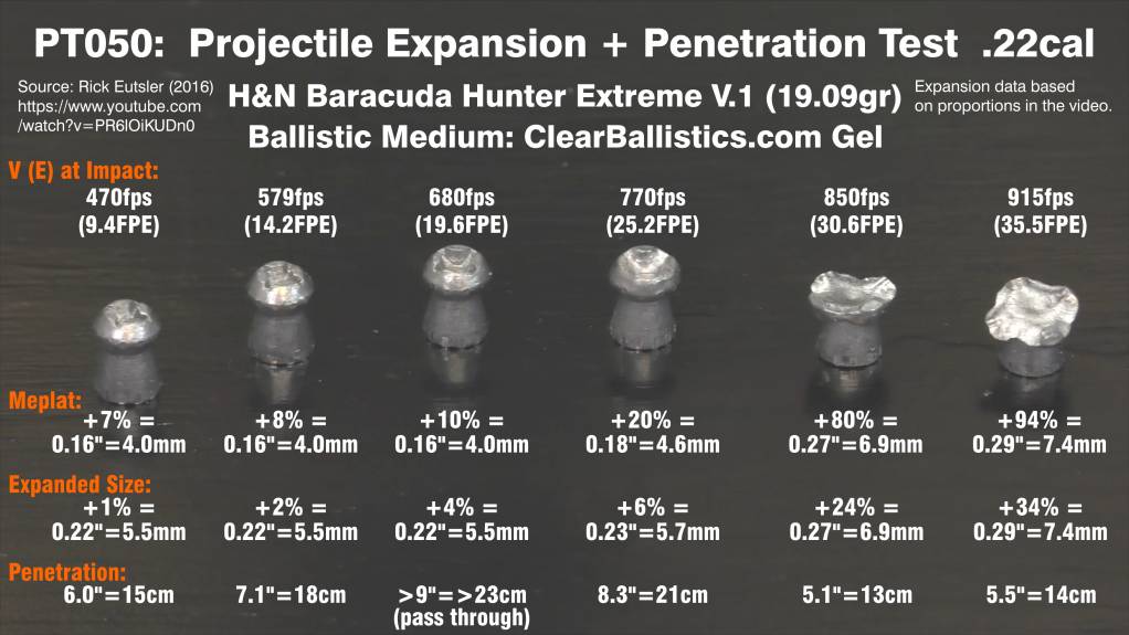

All that said, I hope your tests will show us at what impact velocities the Hades expands how much in artificial flesh (10% ballistics gel).
As an example I'll attach below a test that is simply an excellent test — extremely helpful for choosing your power setting and maximum range for this particular HP pellet.
Matthias
Projectile Tests. PT050.  Rick Eutsler AirGunWeb 2016. -ClearBallistics.com Gel.- 936FPE. Bc H...jpg

I think the impact velocities where significant expansion starts to occur are between 750fps and 850fps.
So, if you can chrony your Discovery's muzzle velocity, and then place the gel at appropriate ranges to achieve those slower impact velocities — that would be awesome. 😊

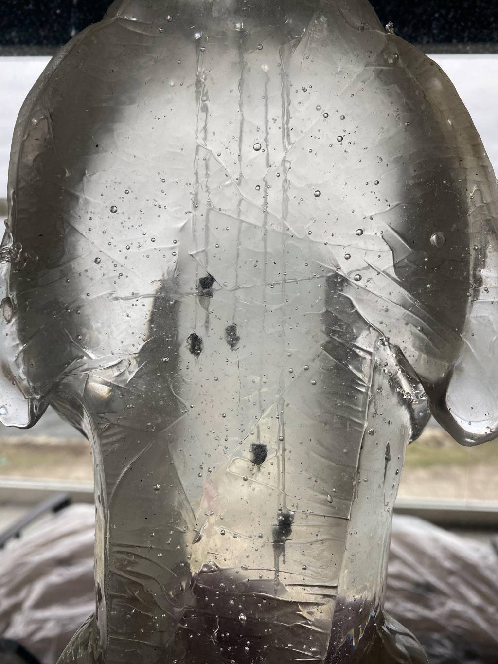

This is pretty cool. I got the Gel block. They are not cheep. The one I wanted was $250. + .13, a rectangular block. I got one the shape of a full size rabbit. I also got a mood with it I can melt this down and get my block. Looks like rabbit season to me. I couldn’t wait to try, six shots while BBQing. It was difficult to get a decent photo.
 I was caught totally off guard. I expected the opposite.
The bottom 2 shots HW98 .177 JSB Dome 10.34.
‘Next shot Dome HW50 .22 JSB Dome 15.89
Third row, 2 side by side HW98 .177 Hades 10.34
Top round HW50 .22 Hades 15.89
I thought for sure the Hades would cut it’s way quicker than the Dome. I would think larger surface area more friction.
No or minimal distortion in pellets at these speeds. Crow
