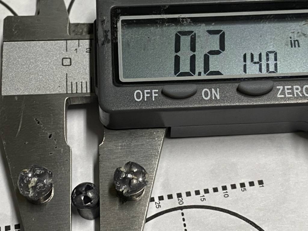

Then I realized I haven’t tested .22 Hades, so I loaded a few .22 Hades I to my impact shooting at 830 FPS and shot an apple 2 inch across. I left rolled up old clothing behind it to capture the pellet and to my huge surprise I see massive expansion! The pellet dumped all its energy into the Apple and did not even penetrate a single layer of thin cotton! Even the .177 hades went through 2-3 layers of the same thin cotton but the much lower power. Shocked and in disbelieve I grabbed couple of more apples of similar size and the .22 hades consistently expand at speed I did not expect on a little Apple which I did not thing had enough mass to cause expansion!!!!
I’ll let the pictures do the talking:
830FPS .22 hades expanded to .25 after hitting a small/2 inch apple 20 yards away.
for reference a unused Hades measured .214
can .22 hades be the best expanding hades if not all hollow points?

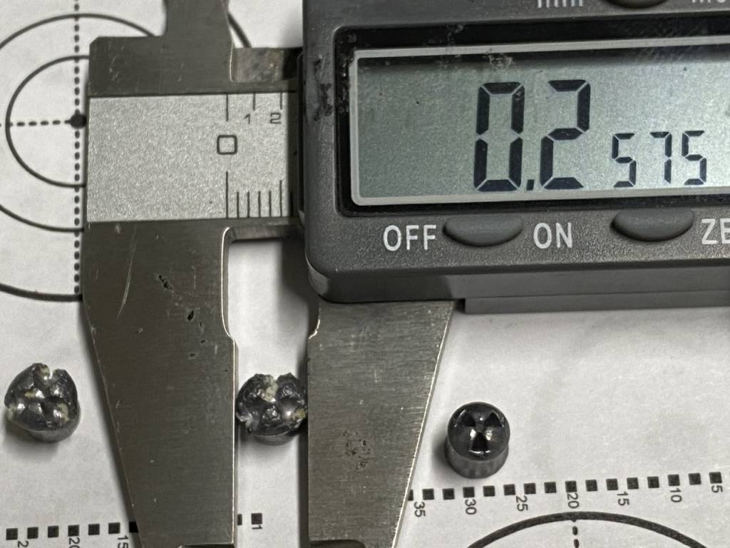

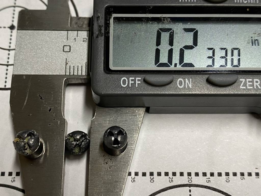

Well I figured why not try even lower speed? Dialed the power wheel to minimum and the hades is flying at around 705fps into a small Apple again! To my utter shock the little .22 hade expanded to .234!!! Holy expansion Batman!!! I even hit the same Apple twice just to be sure and both expanded.
I’m now fairly convinced the .22 hades are the best hollowpoint ever!!!
to put things into perspective I am not hitting a hard bar of soap, no fancy ballistic gel, not a big bucket of water. I’m hitting a bunch of small green apples that my kids won’t eat Each just a little over 2 inches across.
Interesting results. Not a massive mushroom but some visible expansion. The head "sections" rotating could apparently do a lot of damage.
it’s a massive expansion compared to any other hollow points I’ve used especially at 700FPS. Couldn’t get anything else I tried to expand at lower speed. The hades does seem to tumble a lot more and the additional damage is very obvious.
