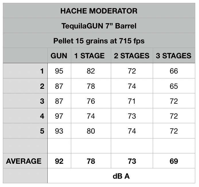

Video of the unit being shot with and without... please include audio and power information regarding the gun.

Here are some numbers.
