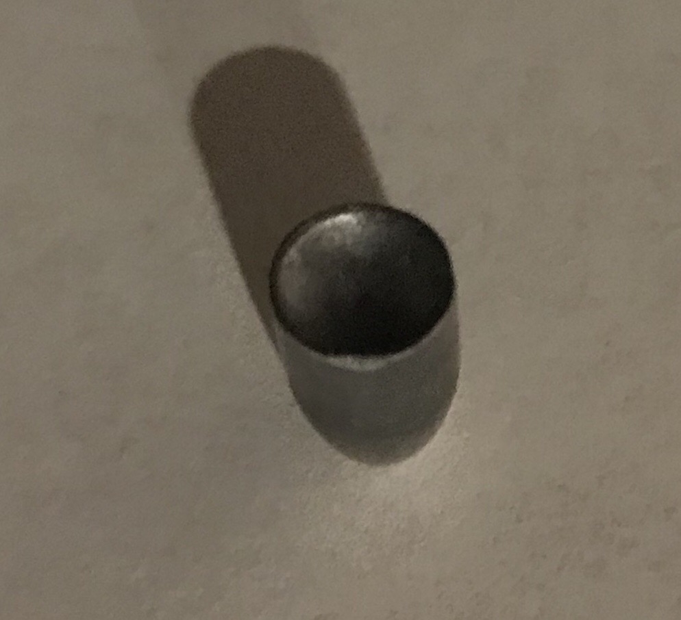

Here are a few details on the sample slugs that H&N have produced. I don’t know if these are the same as they are planning to mass produce and they may well be waiting on some feedback as to how these work. There are 5 different weights in the sample pack. 21 23 25 25 and 30g. They seem well made and uniform.
1566215778_20471559195d5a8e627f7119.39554379_9622F329-F1B2-40AE-A8C6-3E8CAFD0B51E.jpeg
The only slugs I have to compare them to are the NSA slugs. The H&N aren’t bad but NSA to me look like a better made slug. The lead the H&N slugs are made of is much softer than there pellets and early slug offerings.
The rear of the slugs are concave and I measured 1mm in depth. This is the same for all weights.
