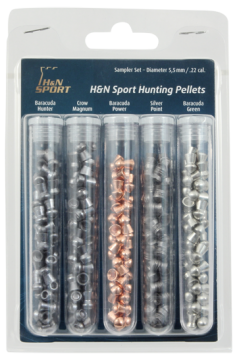

Maybe the variation in pellet size/weight is part of the grouping issue James. I really enjoy the consistency (more or less) of Crosman Prem Domes. Not as expensive as the H&Ns and with the savings you could pick up a relatively inexpensive digital scale if you want to become obsessed.
But sorry to your question, I like The H&N Barracuda Hunter in my Benjamin 392 Steroid. I’ve read a lot of positive feed back about the Crows but I’ve not had much success with hollow points. Now Their Barracuda Match with much the same dome shape as the Crosman works well for me too.
But anther suggestion why not try a sampler? I happen to have .22s so...
https://www.airgunsofarizona.com/pellets/h-n-hunting-sampler-pellet-.22-caliber/

Yup sorry about that guys. Yes I have a .22 cal Gamo. But unfortunately I’m better off trying to sell it to some young kid cuz have no idea where the receipt is for the gun. Growing up I always had people telling me they were great guns so I didn’t bother researching for other stuff online. I’ve thought about buying samplers just hated the idea of being stuck with them if they shot poorly outta of my gun like the last set of pellets i bought I couldn’t keep a group smaller then 10 inches at 20 yards so I can’t use them for hunting or target practice. I’ll definitely have to look into those other pellet rifles and maybe figure something out with the Gamo. I’m not hurting for cash all that bad so if I can get good recommendations on good spring or nitro piston air rifles I don’t mind spending the money. Thanks guys
