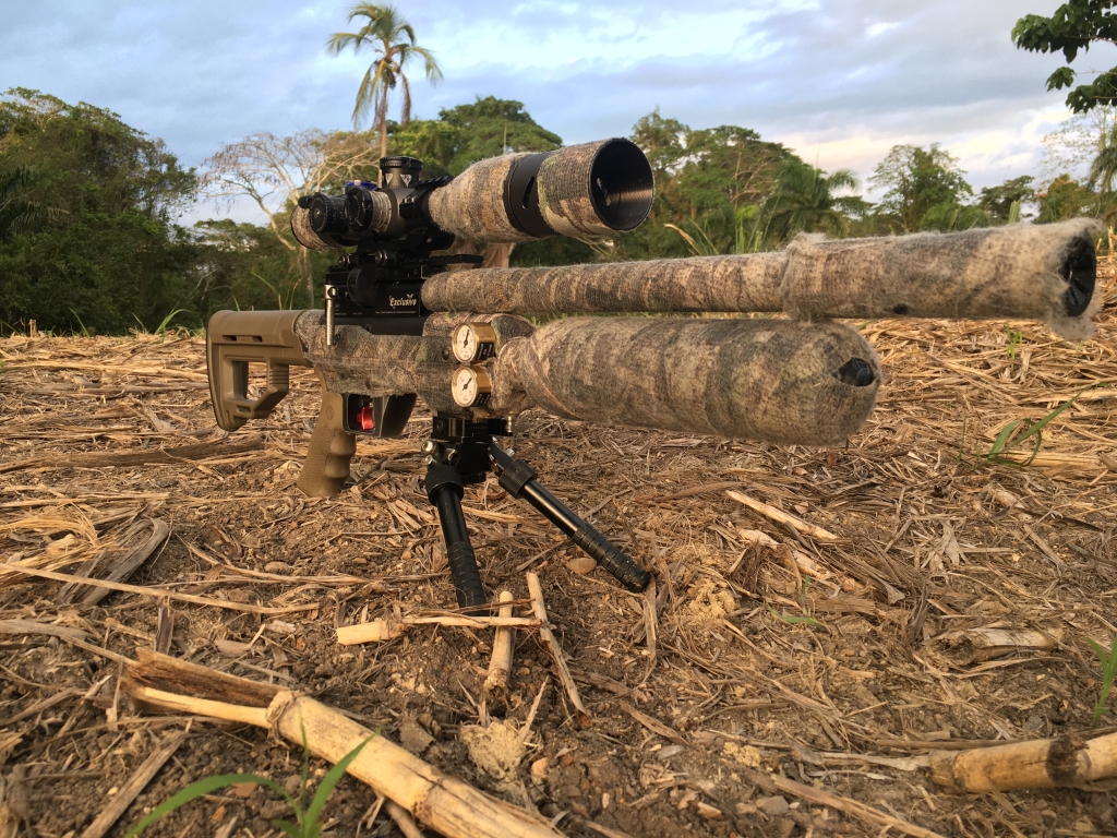

my friend don't spend any more money. that fx only wants to sell and sell and its liner does not work. fx what you want is for your user to buy everything they launch on the market. I sent to mechanize a Tjs with bill greathouse. for my impact and I shoot everything I want without any problem and with very good precision no matter the distance. In my warp cobra I also have a 14.5 "inch tjs and it is very accurate at 175m with the grizzly and other slug and pellets the tjs barrels are also amazing. I do not know how there are people so stupid that having barrels that are better than nonsense finer liner and that work better and with all kinds of pellets and slugs regardless of gr. they may be accurate. buy liner fx 😴🤔🤔🤔🤔

Friend, what I want you and the rest to understand is that I with a single barrel can do what you can't do shoot all kinds of pellets and slug no matter the grain. You need another barrel yourself to fire the H&N. or shuffle. or jsb. or NSA. fx sells you two barrels just to shoot the pellet or slug that only works on fx barrels. in my TJs .25 with a torque of 1:22 I shoot everything no matter what the lead is. and with the same precision as you. So that's what I mean so that the limit that your user implants fx. I don't know how they are fooled like this. and now they released another barrel that you and the other fx fans would buy it 🤣🤣🤣🤣. I am a hunter not a collector of barrel hahahahaha. and this of using airgun is super good nothing better than this. But do not take fx that they are dealers and if you take them they make you like $ 10,000 a month in accessories. Look here I am going to upload two photos so you can see everything I can shoot with my TJs. jsb 25.39gr. kite 25.4gr. baracuda 28.24gr. grizzly 31gr. NSA 29gr. NSA 38.5gr. and the largest slug you see on top of the box is 46.2gr cast by that mold you see in the image

stop focusing so much on the fx liner crap. and investigate the tjs when i bought my rifle and ordered the barrel i told jim gaske that i wanted a barrel that would shoot pellet and slug. and he said 1:22. I am going to do the tests and I will upload the video on my instagram page @ airgunplusrd1 gentlemen do not get so much fxairgun that they are a businessman. and they will manufacture the same product with different names each month. You can see how the YouTube that fx pays you now they make video with the 3-inch STX now before that did not happen. now the STX is not accurate because they launched the superior liner and many of you take them and buy it from asshole. analyze do not be fooled. my TJ does not pay me anything and I see that they are a thousand times better. I had an impact and I sent him to mechanize the barrel I gave him a tj and it was much better. but it's not everyone who knows how to work at tj that's what Bill O Roy is for one of those two people are what do the work to make those barrels magical,
