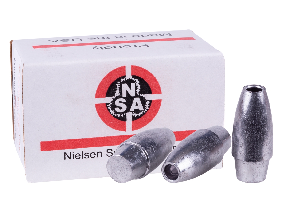

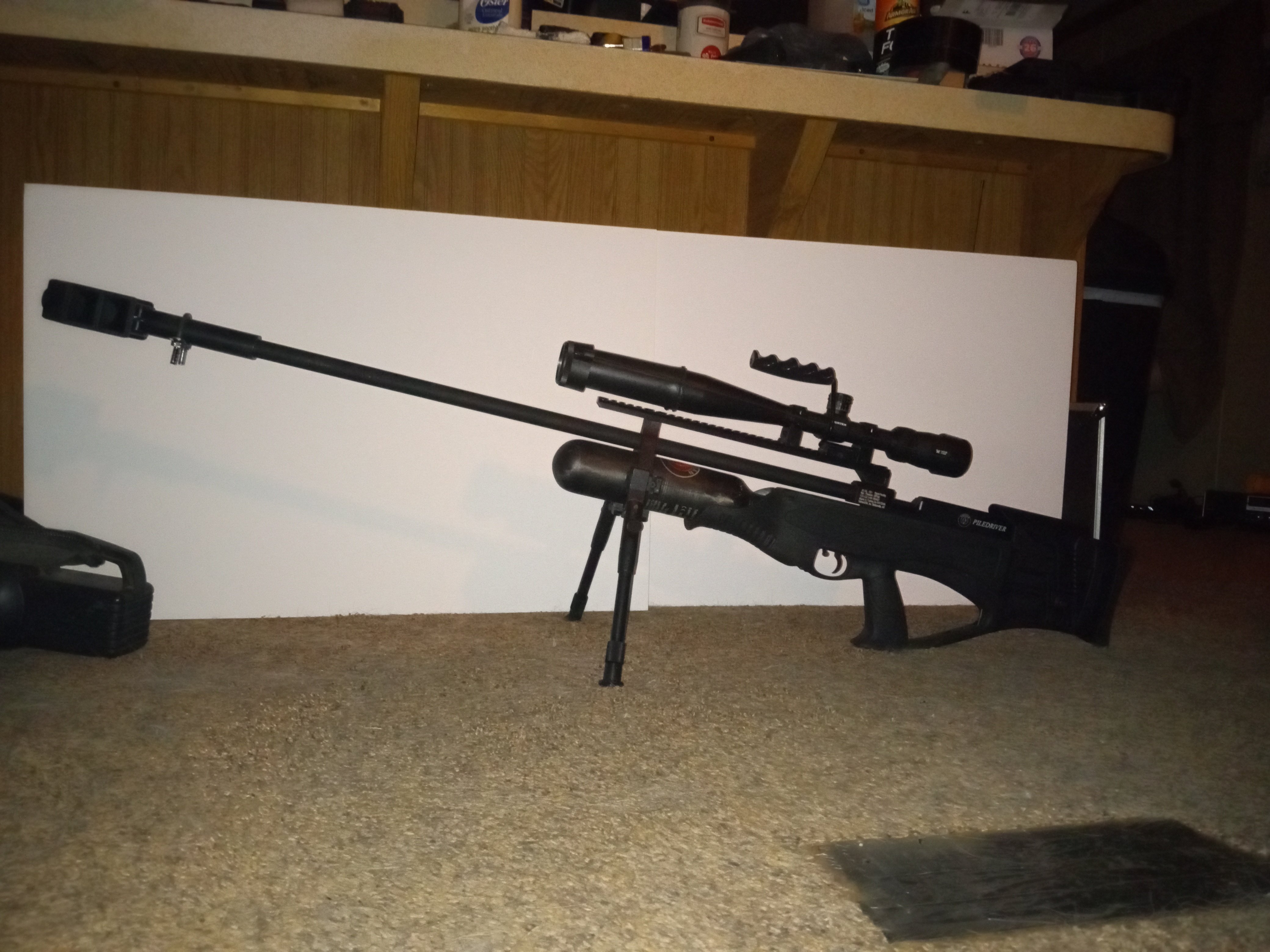

I just got my Piledriver in .457 and will be using the NSA 350gr slugs to try. I've read a lot about the Piledriver and sounds like it's performance is awesome. At some point I'd like to try 1000 yards
And this has what to do with H&N Boattail slugs?
