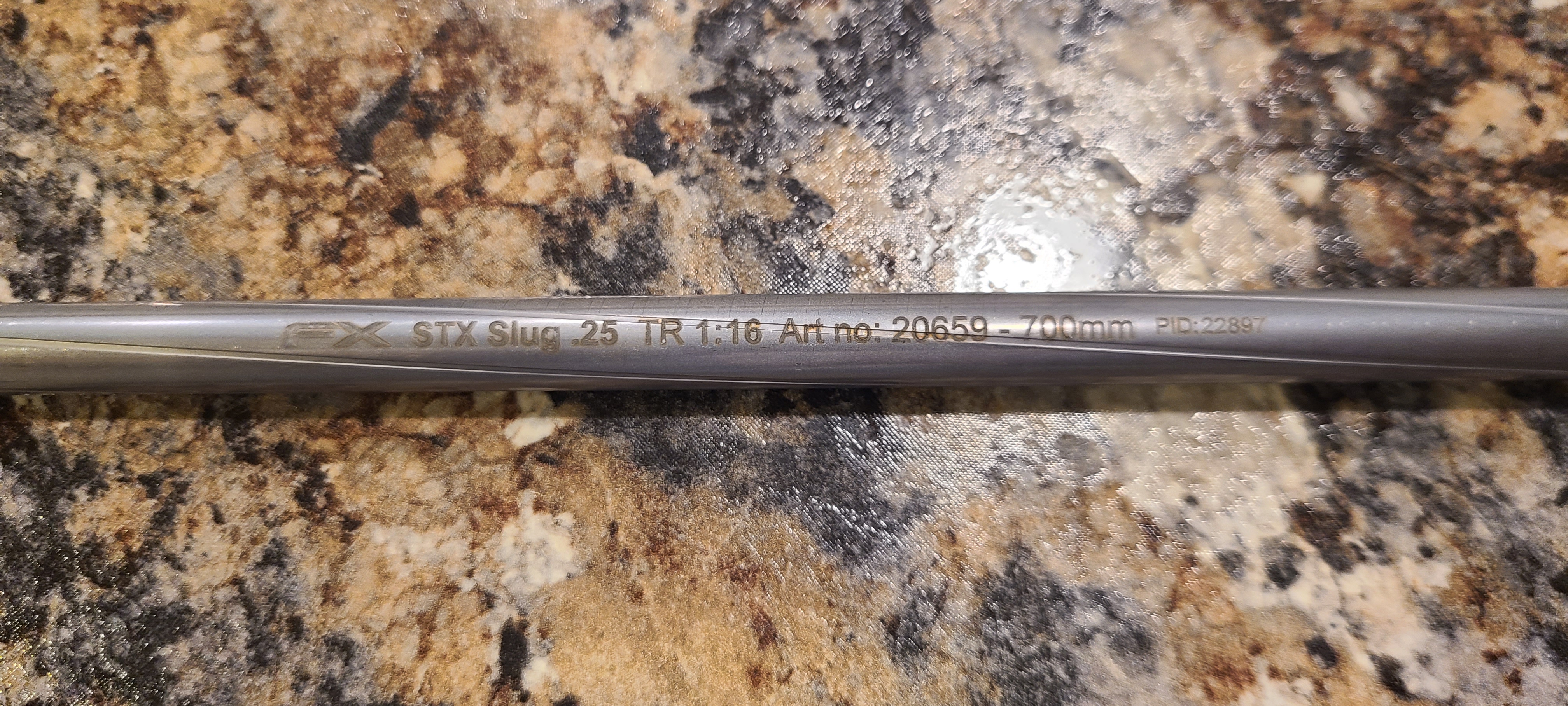

I have the STX Slug Liner 1:16 TRView attachment 459098

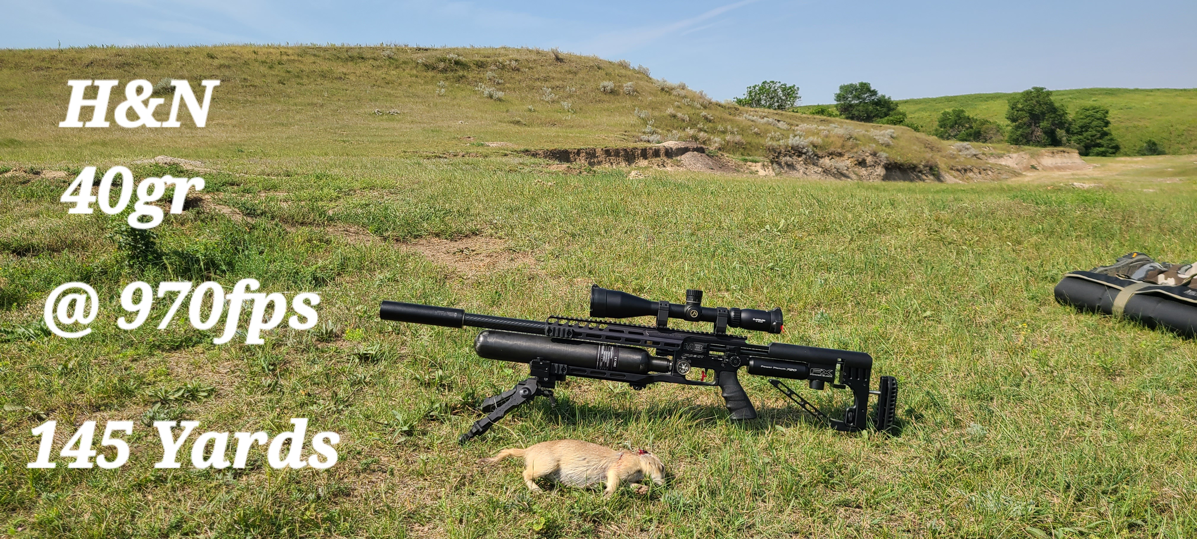

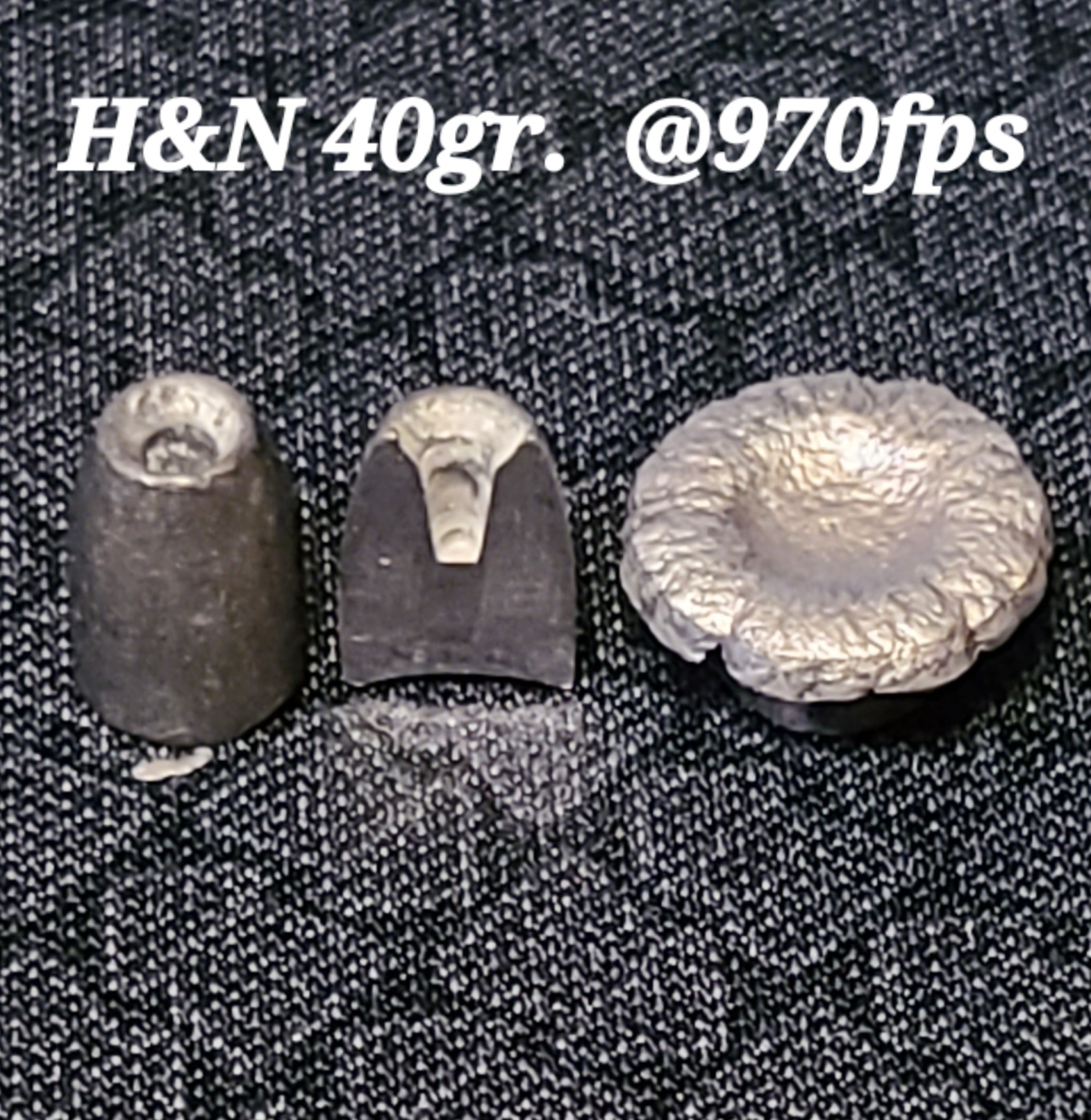

They are very accurate for me out to 200 yards plus they drop prairie dogs in there tracks !

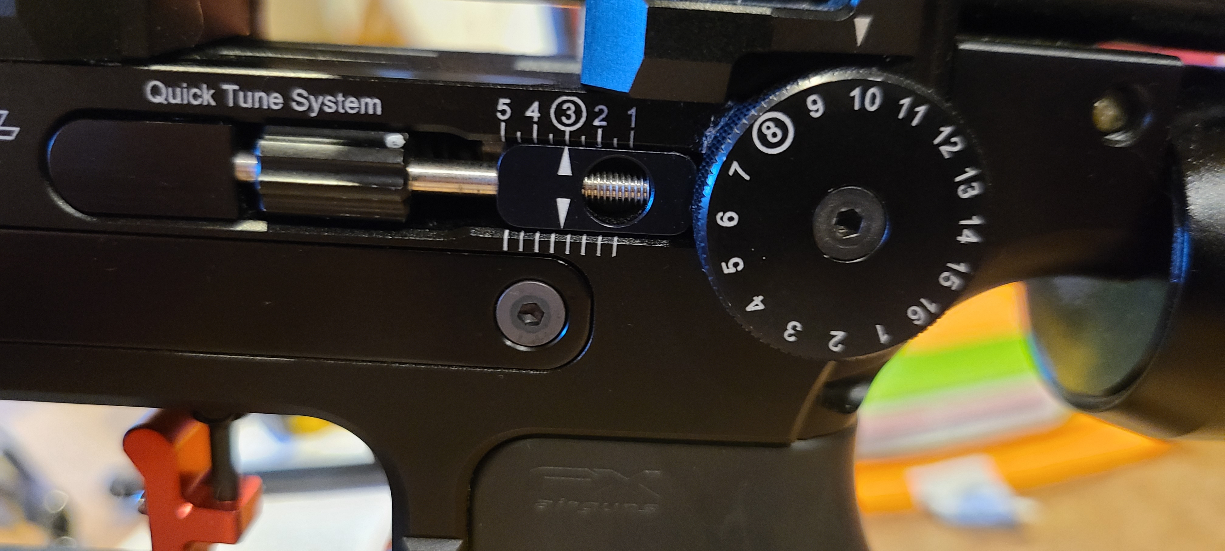

700mm, 1st reg 225 bar, 2nd reg 150 bar, valve adjuster about ½ turn in from 4th line, CTS 3 but I have the tungsten hammer weight, you might need more hammer tension if you don't have the extra hammer weight.What are your setting roughly and barrel length?
