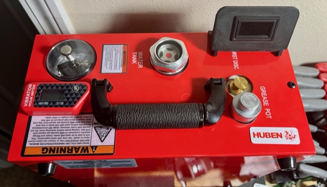

I have a CS-4 coming and I am wondering which wireless hour meter you guys have found that will pick up the low vibration of this compressor reliably? Also where have you found the best place to mount it?

This is the hour meter I use on my CS4 and it's working quite well!
I have it mounted just in front of the handle.
