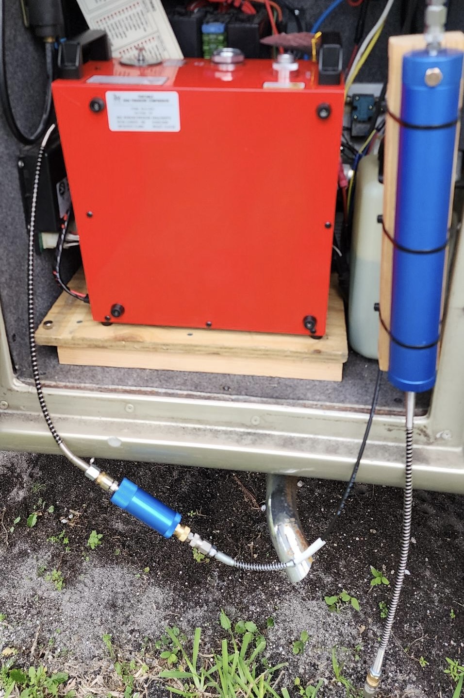

I’m buying one of these soon. It will def increase fill times. I’m just not convinced those small cotton filters are sufficient.
One like this in a compact size and add a whip .. like the review picture of it on a cs cx2 ..

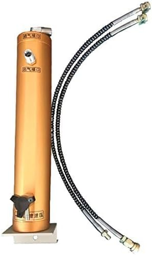

Well.. that one I just posted look small enough for that L3 you could make a holding bracket for it .. used deccant beads that are reusable after you dry them . I'd think you could plug it in on your units l fill line and add a whip to the other end to fill the gun and be set nice ?
The opinions and to use reviews are going to flop around cause where and how used like dry air Arizona filling tanks all day or a gun occasionally . Or hot humid Houston out doors or in side with a running ?
Hech get a basic cotton filter one and a decent one thats compact and affordable and try each ..

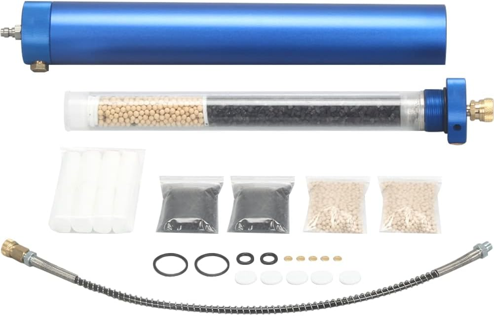

For longer fills, I bought this:
However, I wish I had seen this before I bought that:
Are you going to use just that filter? I did see a YouTube video on it, looks promising but again others say the opposite, they recommend 2
There is no need for two unless you are pumping a LOT of air at a time. I have topped off my 9L bottle from 240-310 bar, took about an hour, and I had a little sheen of water on the outside of the plastic molecular sieve inside after the job was done. Just wiped it off and left it open to dry for an hour.
I see zero water after filling a gun.
I have one of the little ones before the big one, and I use that to judge the water amount after pumping. It's ALWAYS dry after going from 150-250 bar. If I knew then what I know now, I wouldn't have wasted time on the little guy.

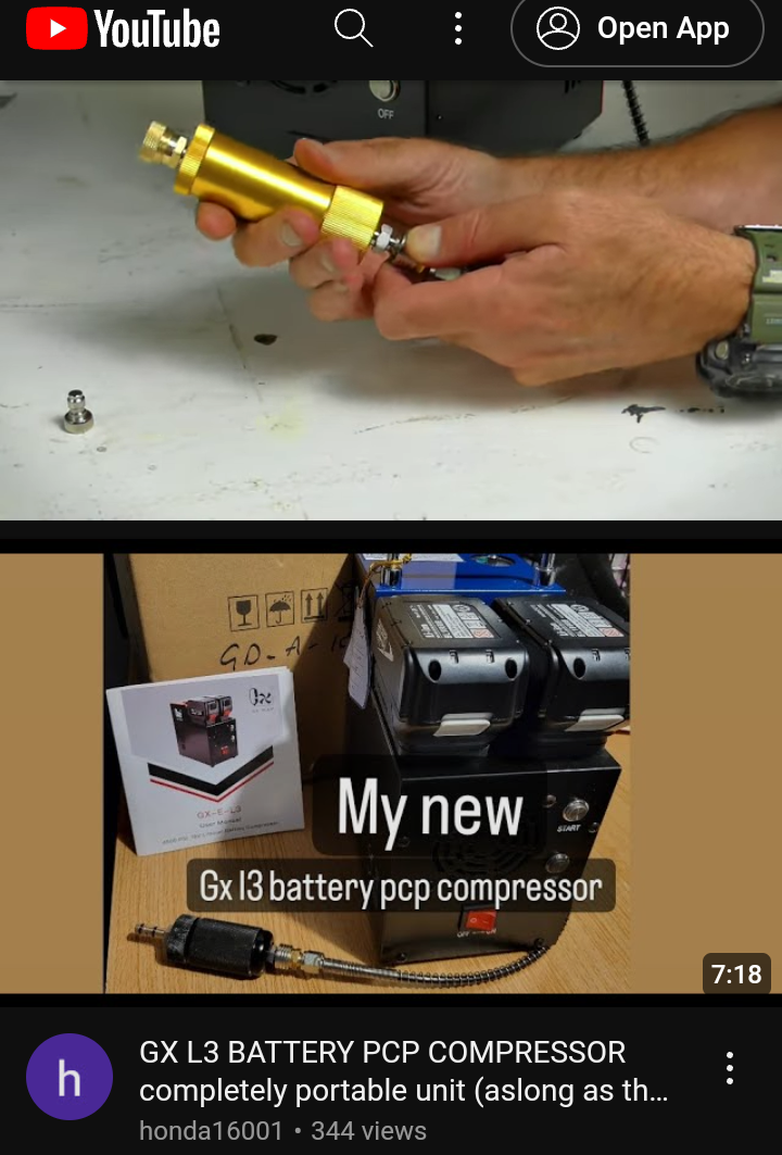

Happened to watch a Target Forge YouTube recently regarding GX series and filtration. Using F6Hawk's photos in Post #11, presenter stated the orange (water coalescing) didn't work for GXCS1 and GXCS2 due to low air movement, recommended blue filter (molecular sieve) for them. Further stated GXCS3 series added an internal water coalescing system to address this shortcoming, which yours appears to have. Think you're good to go just adding a molecular sieve. Not sure anyone feels the cotton-filled filters are sufficient alone. WM
