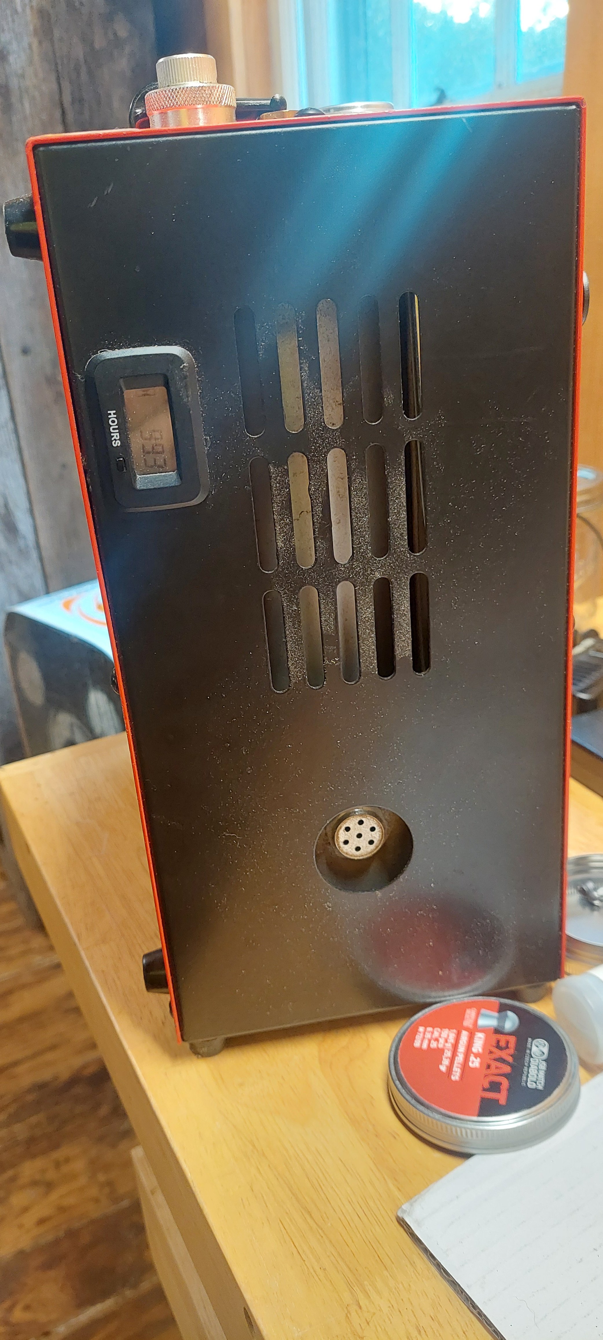

I recently purchased an E5K1, which as far as I can tell has the same type water-cooled system as the K2 model. I used the compressor only to fill up my airguns (Umarex .30 Gauntlet and .50 Hammer) never used it to fill tanks. Unit setup was easy, and I thought I'd finally got a compressor that would last. I was impressed with the quick fill times, cool and quiet operation. That lasted a grand total of ONE hour operating time, according to the on-board hour-meter. The water pump stopped working, or would turn off after a few seconds. I could tell water was only circulating intermittently by watching the spinning/stopping of the flow indicator on the side of the compressor.

The most likely (but not guaranteed) cause of intermittent operation is loose connections.

@LW737, did you already clear out air bubbles? Turn on the fan and water pump, then gently lift the rear up to about 30 degrees. Then put it down and do the same with the front. Then check the fluid window again. It's helpful to do this with the cover removed, as you can see bubbles and fluid moving through the tubes.
I thought my water pump was broken until I remembered to do this during initial setup. That "fixed" it for me.

Most all the setup videos I've seen have said to do this.
Contact GX. I currently have 12 hours on my 5K1, so that's 36 top offs on a 97 cf bottle. No issues so far. Also have a CS4 with 50 hours on the clock. These things do get banged around pretty good during transit, so something is probably lose.
Thanks. I checked all connections/wiring, and found nothing wrong. I'm just planning on getting a refund and probably going to try my luck with a Hill compressor.
