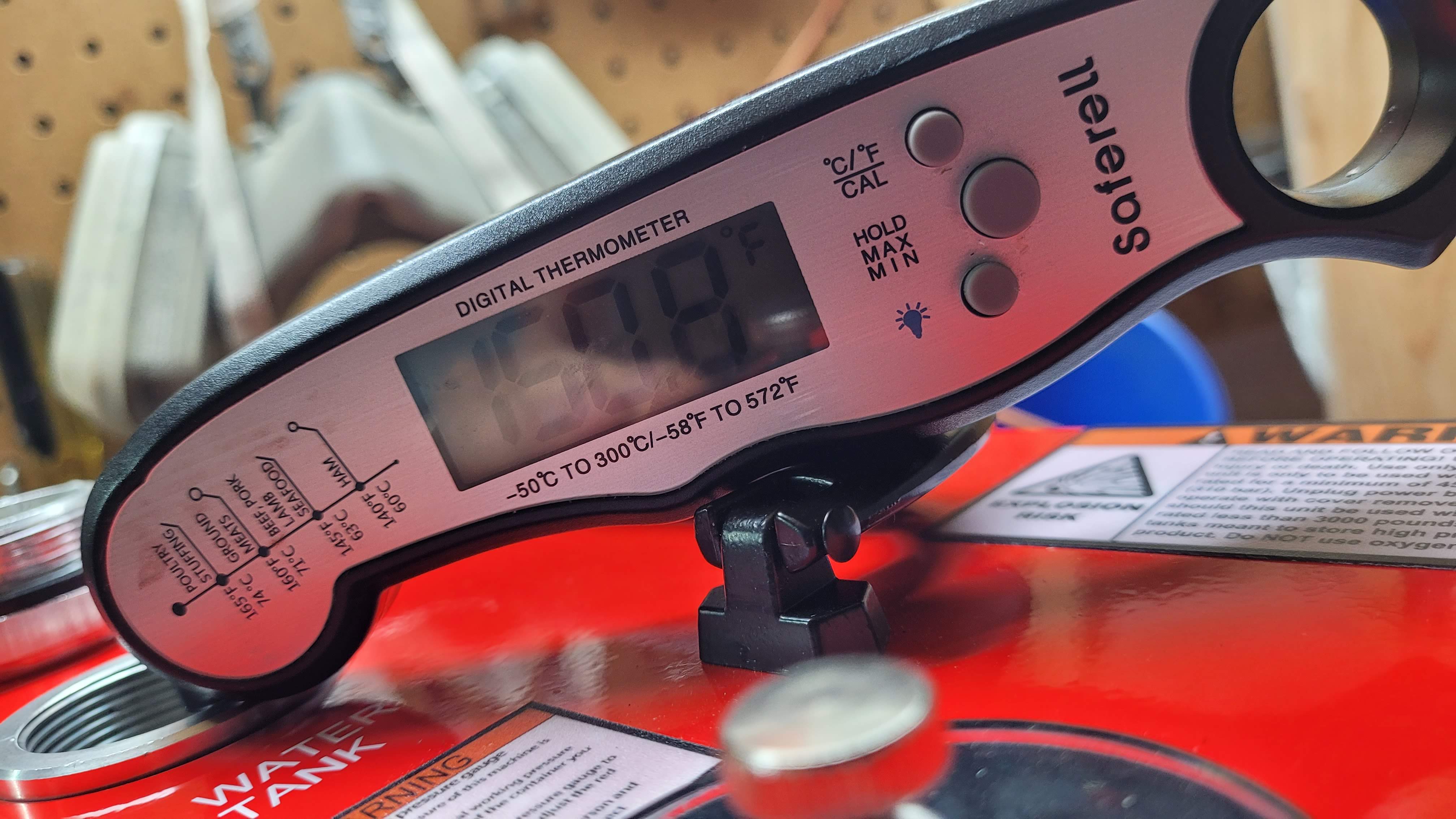

Garage is around 75 deg F. I'm measuring the water in the reservoir with an instant read thermometer. I tried another thermometer as well with the same result.
I just disconnected the sensor. Running it now to see what happens.

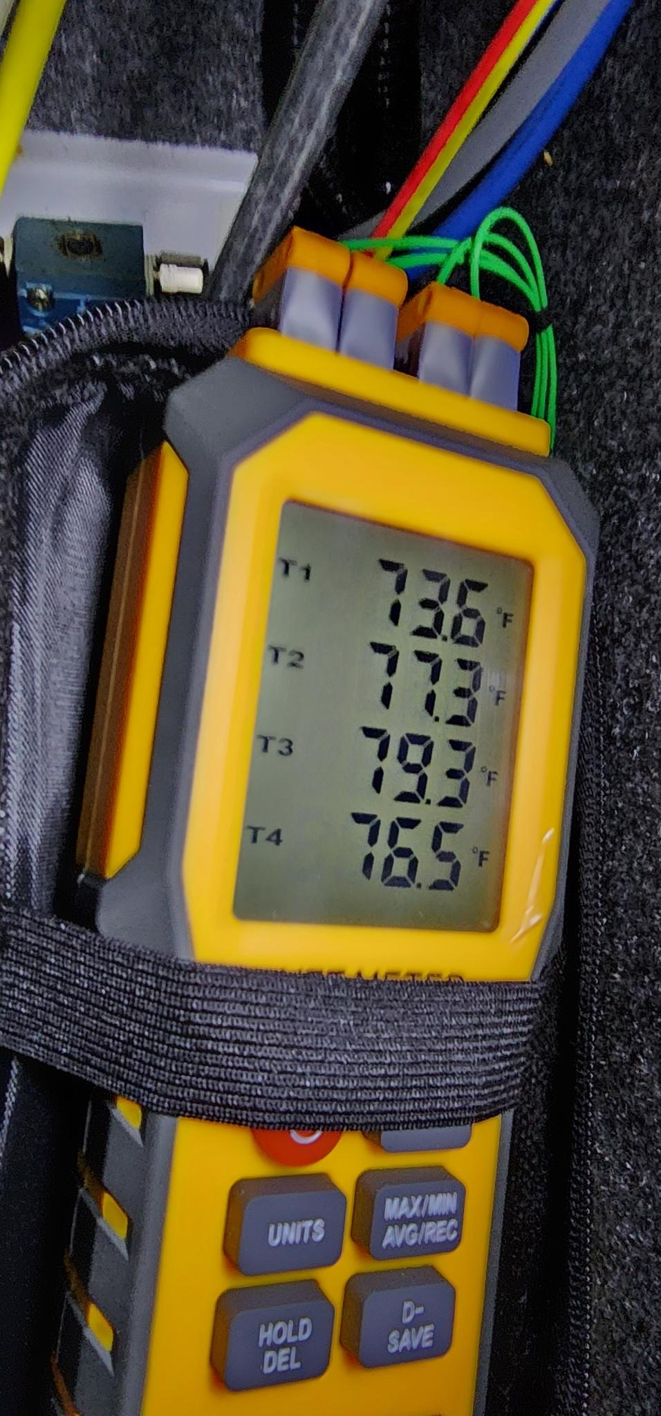

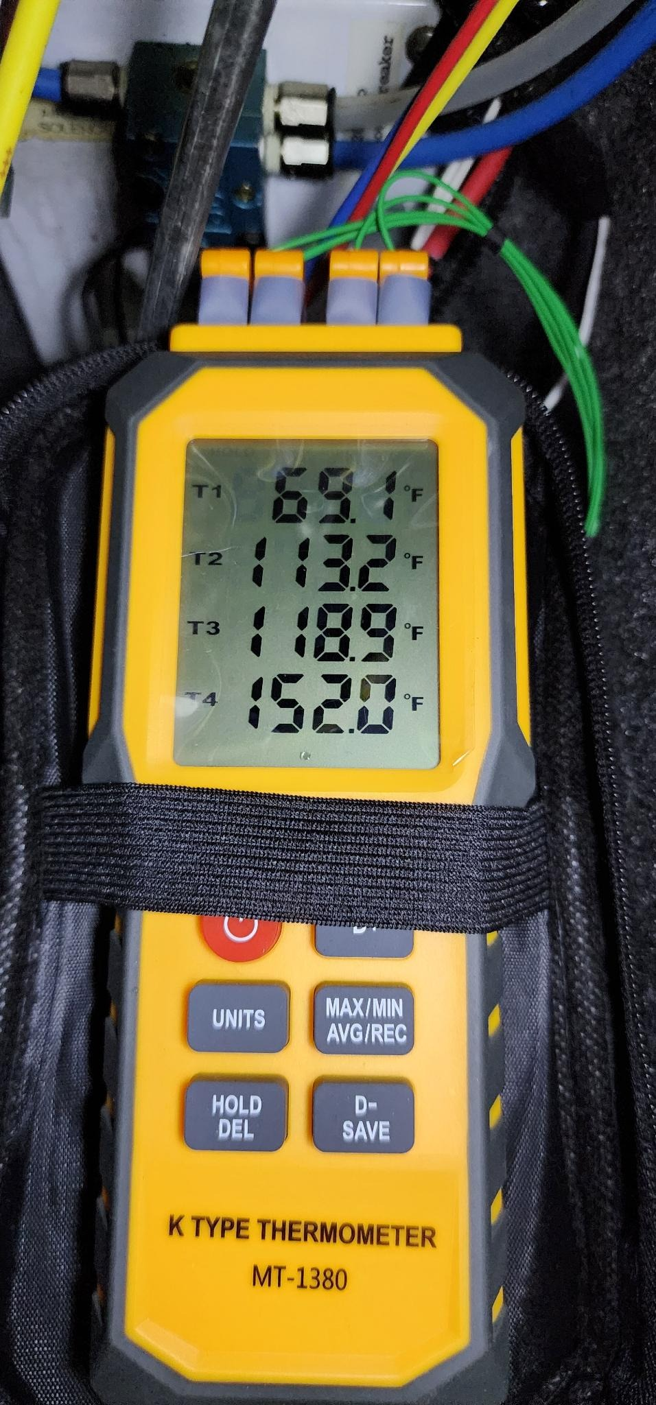

Yeah, that is definitely too hot. My motor got up to 152°, but my coolant topped out around 113.2° after a 57 minute run. (Temps are Ambient, Coolant, Head, and Motor from top to bottom).
Start:
Finish:
