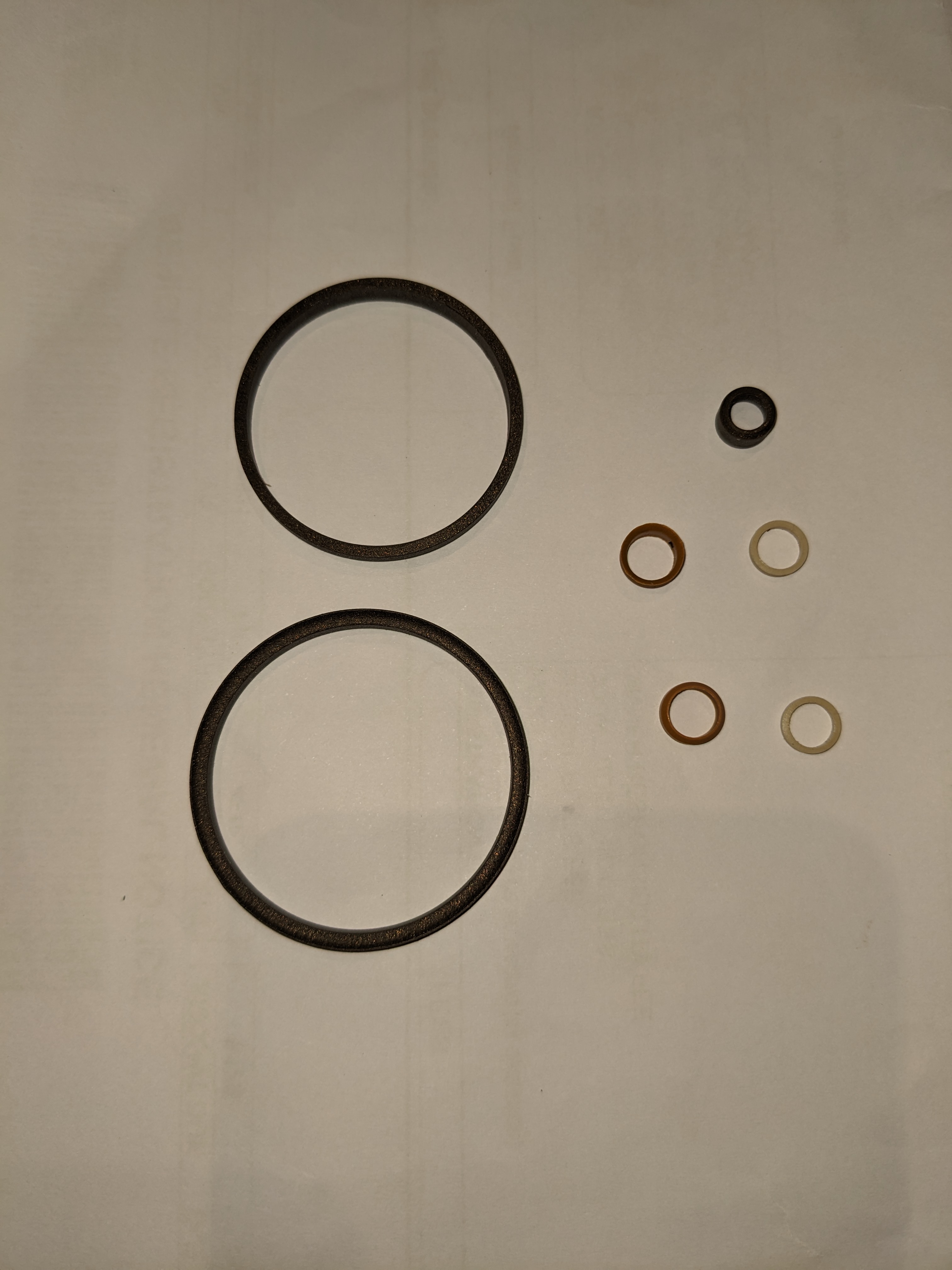

One more thing to consider, the "piston rings" for both the large low pressure and small high pressure piston are not o-rings. They are a hard plastic(polymer?) type of material. More like a automotive piston ring but made of plastic. Going from memory here but I have a rebuild kit for the CS4. I will try to find it, maybe get a pic ***EDIT: it may be the GX E-L2 I am thinking of. I have both the CS4 and EL2 and rebuild kits for both. I think I may be confusing the two.
Reactions: F6Hawk
Here is a photo of the sealing rings that are not made of rubbery like materials. So I think it's best to use a similar lubricant to what the factory uses and not silicone.
So are the 2 large "seals", a plastic of some sort?
Are the 2 large seals, identical, and of the same size?
Does 1 piston, require 2 seals?

I don't have said kit in hand, so cannot speak as to the material, but they are identical and there is one seal at the top and one at the bottom of the outer piston.

The 2 large seals are different sizes. The smaller one just fits into the ID of the bigger one.
Thank you.
They indeed look different dimensions, and thats why I asked!
This contradicts what F6Hawk has reported, and he actually had a compressor unit somewhat disassembled, and apart., although I dont believe he removed his functional piston from his cylinder, for obvious reasons.
He also reported his as being rubber o-rings, and yours seems to be a nylon or plastic material of some sort.
Im more confused than ever, and I suppose that seal material and fitment dosent really even matter, until it matters, and that could be years down the road!
Im also assuming that GX included your seal kit , along with your compressor purchase.
If so, its great that they do this, and I suppose in the near future, that a schematic or parts diagram will surface online.

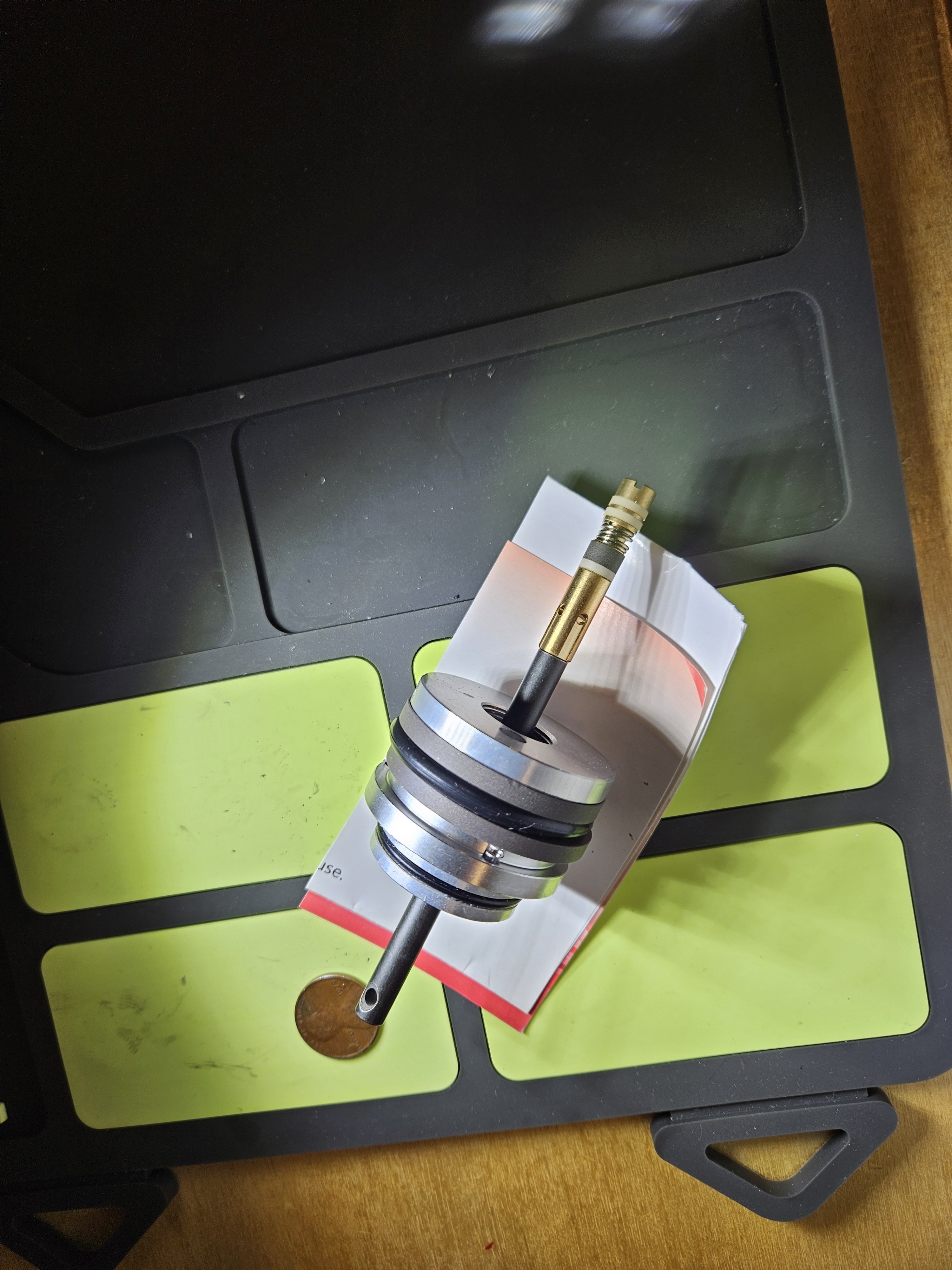

Well no, F6Hawk is still correct. There are both polymer rings and rubber o-rings. It is a combination. This pic shows the "crank-to-piston shaft" relationship
