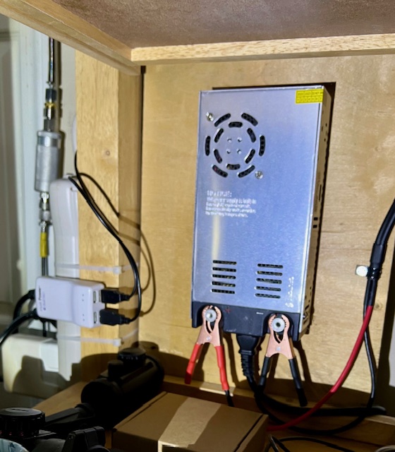

Wow, that is a good price! Of course, once you put that PS inside the case, you are introducing another source of heat! I kind of like the separate PS mounted under my workbench, out of sight, out of harm's way, and not introducing any more heat inside the compressor!
Paul
