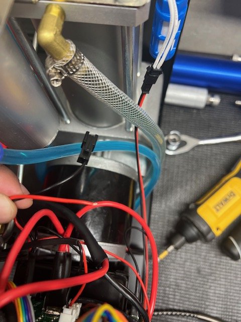

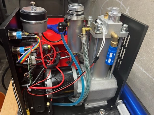

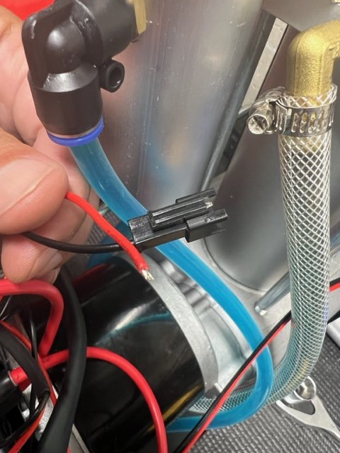

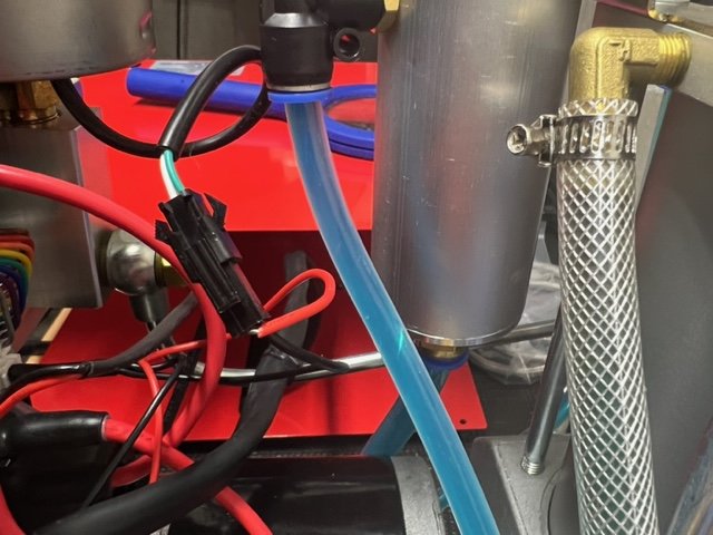

Thanks for the help- I will take some ownership in that I did not want to take the cover off and go "through" the pump. With that said here is where I am at. The leak was stopped by tightening the brass bolt that my finger is on. Next, I went through the control board and connectors. Another problem was found. The wire came off the switch for the auto-shut control. I stripped a bit of wire and crimped it in the switch and the pump works. Tested pressure with just the line at several bar settings and shut off works perfectly. I know this was not that big of a deal but again, it's a brand-new pump. What would you guys do?

Good work on the tinker/fix.
What to do, now???
Pump air and shoot your gun. Be happy. Life is too short to be bitter. Glad to know you were able to knock out the little gremlins.
You will be happier now that you have seen the insides of the pump. Take the mystery out of the magic box. Be confident.

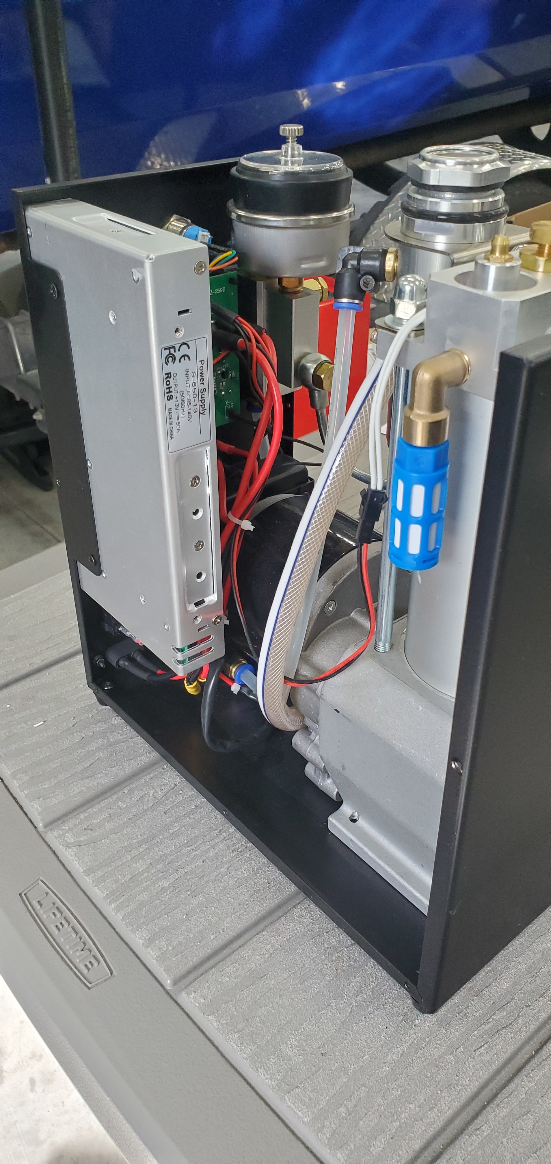

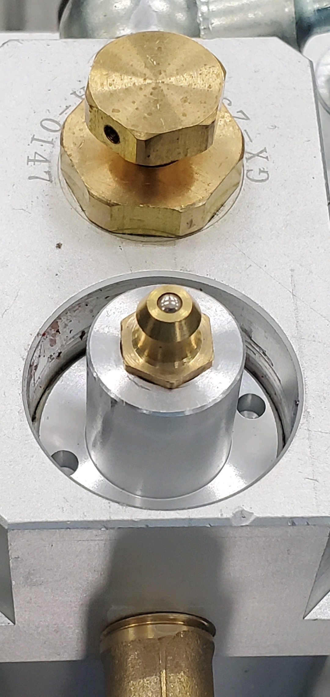

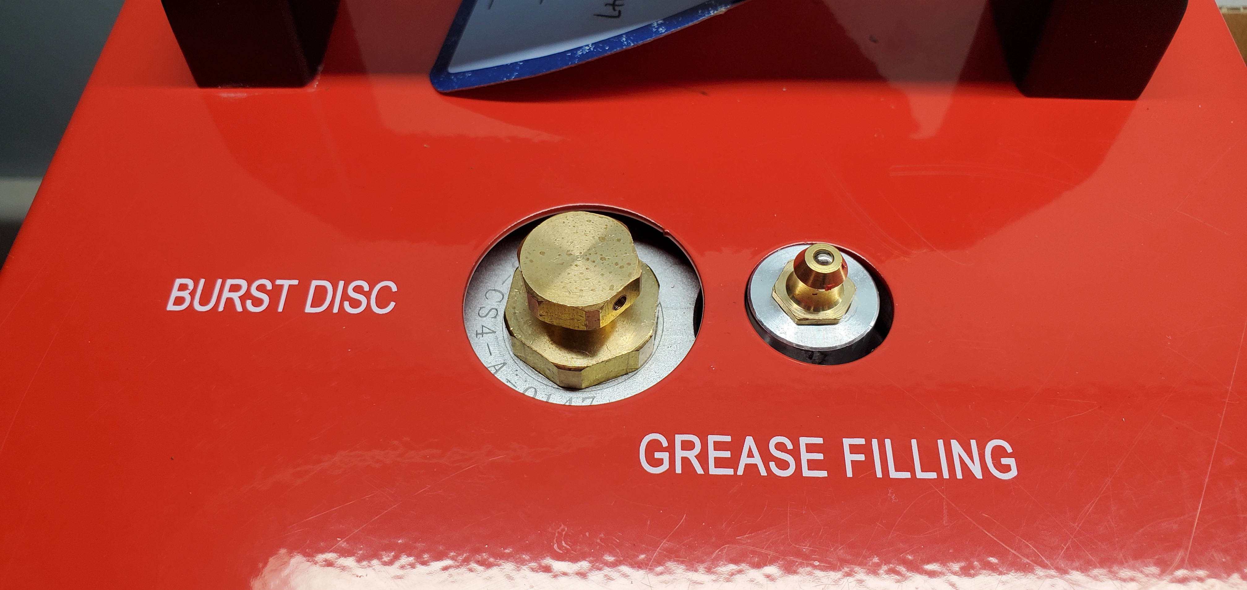

I got mine yesterday. I ordered it off Aliexpress so I could get the CS4-I integrated power supply version. The US based GX supplier said they had no plans to carry this model per email to them. I paid a bit more going thru Aliexpress, but I probably won't miss having to deal with the external supply. GX must have taken flack for the grease pot and switched over to a standard zerk for this -I version. This unit pumps up faster and much quieter than my buddies Smaco. The cooling system is impressive and the unit looks easy to service. They included the tools and service parts but no external filter nor additional grease.

Pic attached. The manual is a bit cryptic. Does say 0.5ml every 4-6hrs. Doesn't say what to use.
The seller texted me an hour before it arrived yesterday and mentioned that I need to select the proper input AC voltage and asked if had any questions. 1) I asked if they planned to market this model in the US. "Yes not yet. But will come soon." And 2) what grease to use. She said "Any high temperature resistance grease will be okay". So I wasn't confident with that reply. Lol. I'm gonna pull the zerk and see what/how much might be in there now.
