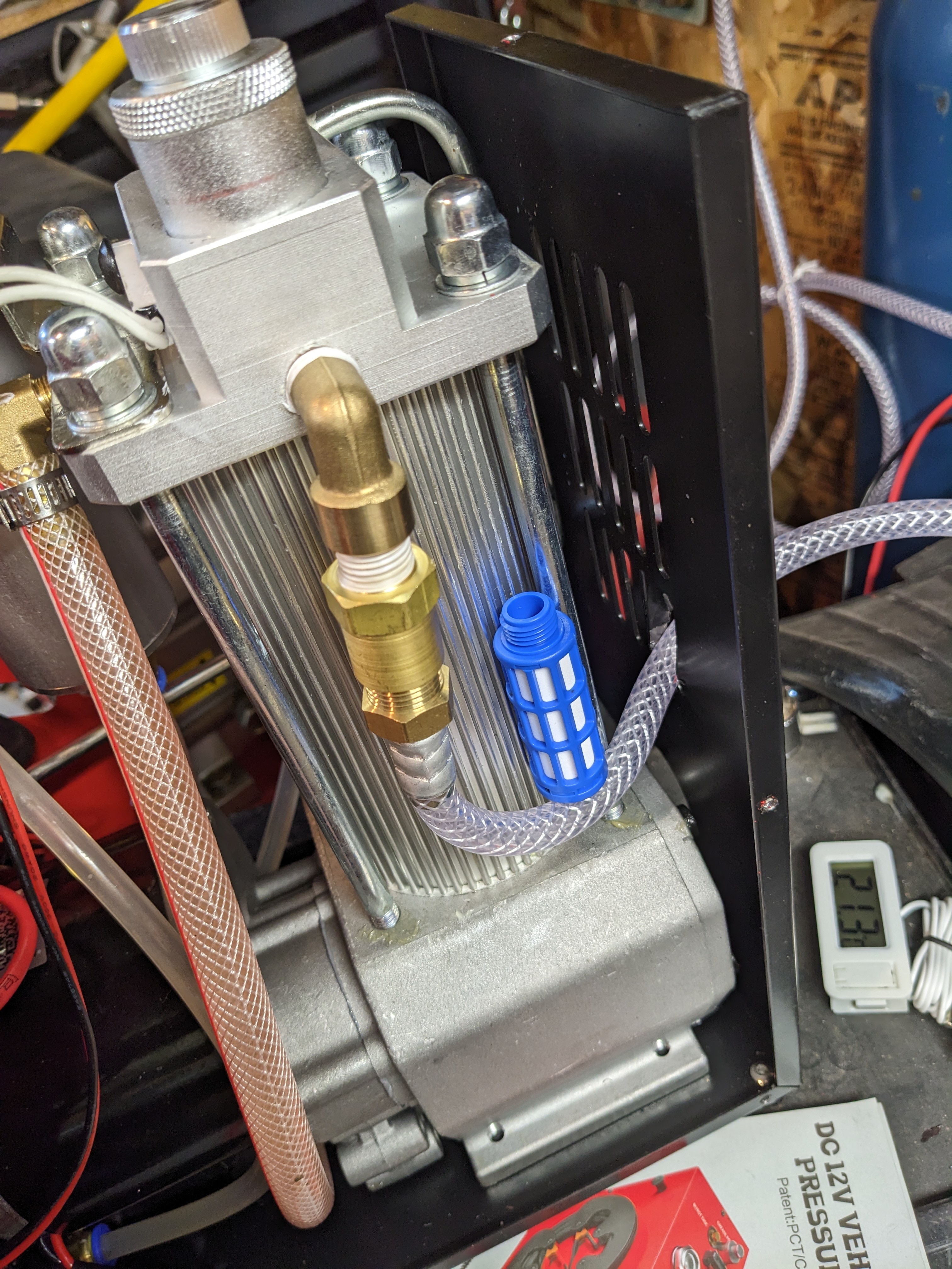

That isn't the pot. The pot is the part you removed. It has a piston that extrudes grease into the area pictured.
True, check inside the part you removed and see if there is grease in it. If not, I was told to use Food Grade E.P. Grease. If there is no grease in the part you removed, I would definately contact GX Pumps, either direct through their website or through FB. Personally, I've gotten better responses through FB.

OK!, got mine off the porch and find there was NO Grease in the pot...... You guy's better check the system, got an email to the shipper to find out what the hell is going on ,But wtf, I was expecting better........................ ankul is the supplier/shipper.
see the Black diaphragm, for a off the head description.
Here is what mine looks like. It looks like yours @FLgunner , and the cap is full of grease, so maybe yours is, too ? I guess it's both a question and a statement because it appears to be correct, but as what to do or just leave it as it is in the cap is the question.
