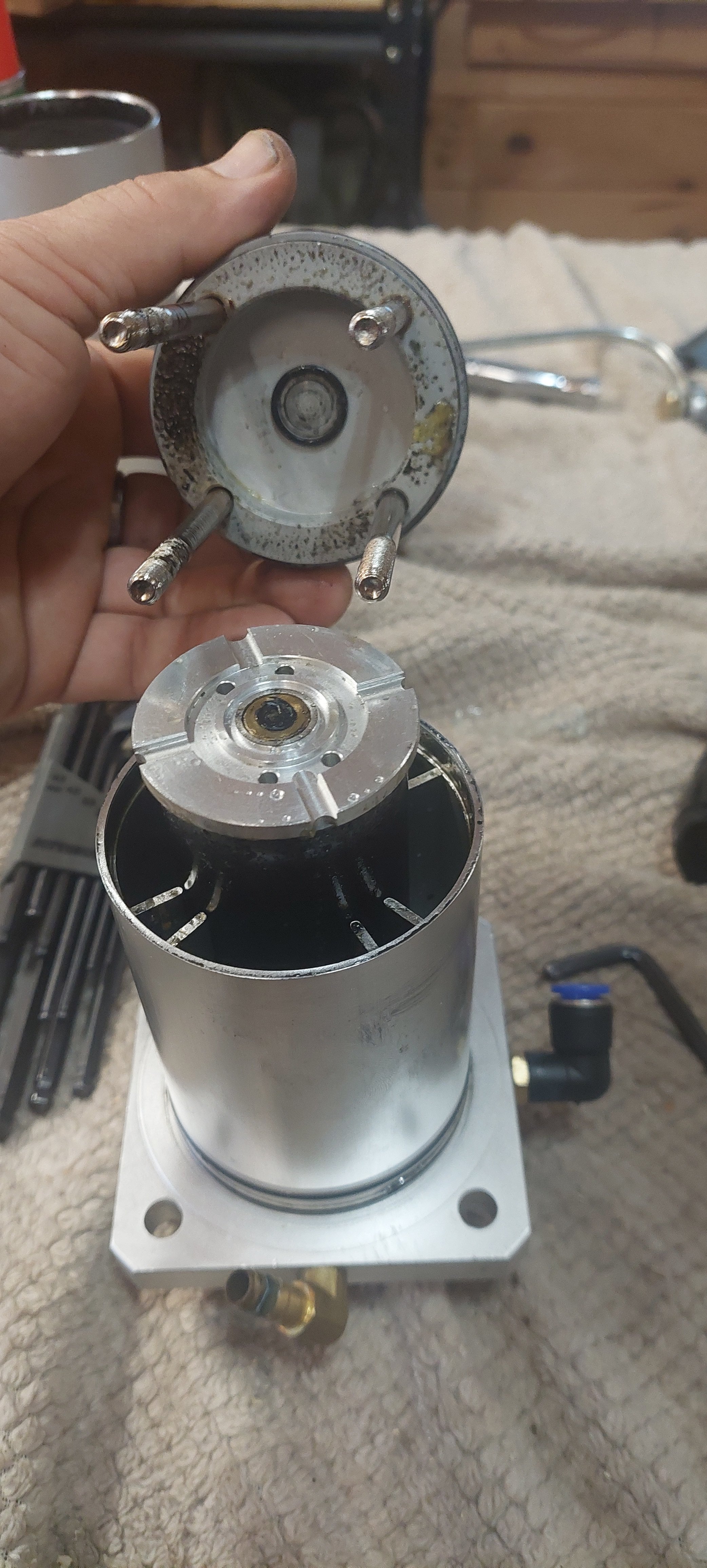

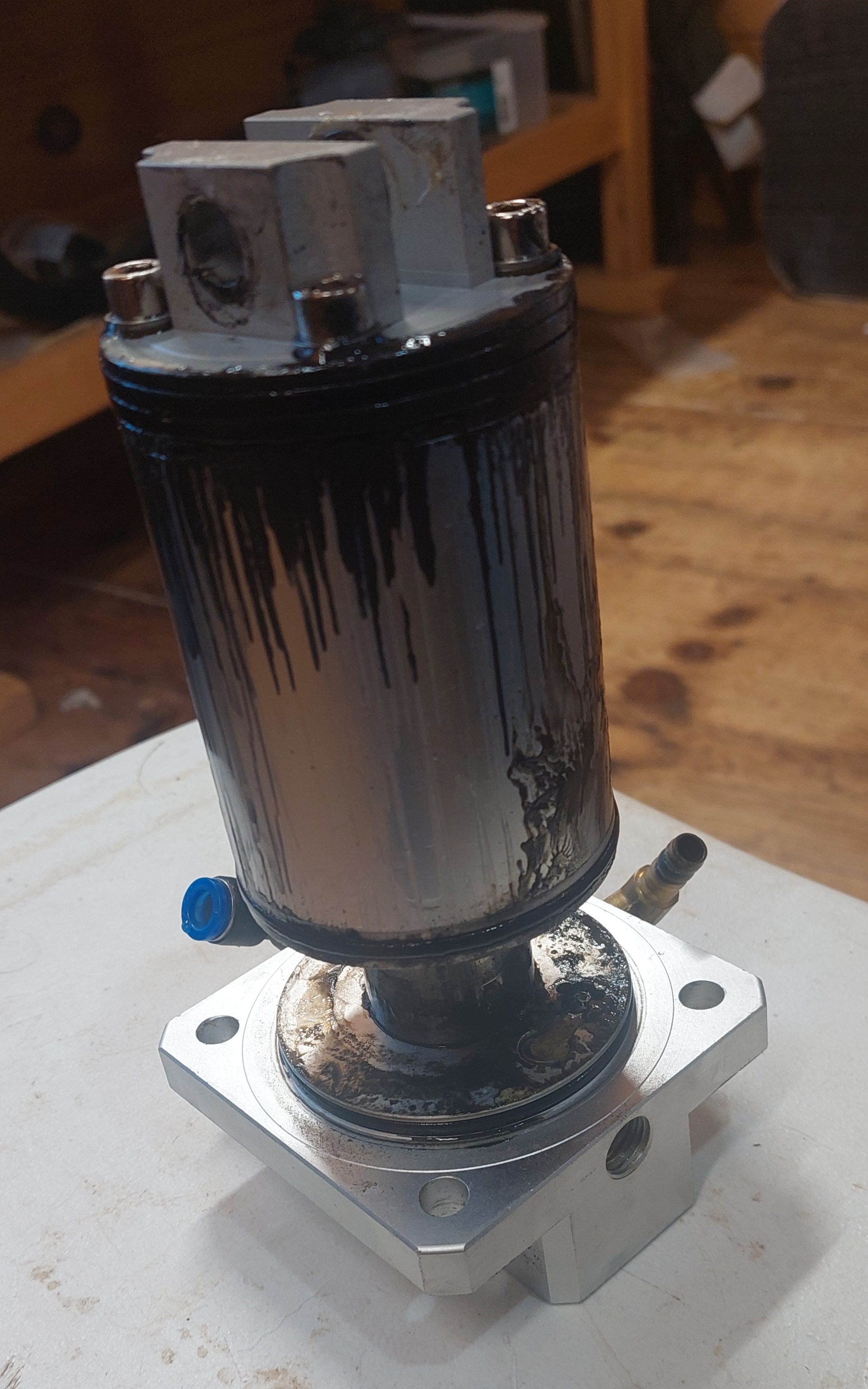

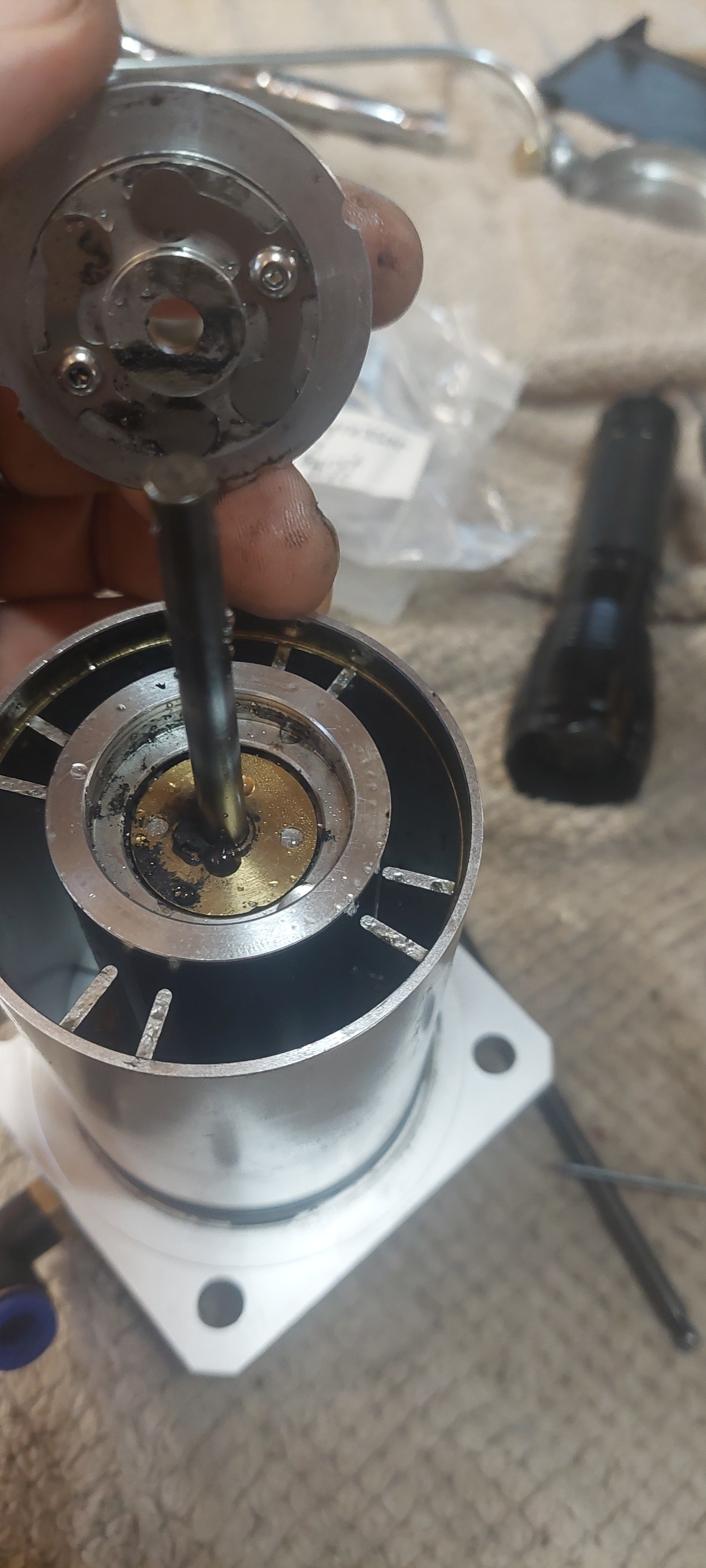

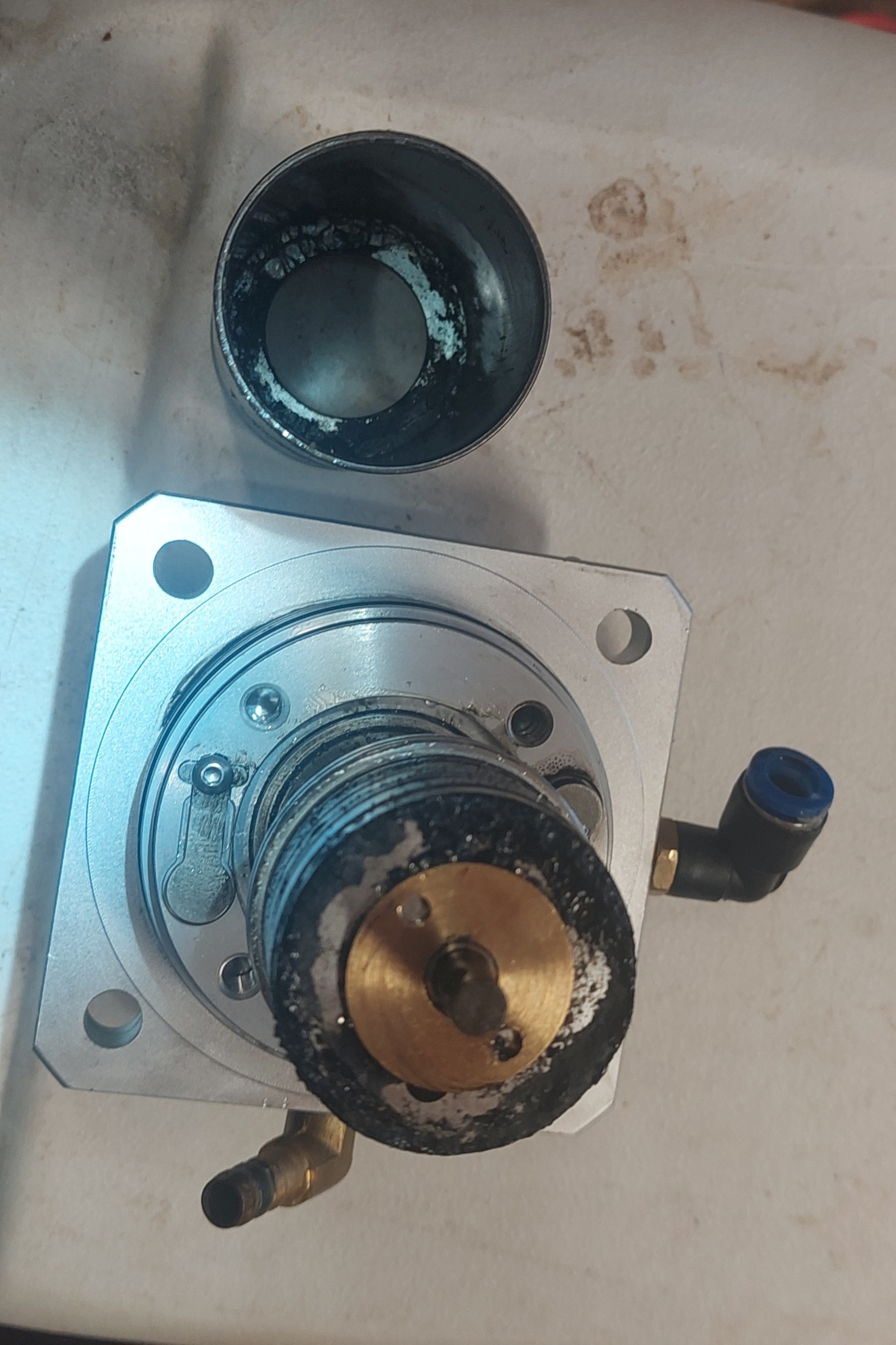

As can be seen every bit of the grease was black. I concluded that the coloration is probably just minuit o-ring wear particulars since none of the grease had any hint of unusual/burnt smell. Rub an o-ring with some sand paper, even 2000 grit, and it's like graphite powder turning everything black. And even a little would a long way when mixed with clear grease. (Correct me if I'm wrong.)

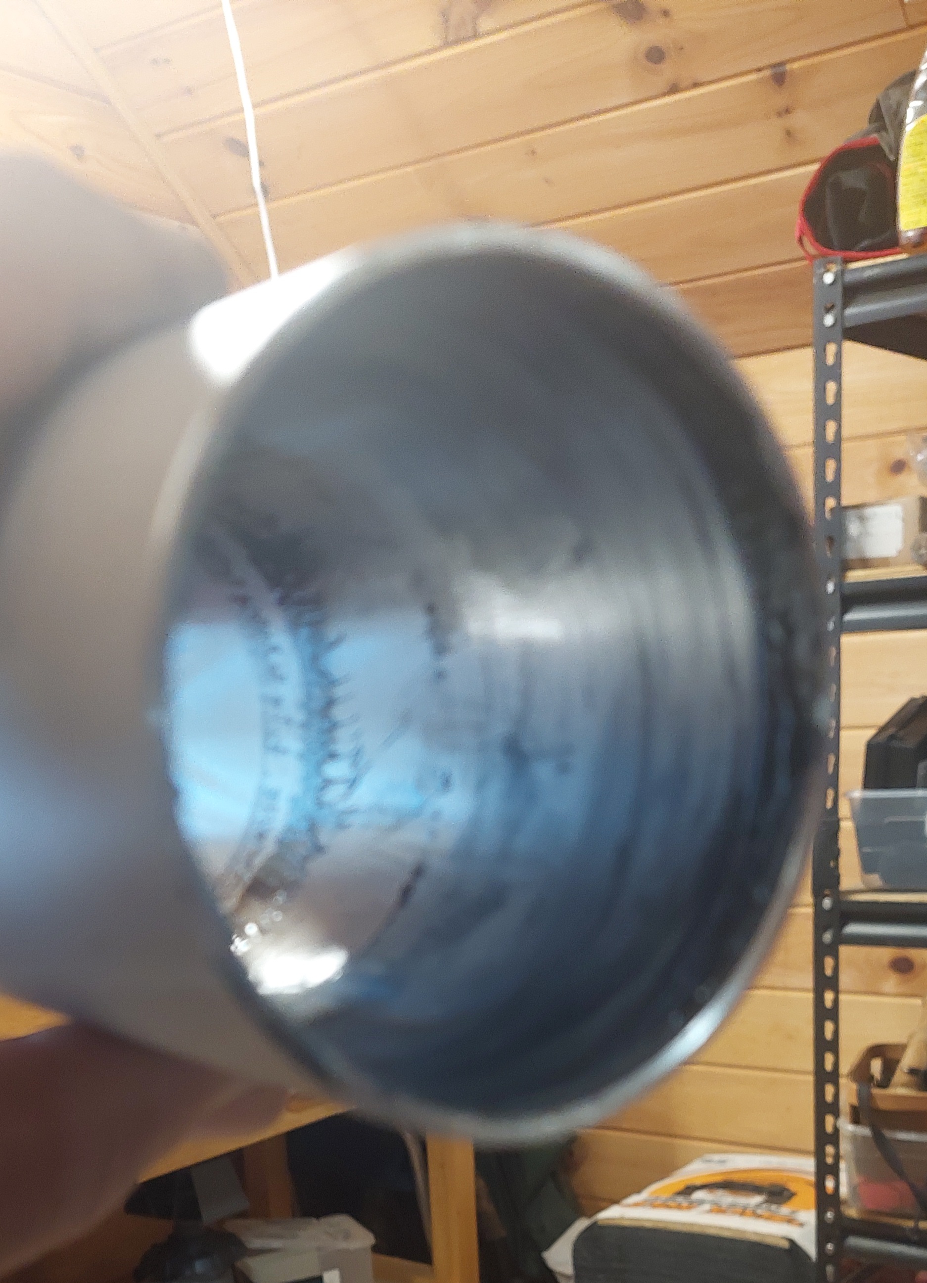

Wasn't surprised to find water in the piston since I'm in a high humidity environment and always blowing water out the bleeder.

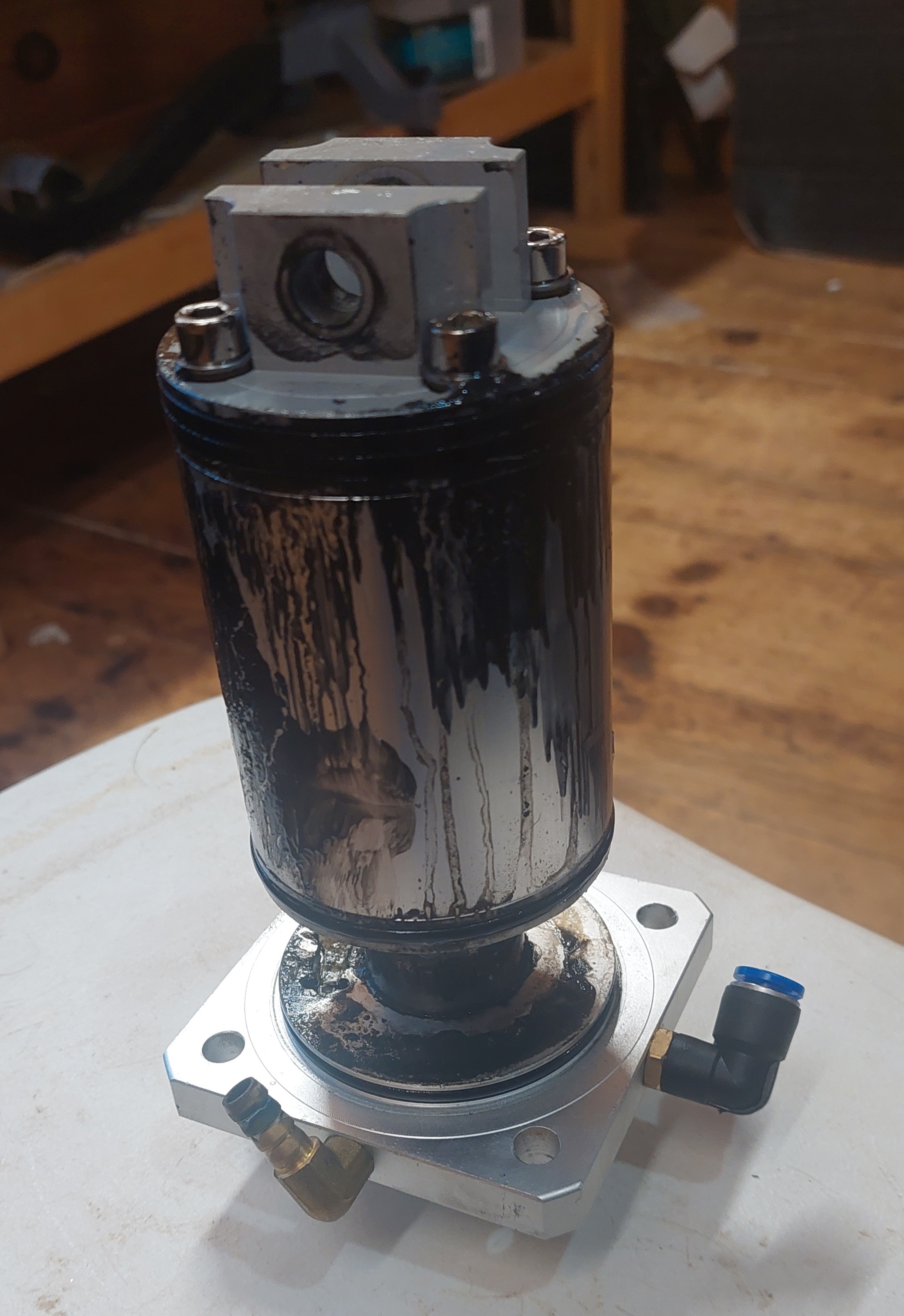

My apologies for not taking pics of second stage cylinder o-ring arrangement. Thought I did. It was pretty gunky though as can be seen by the base and inner cylinder.

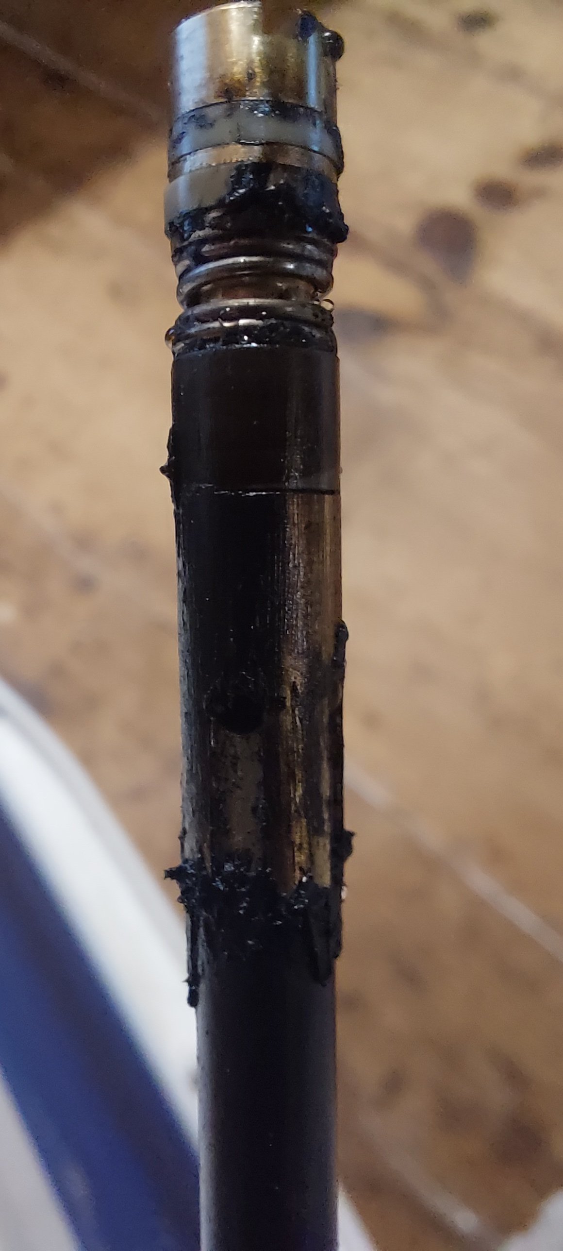

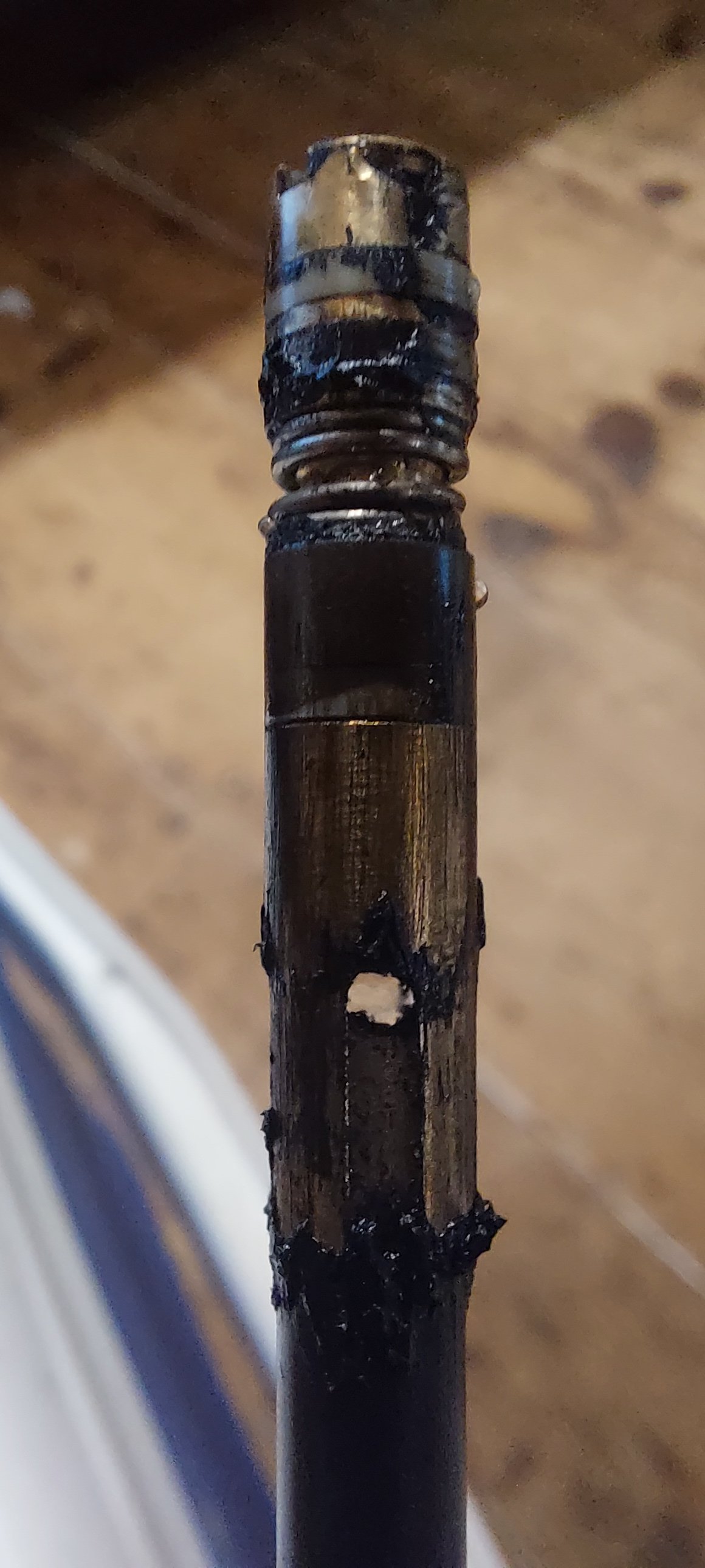

The final stage piston rod looked awful as you can seen. I'm now leaning towards believing that I've possible over greased at some point. However there's nothing that I've found anywhere to give it any sort of comparison with after long term use.

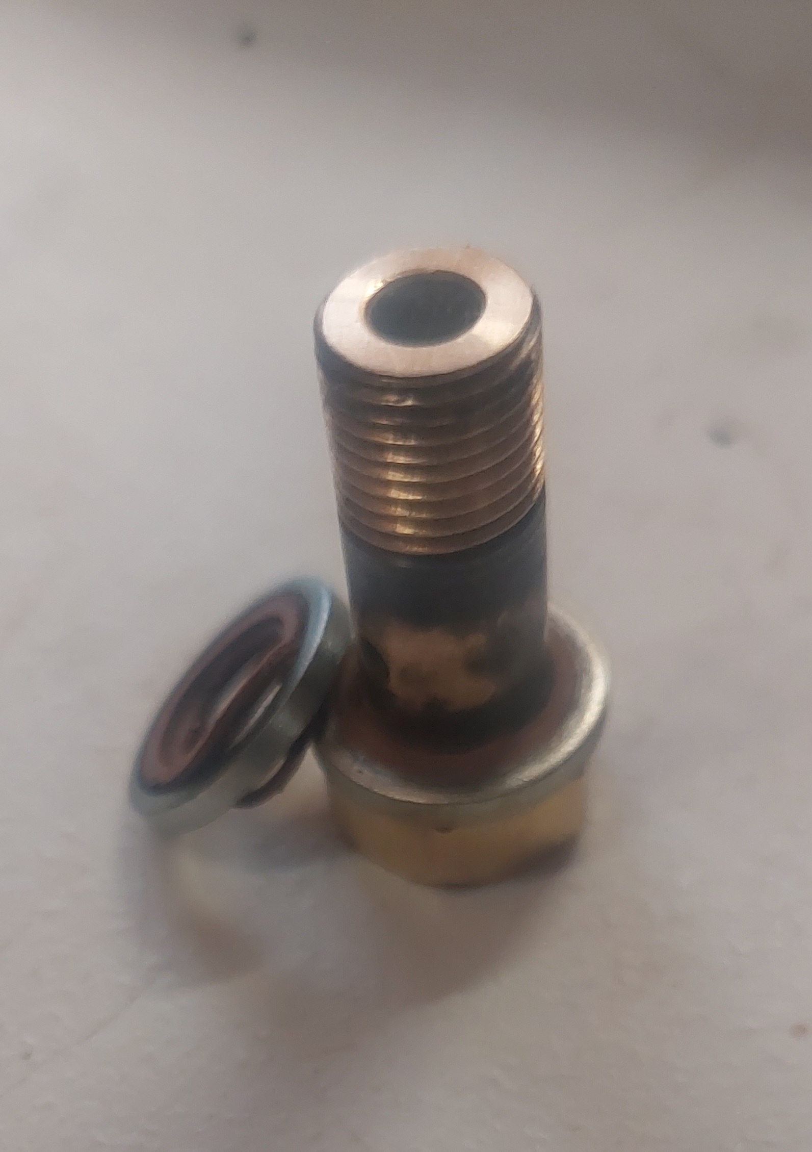

Also not included are the bonded sealing washer (Dowty Seals) for the pressure lines. One of mine blew when pressure testing after reassembly. I've ordered some that hopefully should work. Mean while I did a temporary make work thing I wouldn't recommend, so not describing.

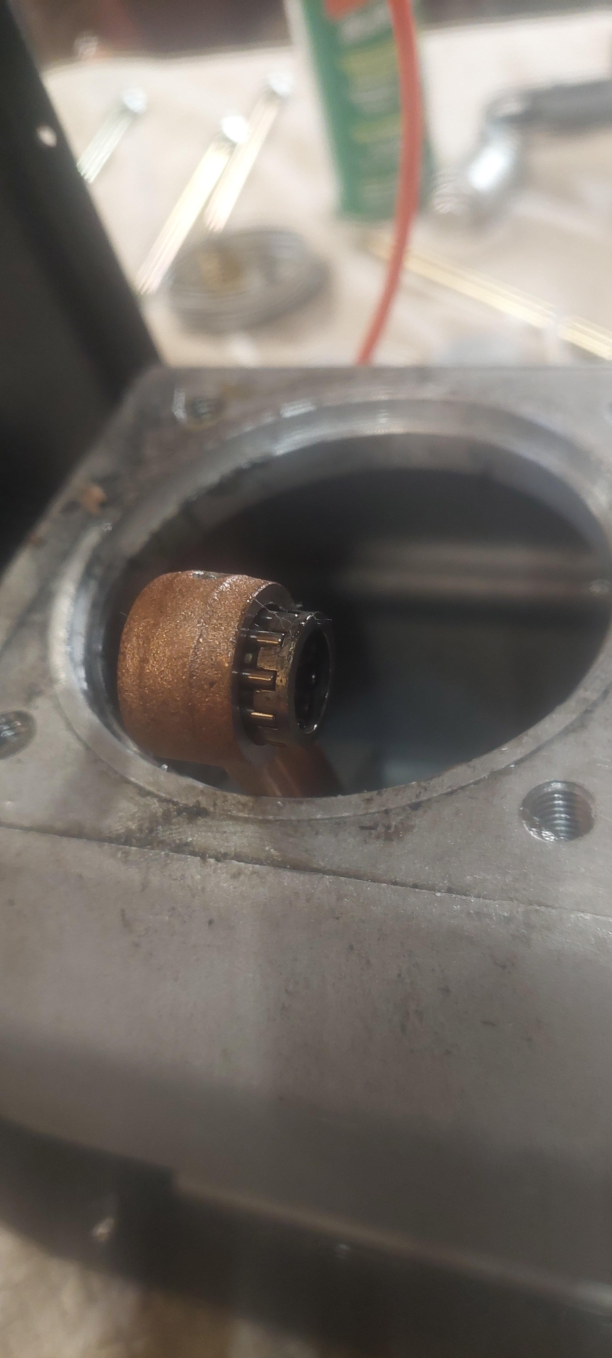

Also the connecting rod has uncaged roller bearings, slip those all the way out and you'll have a very unpleasant day. It does appear that they've stayed lubricated though.

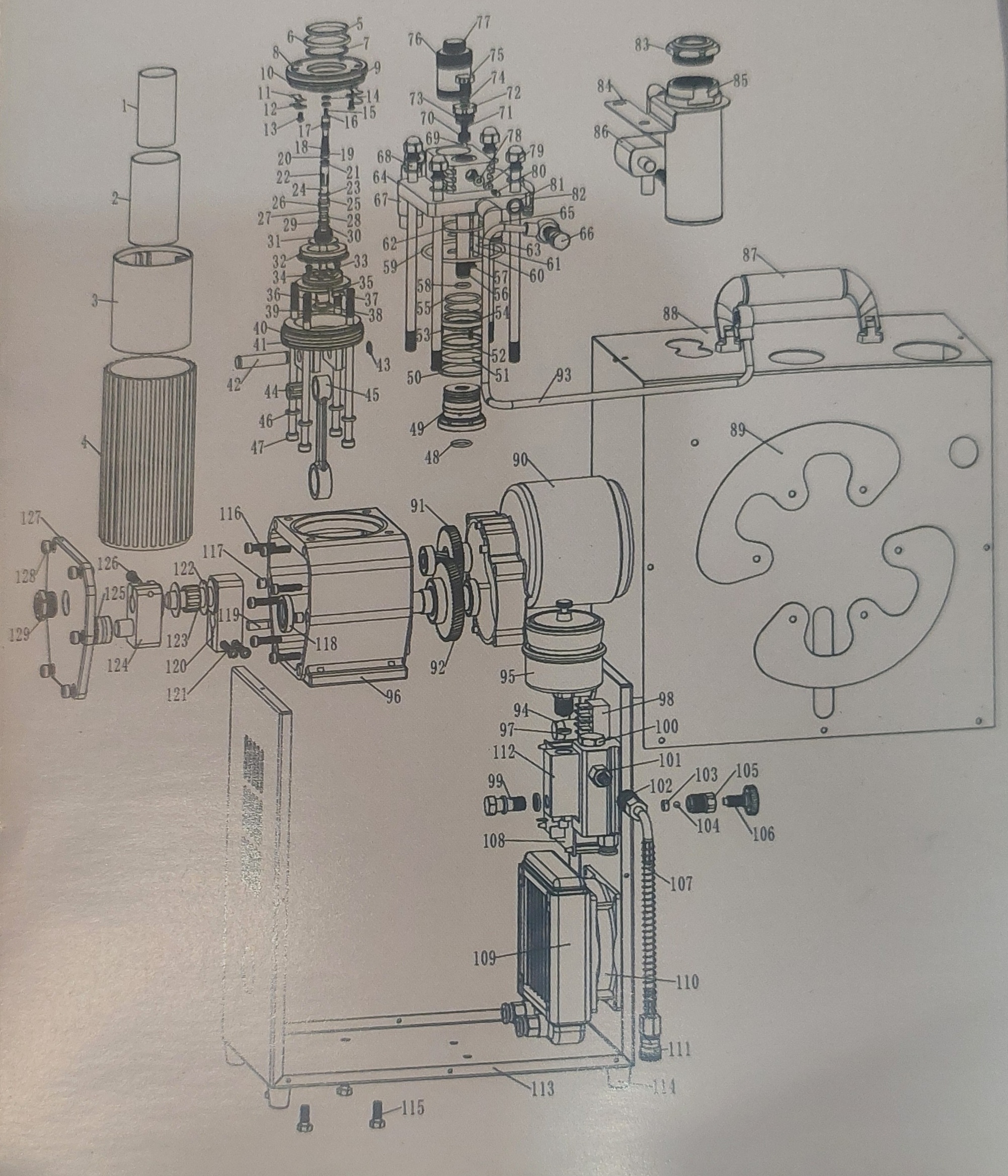

Aren't the reduction gear set on the motor also a point of failure on some CS compressors? I've seen some posts where the larger gear had the teeth worn out while the smaller gear on the motor survived. I would think it was the opposite since the smaller gear has a lot less metal to wear down driving a larger one but I'm not an expert on the subject matter.
