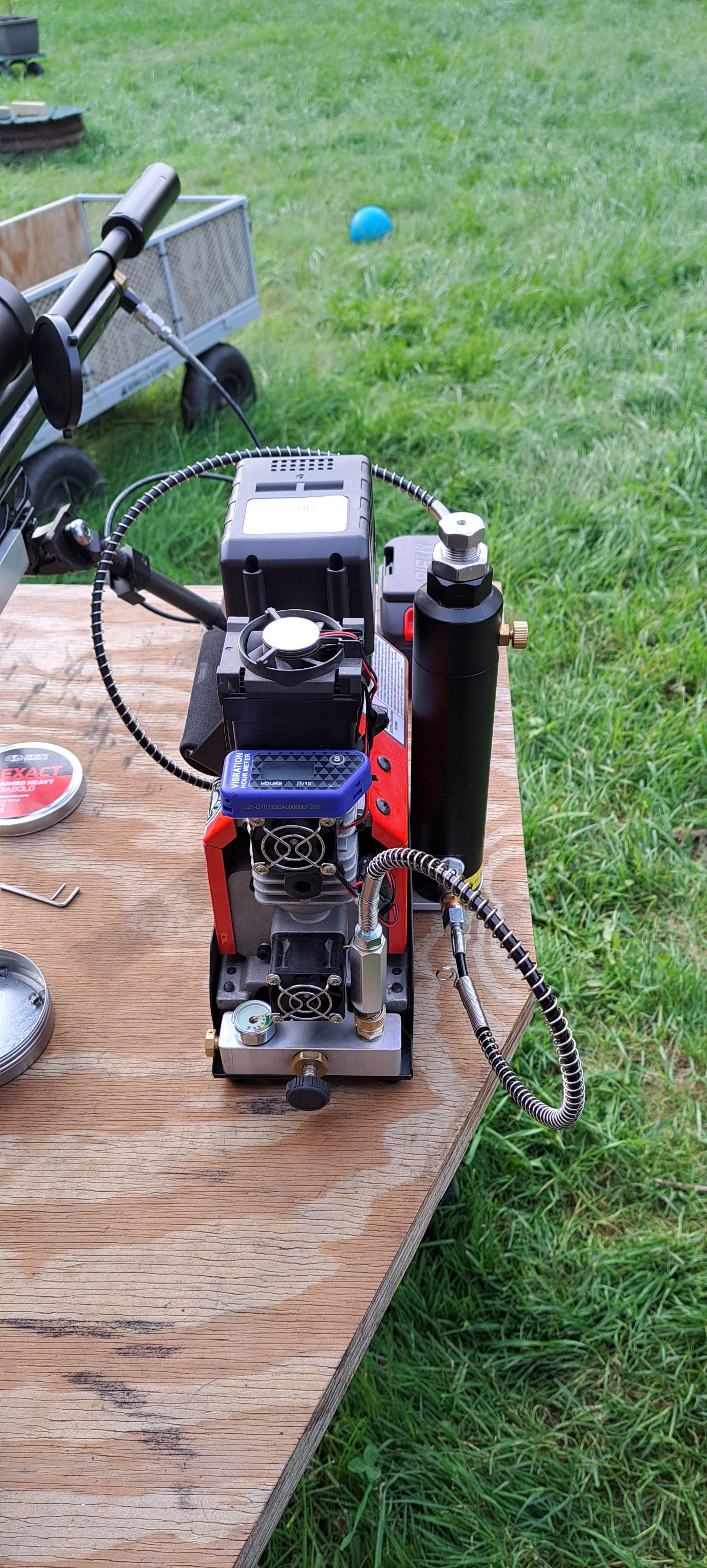

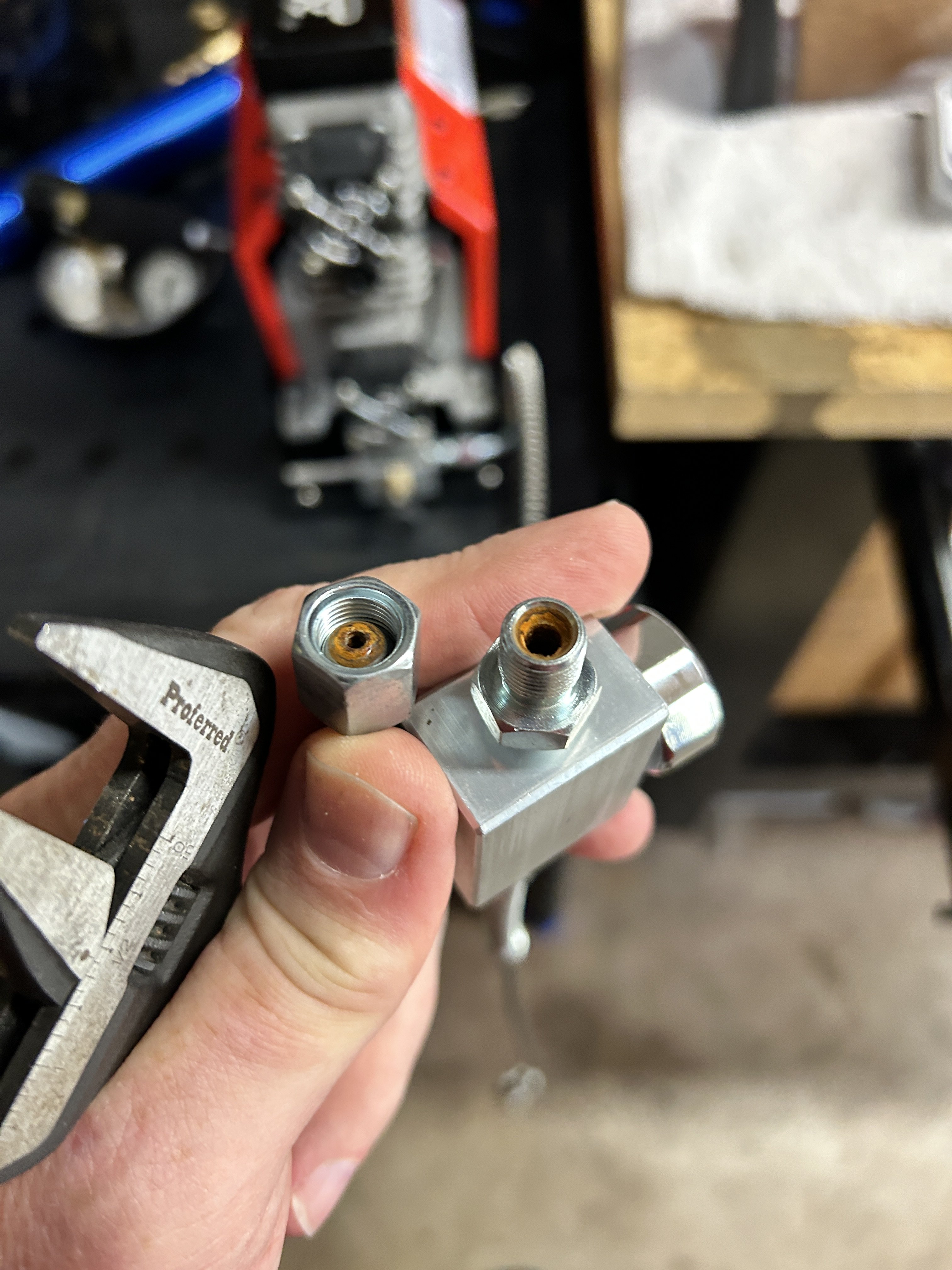

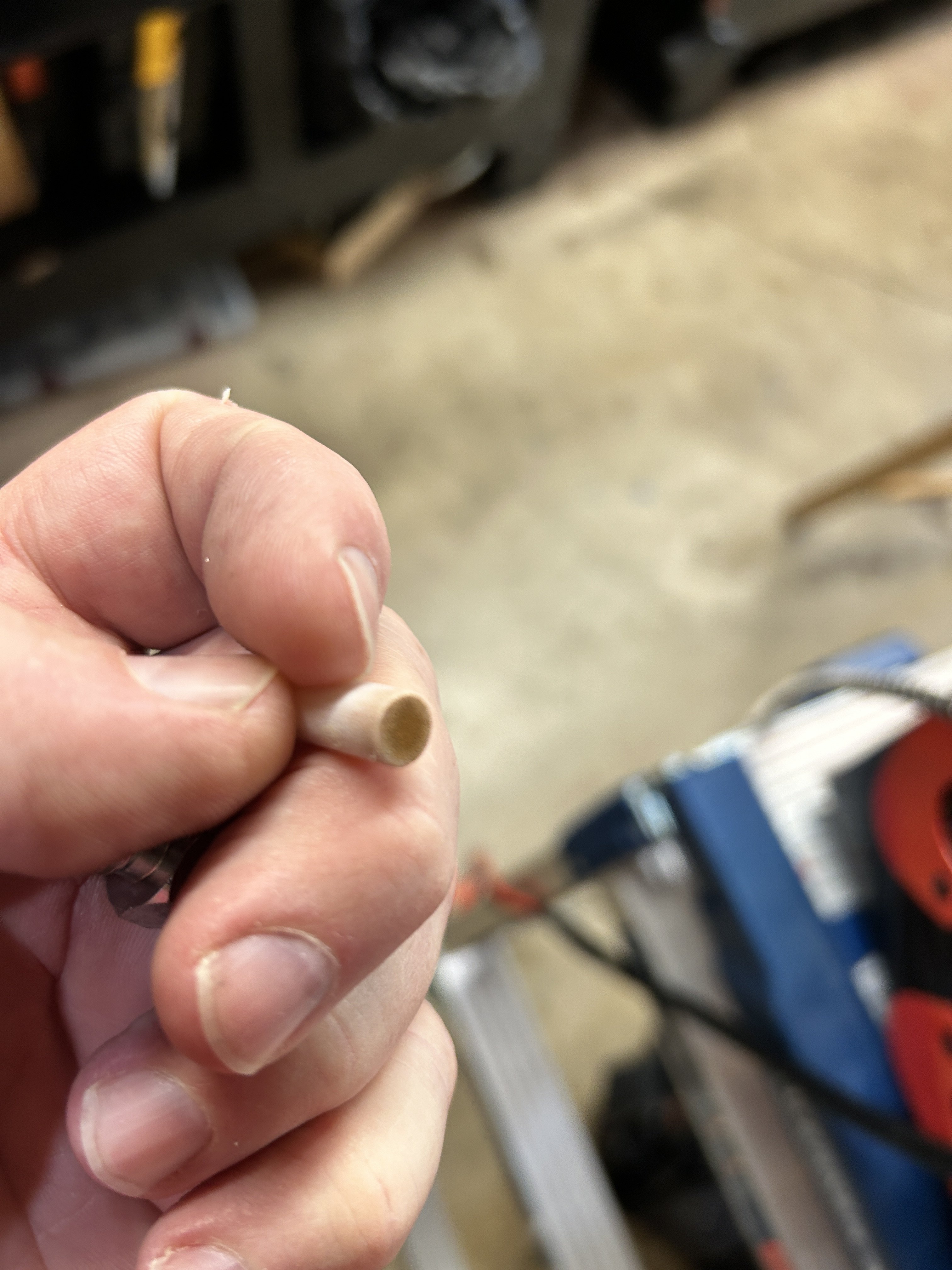

After switching to Nitrogen for the inlet of the GX compressors, I decided to do a full "look see" inside my two most used units. First up was a CS2. As you know the CS2 has the pressure relief block at the bottom front of the unit, and a gauge block at the end of the hose. I had added an additional length of hose to the outlet side of the gauge block for more reach. When I took the block apart, the inlet had a fairly bad amount of rust in it, and the filter was dirty. The outlet was, however, clean. If you think about it, when filling, the gauge blocks weight, and being in the middle of the two hose lengths, makes it the lowest point and a place for moisture to accumulate, hence the rust. The pressure block on the unit itself, where you bleed the pressure and the outlet is on the other side only had a very slight amount of white stuff on it, easily cleaned off. Soooo, you should keep a good eye on the gauge block and it's filter if you pump just air. Photos below.

Just got CS2 for back up on my Young Heng. The gauge is now in PSI. Jason claims that you no longer have to lube the new ones, right. The old black plastic plug now has a hole in it! Shame the factory does not clean after tests before sitting in warehouse/transport. Mine was rusty and small cigarette filter dirty. Here in the South I have to use 12" filter cartridge. Cotton, then color change beads as a tattle tale followed by molecular sieve. Wish N2 was an easy option for my bottles especially in the field.
