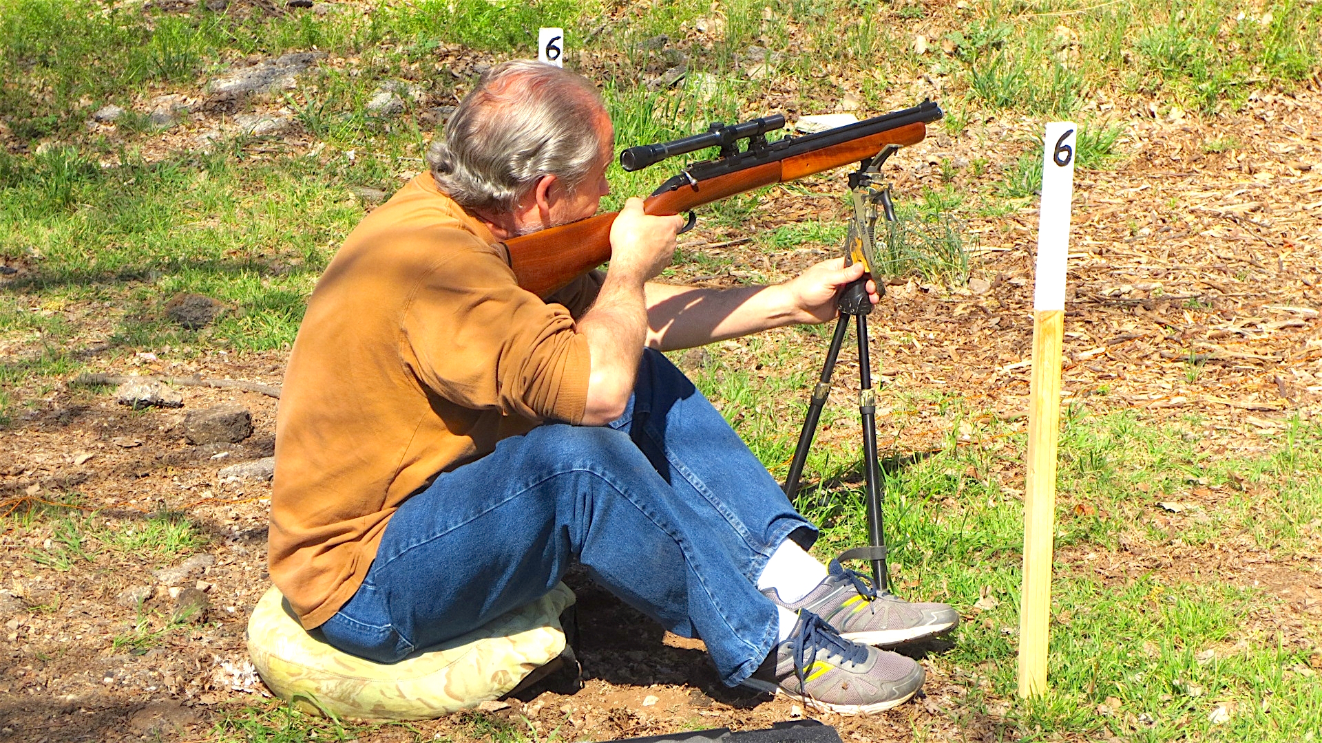

I've shot FT with an old pump despite having multiple, highly-capable PCP rigs. Finished in the top third.
"Looks about 40-45 yards, so seven pumps."
Actually, I think that would be a great "fun" match. Shoot Euro HFT style with multi pumps.
