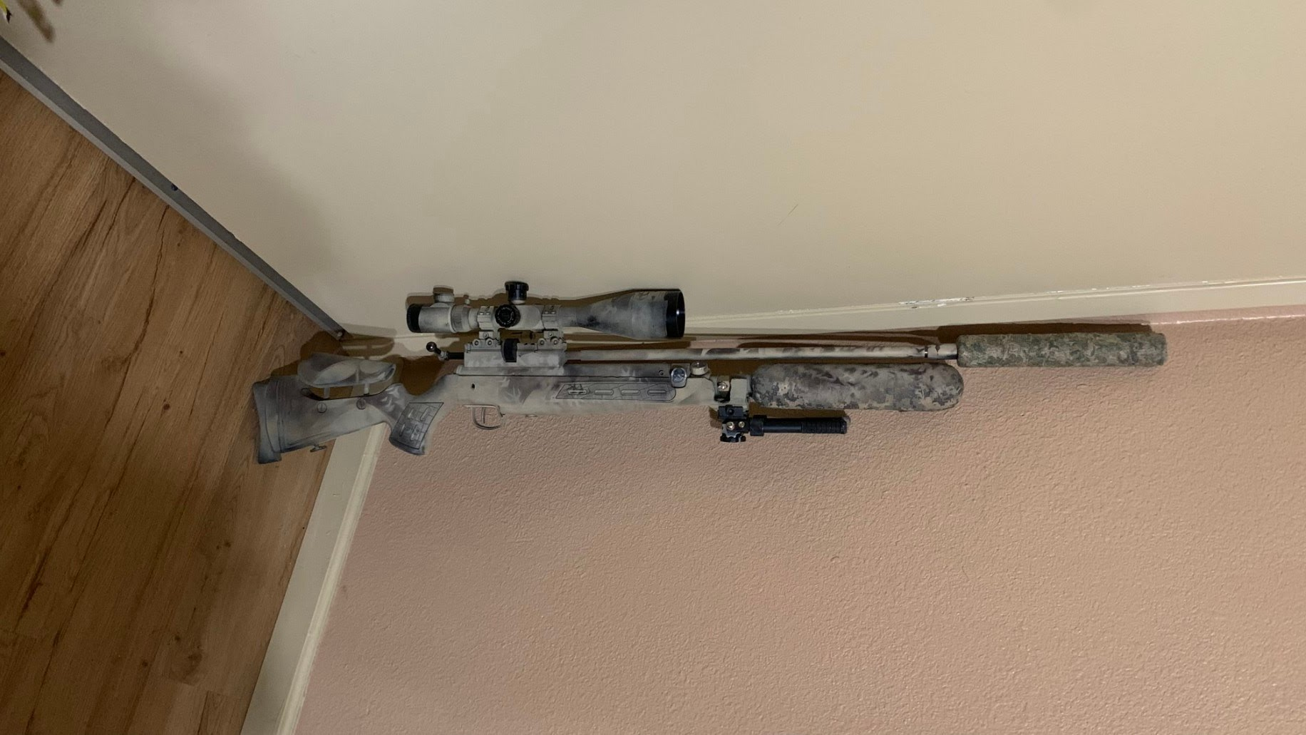

I'm shooting a .25 FX Impact X with Slug A liner and Athlon Midas BTR gen2 4.5-27x scope, and NSA 43.5 slugs at 950 fps. I REALLY wanted to love the NSA 38.9 at 1000 FPS, and they were accurate, but not quite as accurate in the wind as the 43.5's at 950 FPS. I also tried the ZAN 41's from both the Slug A and Superior Heavy and neither had the accuracy of the NSA in the Slug A...
