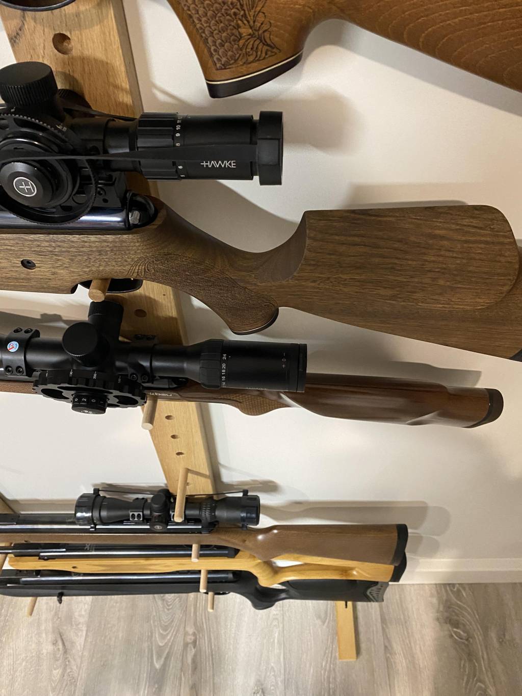

I made a few gun racks for on wall. I used scraps wood. Their all different. Just to let any of you know, cause I know a few expressed interest in
making them.

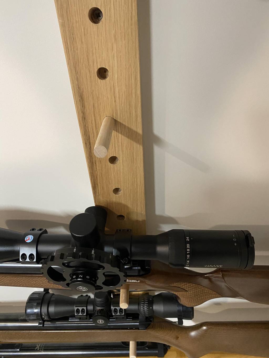

 This first picture shows a wider board used. Problem, scope adjustment in the way. It doesn’t sit properly either.
 Solution, with the rack down to 1 3/4” wide, the scope bypassed the rack. Also sits properly and safe.
 Hope this helps someone. Crow

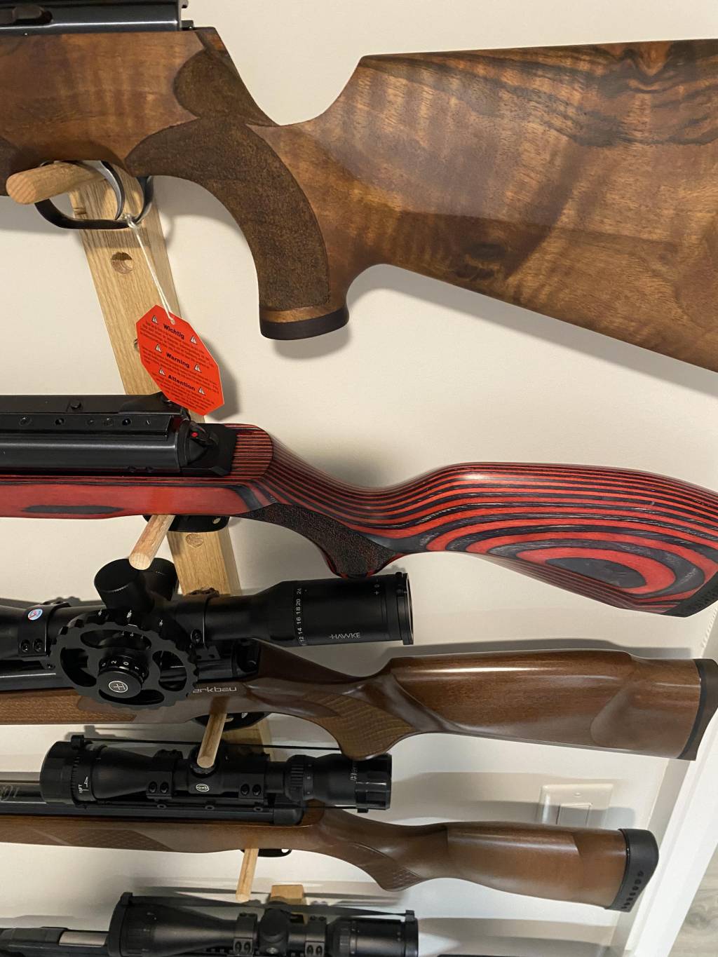

Dizzums their on a 4-5 deg. angle, just friction fit, had to hammer in. They will come out, but not easy.
‘Does get much cheater than this. The pegs I inherited 19 yrs. ago from my dad, they were the rungs of a baby crib, reused. made 100. Saved $25. not getting hooks. Those hooks up here are $ not 25
I mentioned this post because I noticed a few rifles wouldn’t sit properly on rack. Crow
