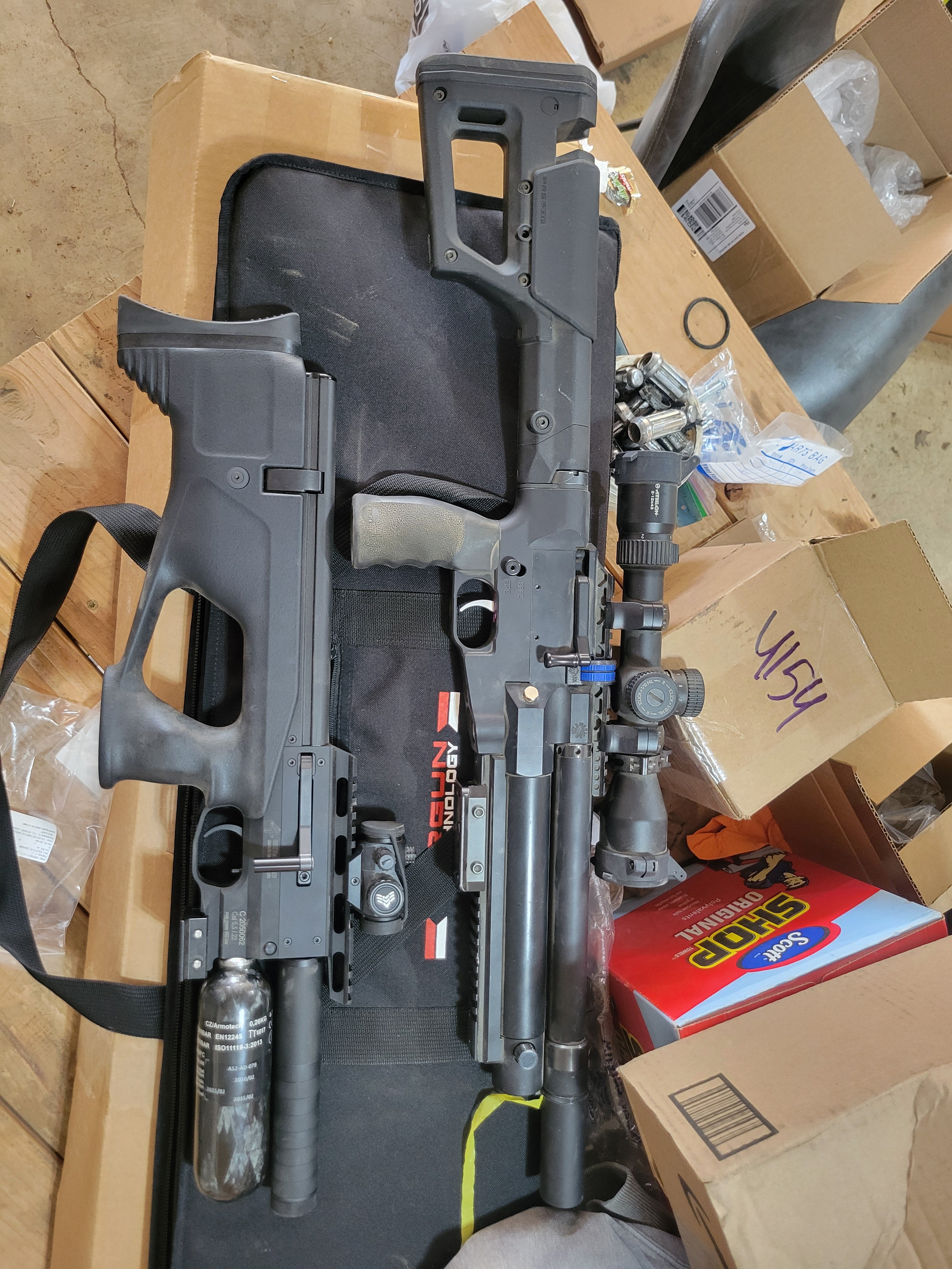

I went through this a few years back. Had a gun to do 2 jobs. My normal 30fpe pesting and turned down to around 12fpe for barn pesting. As nice as that was to have it was a pain going back and forth honestly and forgot sometimes about switching power back between the 2 separate jobs. Yes it's more money but now have 2 dedicated rigs for my needs and never have a problem. I also got 2 guns that shined a each job. One at 30fpe and one at 13fpe.
Edit: Also wanted to clarify I used an Umarex Notos as my low powered gun for a year before upgrading to the Uragan Compact which I picked up used to save some money. If money was an issue, low powered guns are easy to come by in the budget category. Then you can also get a feel if you enjoy the 2 gun thing without dropping a bunch of money.
