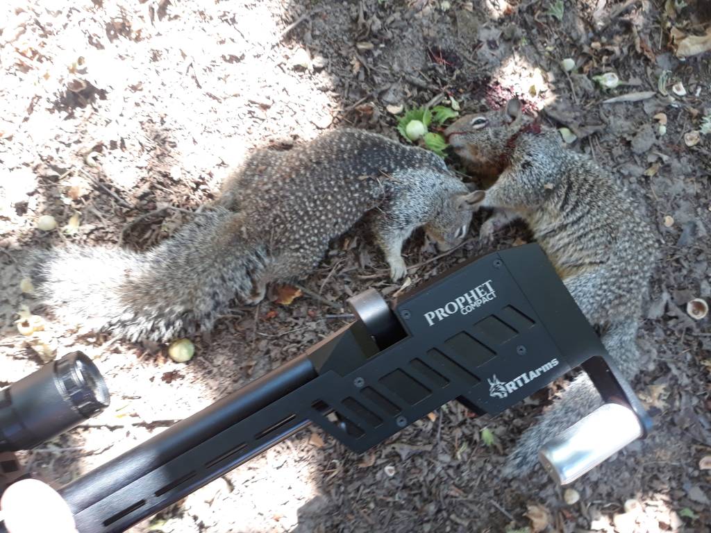

Great day out here on my permission cutting easy firewood and I got a full truckload and about five ground squirrel to the show for it and some bloody messes.

I emailed Rob at RTI and he said, as you may have heard already, that the RTIPPC was sent from the factory with the regulator set 150bar because they primarily intended for that tool to shoot 18 and / or 25 grain pellets. It shot 18gr at 970fps from the factory so that setting had room for the 25grain I believe.
I am shooting 15.9gr, 130bar regulator at 912fps with awesome accuracy, on paper, feathers and fur, out to 50yards. The pellet shortage is a b i t c h but I got some AIr Arms 18gr unfortunately my compressor blew the burst disc so I am on AIR CONSERVATION until a new burst disc arrives and I can turn up the reg to balance hammer spring and reg to shoot the 18gr.
The 16gr are deadly and it likes Predator Poly Mags so I may just leave it at 130bar, not sure. I get so many shots that haven't measured shot count. Just having fun with it.
At 25.75" OAL it's gotta be one of the deadliest, at least that I've actually seen and shot.
