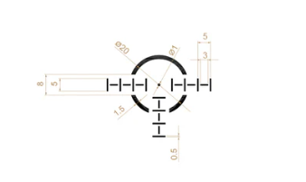

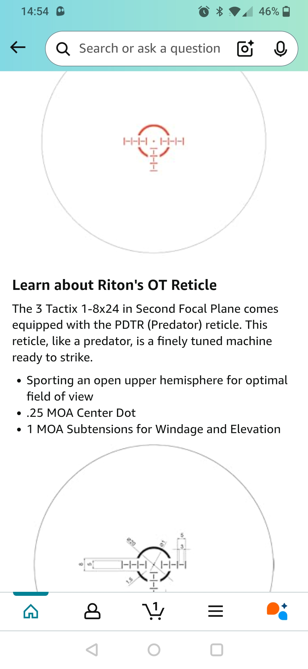

Do you happen to know the size of the center dot @ 100? Can't find it on Riton's site.
Found this (below) at a retailer website. 1" @100 sounds large.
Found a review where the Riton was discussed and the reviewer thought the center dot was larger than it should be, so this prompted me to do a little research on the reticle.

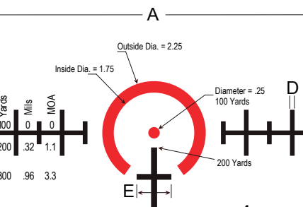

The burris RT6 for instance is .25"
It's a .25 moa dot

Center dot is 1" not .25"
