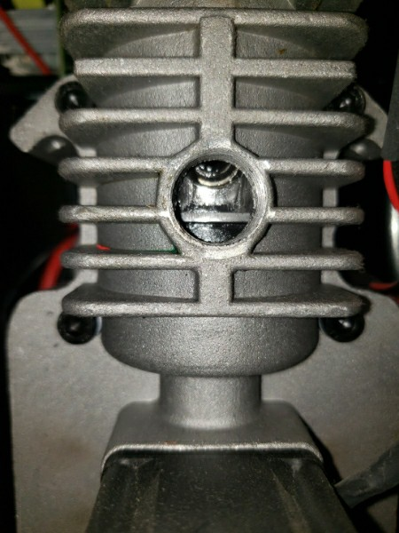

I am pretty sure that the black filler plug on the cylinder is for adding grease. The manual refers to part #51 but on the diagram that is an O-Ring. The Manual calls it the oil drain plug and the part number for the black cover is # 48. My owner's manual says to grease it every 100 hours, some apparently read 50 hours and some say it never needs grease. I am going with a small amount of grease at maybe 30 hours. Hopefully it will be easy to figure out. The instructions say to turn the motor on and off until the high pressure rod #71 is exposed and to add the grease there with a syringe. There is no part labeled High Pressure Rod in the diagram.
Update. I found a Target Forge video on YouTube showing how to grease the GX upper cylinder as well as the lower High Pressure Rod,
Which is not mentioned in the manual but recommended by Target Forge vs just lubing the high pressure rod. What is the recommended run time for lubricating the top end - I didn't hear him state that?

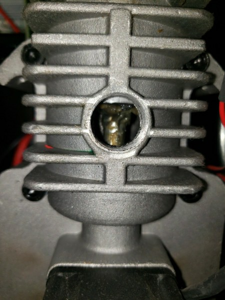

On greasing only the high pressure rod per the owner's manual, it took about 30 tries to get the piston up high, exposing the rod but I finally got it. I can see some grease on that rod already so I didn't add any more - just moved what was hanging there but not on the rod so it was touching the rod. Using a tool to rotate the motor as shown in the video looks to be the way to go to get it aligned.
Piston blocking the opening is the way it stops most of the time.
Rod showing took about 30 on off cycles.
