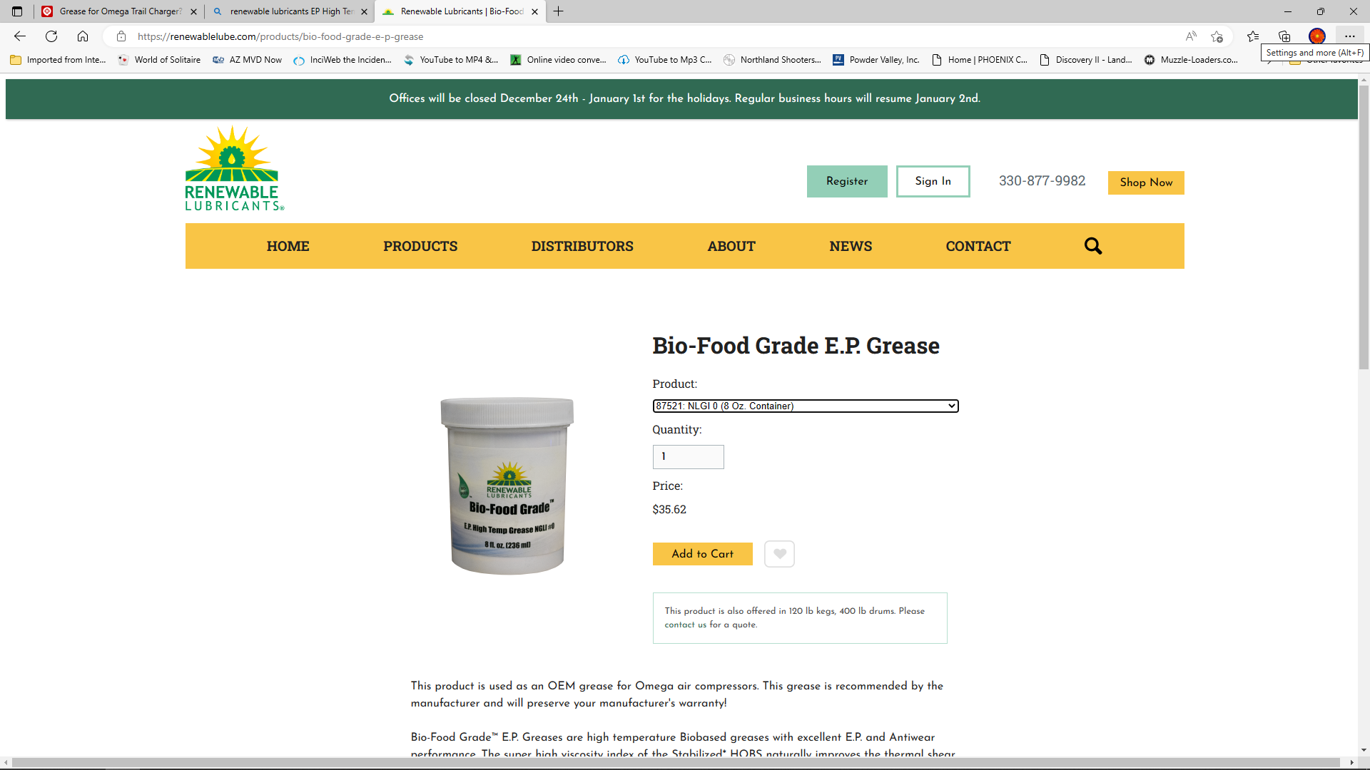

I do not have a trail omega but the other Omega compressors (mine is an Air Charger) use a food grade grease made by Renewable Solutions Bio-Food Grade
E.P. High Temp Grease NGLI#0

The important part is the NGLI #0 grade. Just click on the screen print below and it states that it is for OEM grease for Omega compressors
