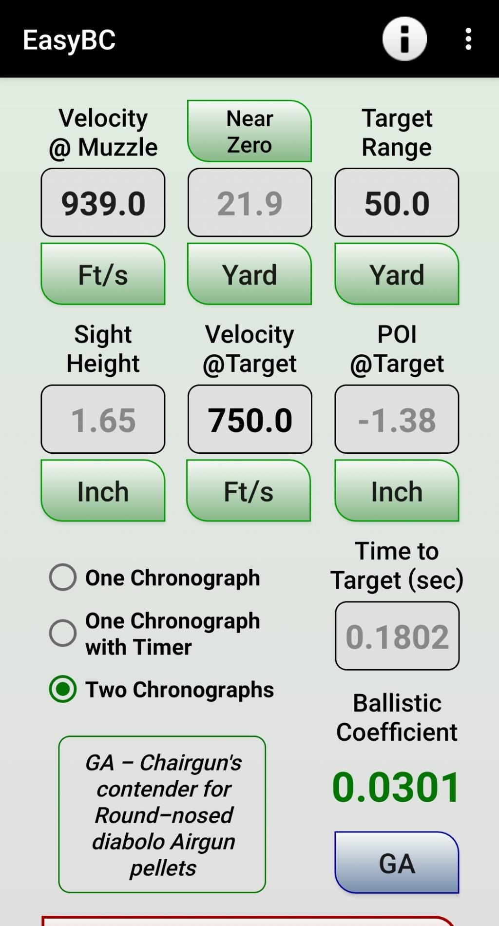

So, let's say I measure a JSB dome's BC with two chronos.
True MV = 939fps
True V @50y = 750fps
🔺 True BC = 0.0301 ➔ At 100y a 15.89gr dome in a 5mph crosswind drifts 7.3".

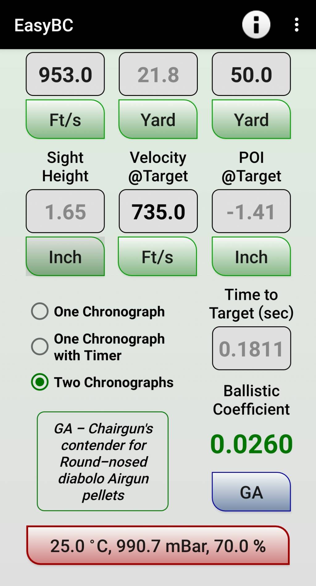

BUT the "True Truth" is not known because of our chrono error: we get some funky measurement variations:
🔷 Chrono 1 fluctuates just half of that vile 30fps UP, instead of showing 939 it shows 953fps.
Chrono 2 fluctuates just half of the 30fps DOWN, instead of showing 750 it shows 735fps.
🔺 BC now only shows at 0.0260 —— and instead of the 7.3" correct wind drift we would calculate 8.5" wind drift — a whole 1.2" more drift — because of the chrono error of 15fps.

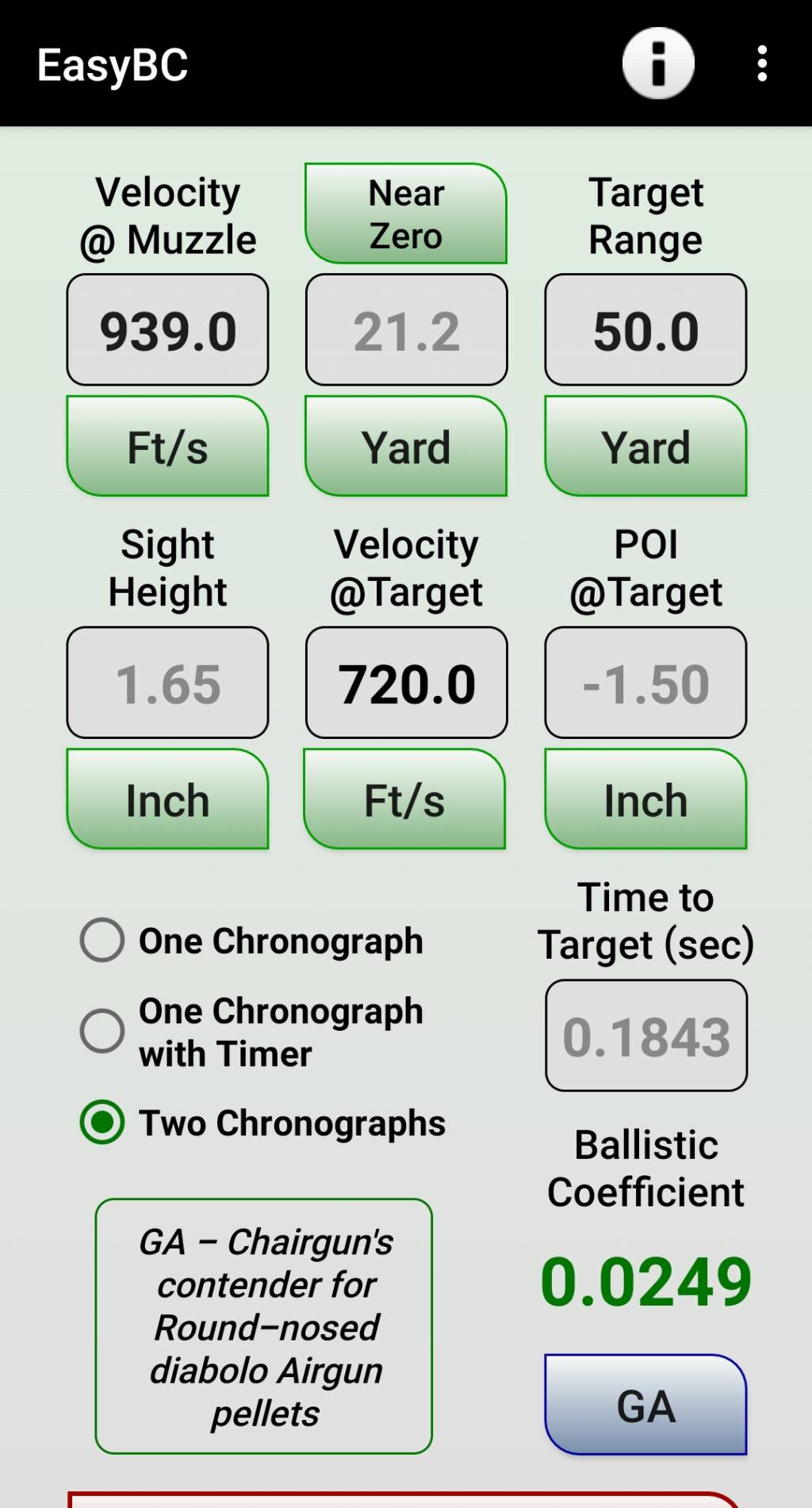

🔷 Now, chrono 1 is dead on! 😊 showing 939fps.
Chrono 2 fluctuates the vile 30fps DOWN, instead of showing 750 it shows 720fps.
🔺 BC now only shows at 0.0249 —— that's even worse that the previous example....
Ballistic Calculator. GBC. EasyBC App. BC0.0249. V1939fps -- V2720fps. 50y.1640498495.jpg
Of course, my hope would be that if I have enough measurement data points, the fluctuations will even each other out....
For that I'd have to compare the chronos side by side and see if one has a tendency to always read higher or lower than the other chrono.
🤔 And if they do — then what do I do....?!?
