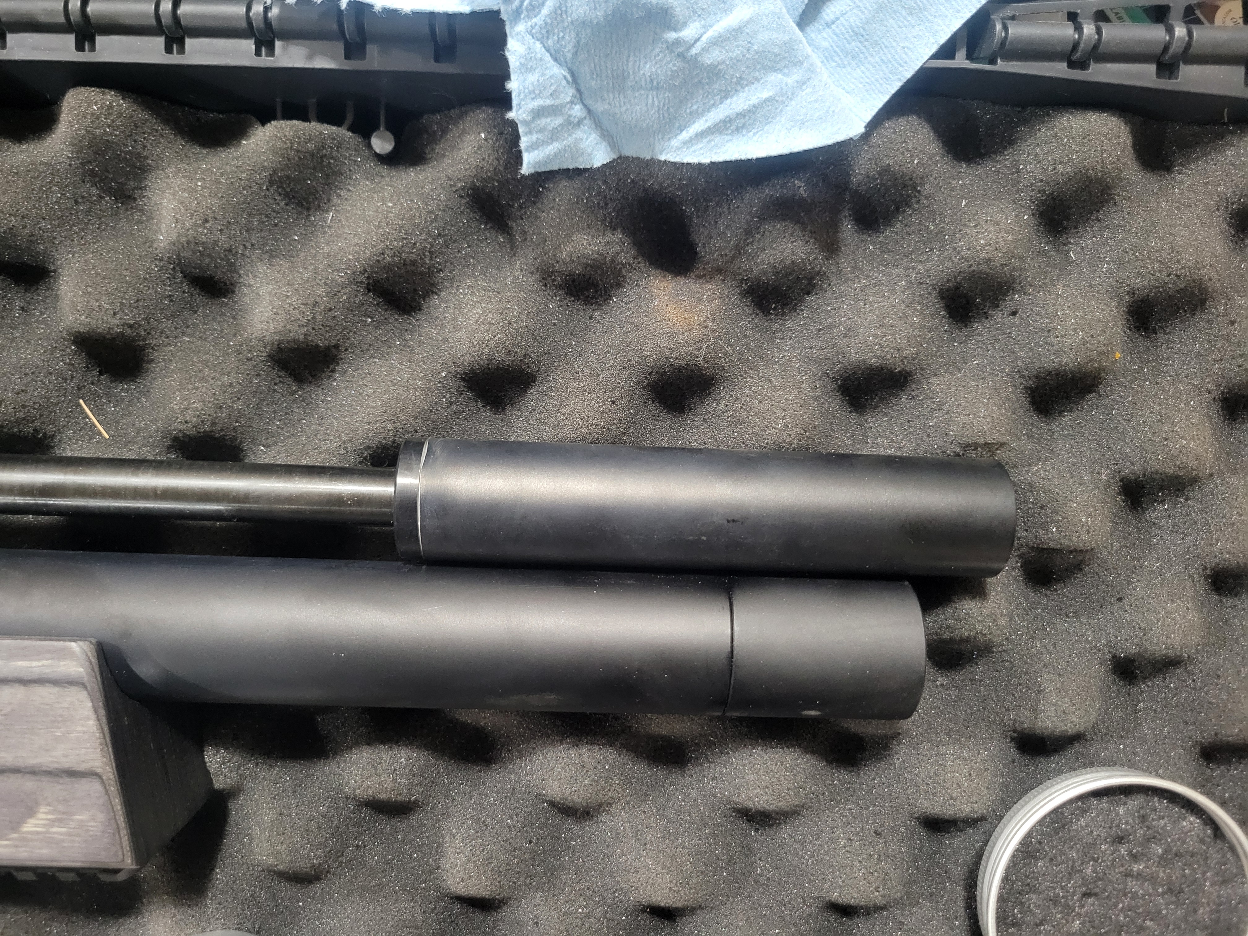

So I used a chop saw and cut it off behind the snap ring enough to fit the end cap. Cleaned up the sharp edges with some 600 grit sand paper. End cap I chucked up in a drill with a bolt in it and bent washer to center it. Used a flat file to take the threads off. Fit snug into the end but able to remove easily as well. Put it on and screwed the mod on all the way then tightened the end cap against it with the set screw. No noticeable bend when rolling on a flat surface now. Noise wise seems very quiet, no significant difference vs the full shroud that i can tell. Not too bad for about 15min in a rednecks hands. Will need to test accuracy tomorrow. Dont think ill keep it like this but for the time being it should at least allow me to shoot it until i decide on a permanent fix.
I'm trying to picture what was actually bent. Was it the shroud itself or the mod? I know the shroud on these things is pretty short.
The shroud itself was bent. On the long it's about 360mm long but yes it was bent slightly in the middle. I need to do more testing, was quite windy this morning but accuracy wasn't anything special with or without shroud. Could just simply be the wind which was variable and kind of swirly. Now I can't say there was any noticeable difference between the 2 so hoping that means I got it figured out.

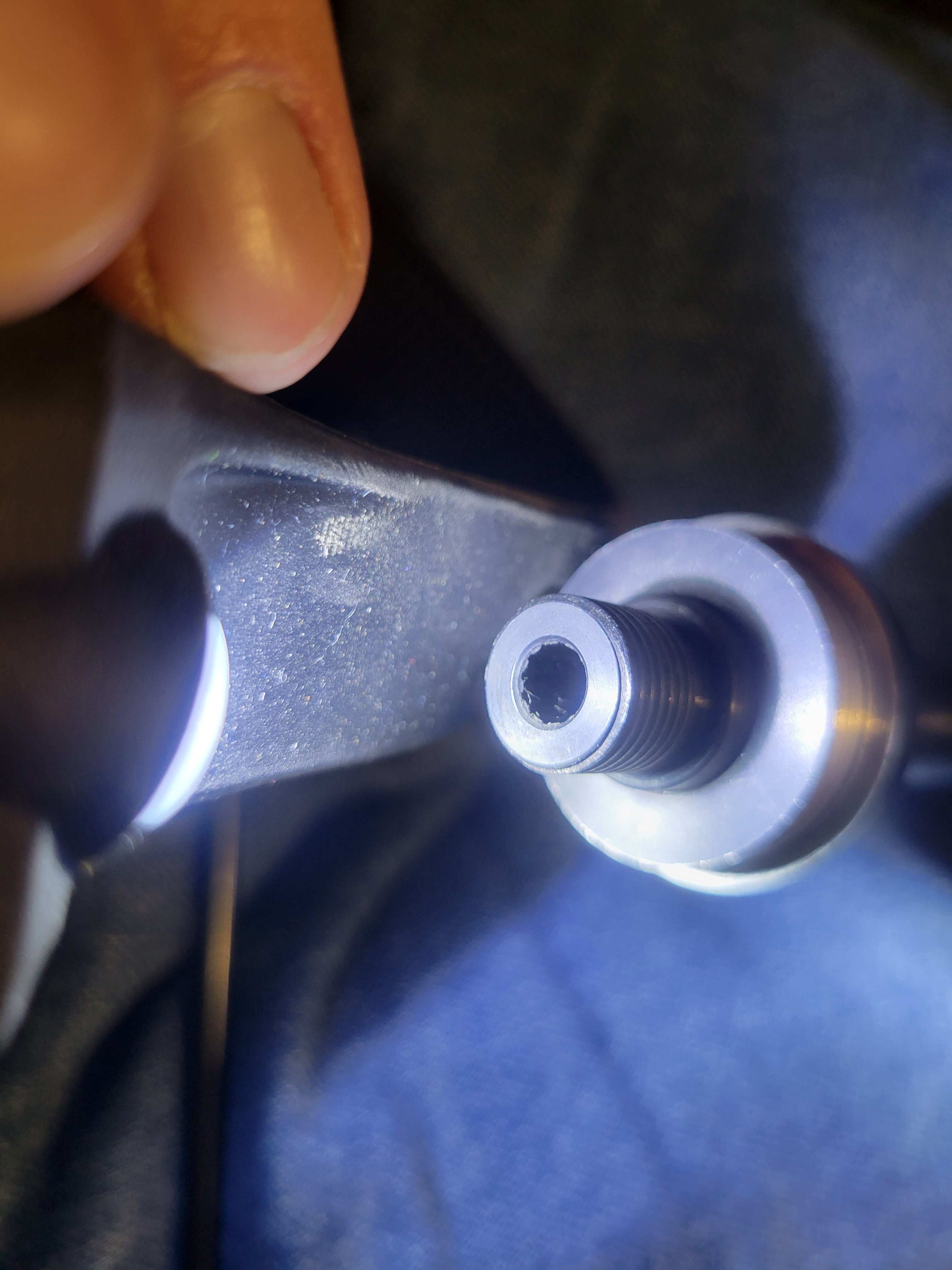

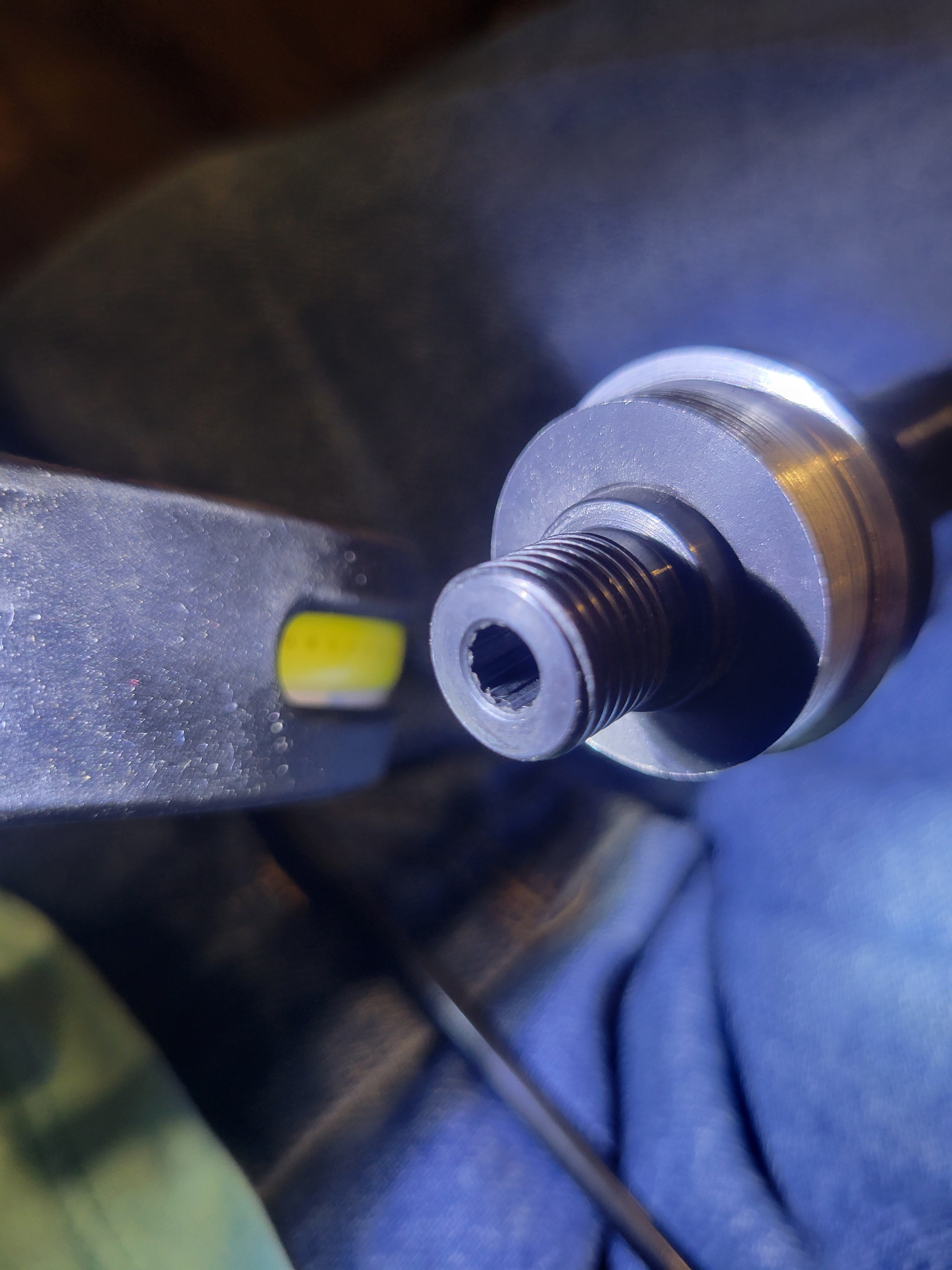

The plot thickens! The crown on this barrel is full of burs. Hard to get on picture but here's what I can see. And these 2 pellets also, one pushed through all the way and one stopped at the crown as one can see its very drastic. Barrel is nice and smooth then hit the crown and is very hard to push through. It's almost as if the crown got folded back over it self.
