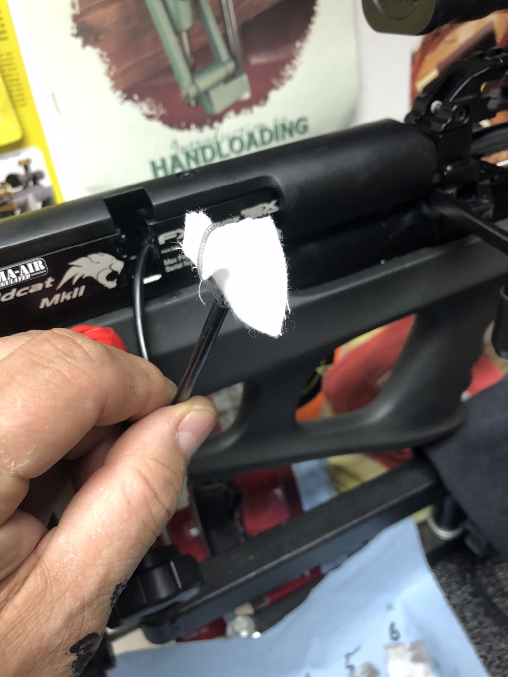

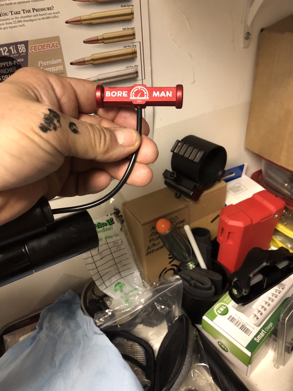

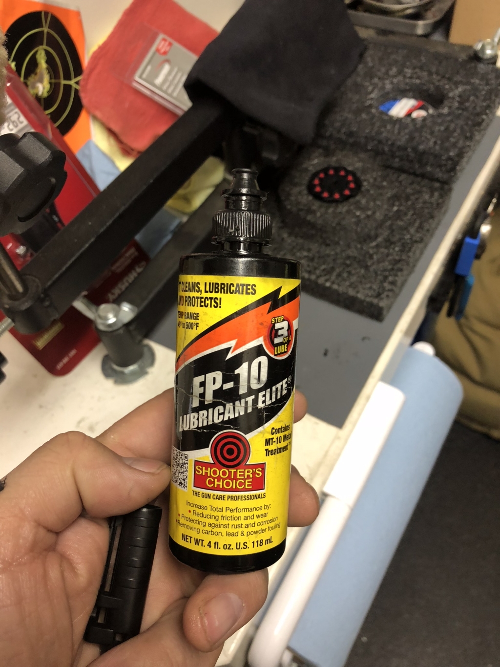

Having never owned a gauntlet i cannot answer the majority majority of your questions, but as far as cleaning procedure for a PCP most folks use a pull thru system. The one shown in the pic is one I bought from airtanksplus.com. You insert the line thru the moderator(use a drinking straw shoved into the moderator as a guide to fish the pull they line, if need be) and when the line comes out the pellet hole in the breech there is a loop to sling on a cleaning patch. I happen to use FP10 as my cleaner of choice. Others use Balistol, Napier, etc. you lightly soak your patch with it and then pull it out thru the muzzle. If you can do this with the gun upside down, all the better, so cleaning solution doesn’t get in the transfer port passageways.
You can buy a cleaning kit commercially like this one, or do what others have done and make a set up like it using weed eater line, or a very heavy fishing monofilament line.

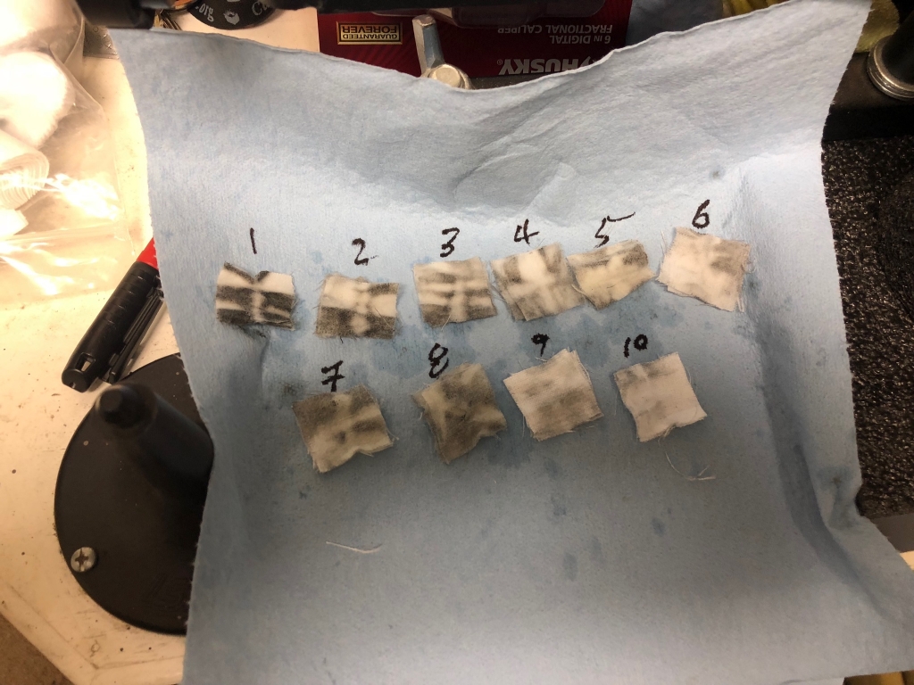

on my particular gun it took 10 or so patches to pull thru before it came out all clean.
