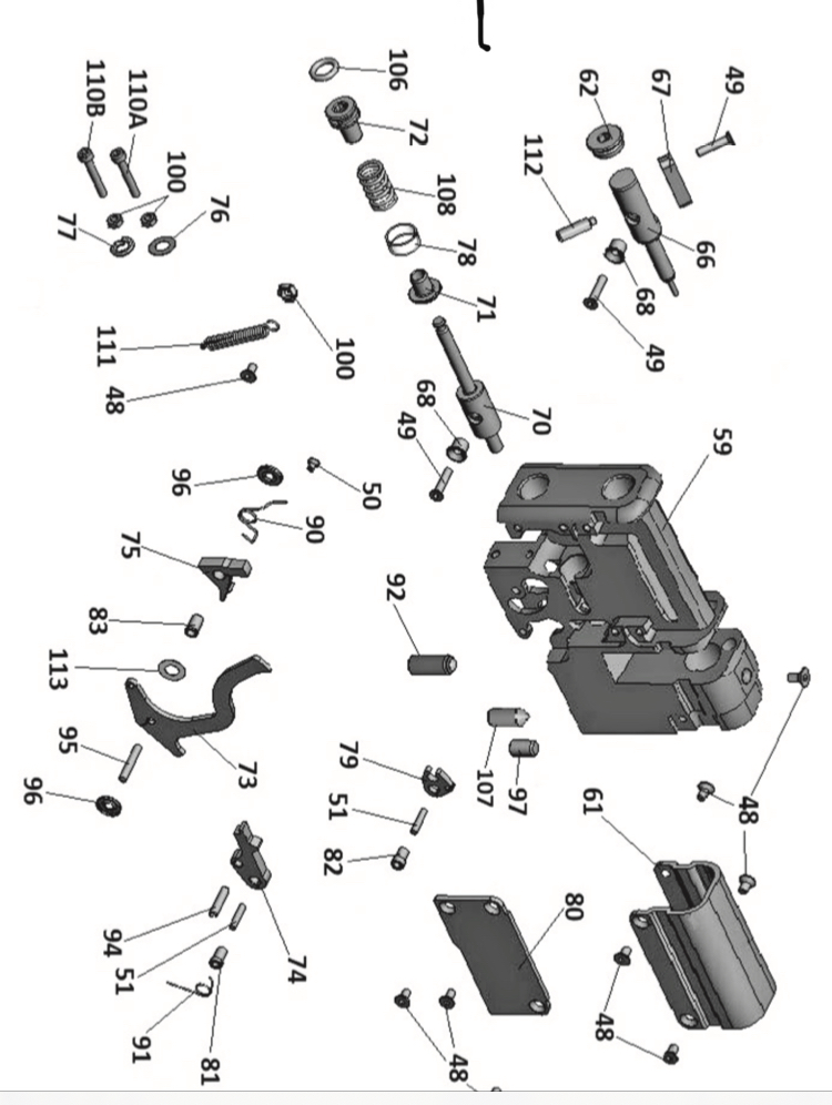

I’ve never tried to get Cricket or Taipan parts. But I do know that AGT (Vulcan/Uragan) parts are easily available from the factory. I’ve done this three times in the past two years with Vulcan and Vulcan2. Emailed Evgeny requesting to purchase parts since my guns were bought used. In every case I received the part(s) requested free of charge in about ten to twelve working days. I emailed with model and serial number of the gun, part description and number from the owners manual (available online). I’m pretty sure that’s about as good as you’re going to get from any other manufacturer. The only downside is if you aren’t mechanically inclined. Although the AGT guns are very easy to work on...

For AGT, the drawing has part numbers. The list of parts on following page is for orings, fasteners and parts that are common and have specific sizes. In my last case I ordered part number 73 from the drawing below. Listed .25 caliber Vulcan Tactic. Listed serial number. Asked for part number 73 of drawing. Attached photo of broken part to email. Received new part in a couple of weeks. Actually I was sent two of them. Free. One thing they are not good about doing a back and forth email dialogue. That is hit and miss. But they will send you the part if you provide logical information to them.
