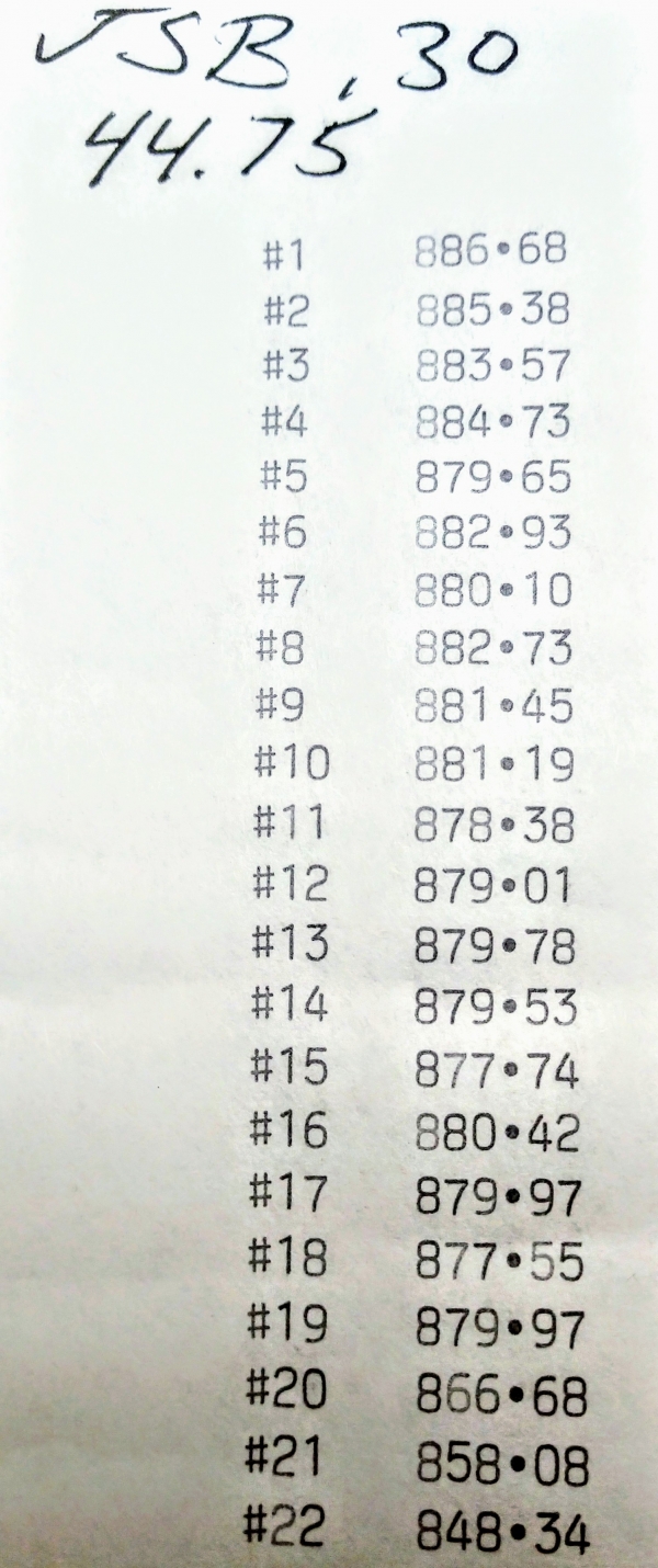

When I talked to Tony yesterday, just as it shows on his web sight, he stated the 18-20 shots before it falls off the regulator. He does shoot/tune every rifle and it is sent with the shot string chrony data but I will definitely get that info posted in this thread once I take delivery. I’ll run three back to back strings and will run the third string upto a higher fill pressure. This is a string he shows on his websight and I’m almost positive he tunes the .30 to run the JSB 44.75 grain unless you ask him to set it up specifically for the 50.15 grain.

Had’nt had much trigger time but was able to run about a hundred rounds through her late in the afternoon. After my last session I decided to clean the barrel before shootin her again. I’m glad I did as the groups were much more consistent and tighter. This session I mostly worked on my grip, grip pressure, trigger control, and staying in the scope when the shot went off. I believe the gun is capable of Good groups as I had two, four shot groups that were Almost one ragged hole! All the groups were shot at fifty yards. Of course the fifth shot opened up the group... UGH! So far I haven’t run her over the crony but think that I’m getting around fifteen/sixteen good shots with a 250 fill before the gun falls off the regulator. I plan on shooting a tin or two before I start monkeying around on the gun. First adjustment on the list will be the trigger. It’s okay for a hunting but I’d like to run it a little lighter.

First, this is a Very Air hungry Beast! I am getting only 15/16 good shots on a 250 fill before my group starts to really open up. Maybe after a few crony strings I will have a better picture on what’s going on. It is a 30 but was hoping for at least two full mags (18 shots) before the groups starts to open up.
