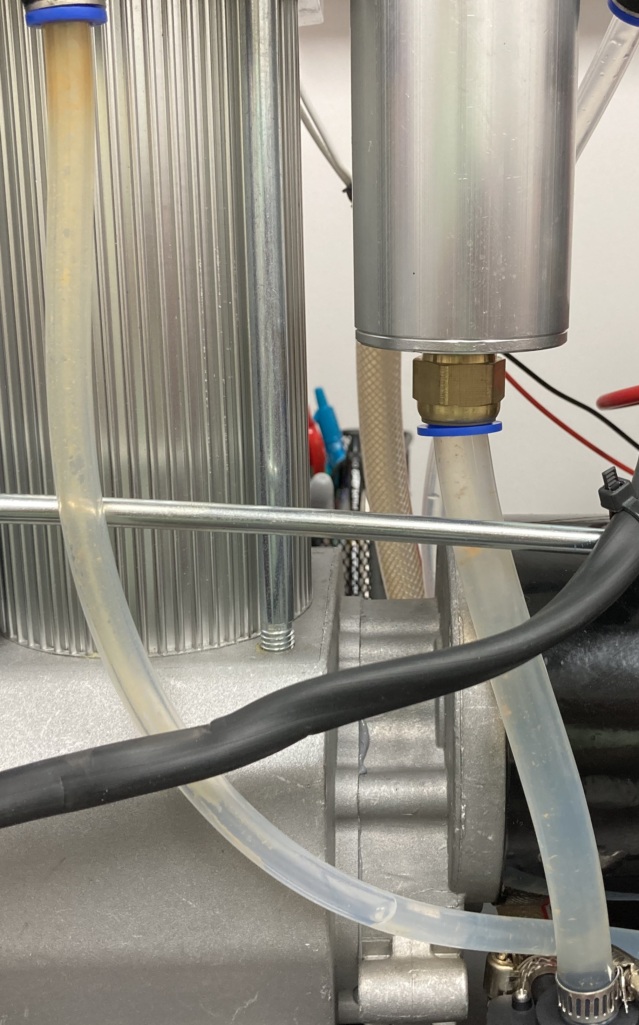

Mine arrived Tuesday, and I did a similar process as above to flush the system. Mine also had some nasty looking water in it. I forgot to take a picture of the reservoir, but it was visible in the lines as well. Yesterday I tried to swab out the compression tower to radiator line. As I hadn't topped the unit off yet, the line was dry, and the junk was powdery, like fine rust. I don't know where it came from, but I filled the system with distilled water & Water Wetter, so it's got good corrosion protection now.

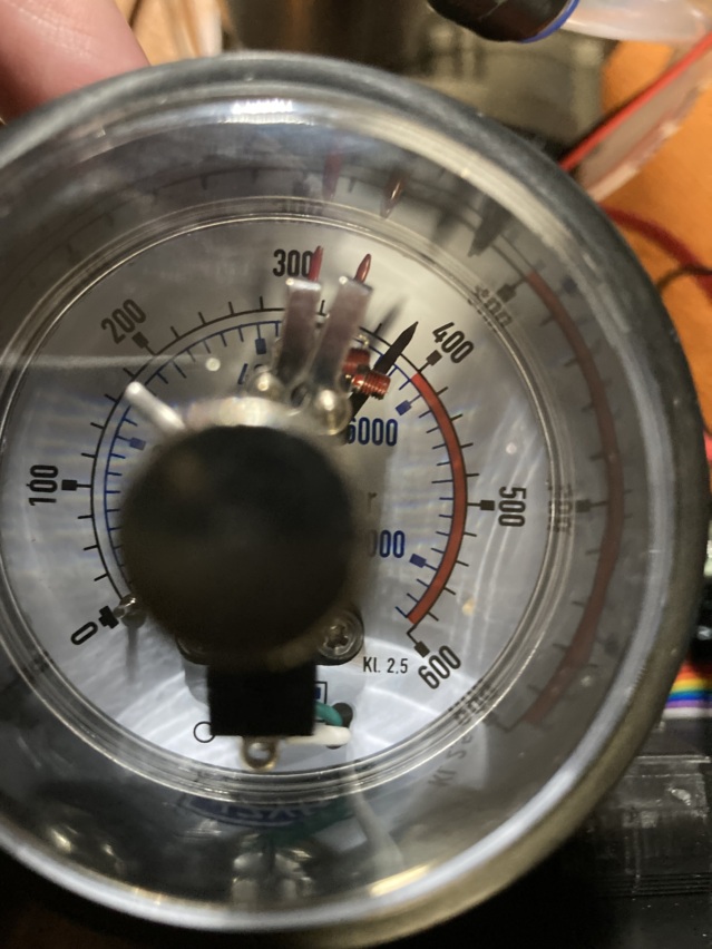

dirty coolant line I ran it a bit last night, just with the supplied fill hose & dead head. I didn't time it, but it seemed to run up to ~300 bar quickly. Unfortunately, it kept going! I shut it off shortly thereafter, after it had passed both stop settings:​
GX CS4 pressure gauge as received-small.jpg I didn't have time to try it again, and watch the actual electrical pins in the gauge to see how they were rotating. I'll try it again this weekend, and reach out to GX for support. My Tuxing doesn't have an auto-stop, and this isn't a show stopper for this unit. I'll try it on a tank or gun, but everything else seems to be working fine.

Edited to add: I sent the above picture of the gauge to their support email, and had a reply within a day, asking for my address to send a replacement gauge to.

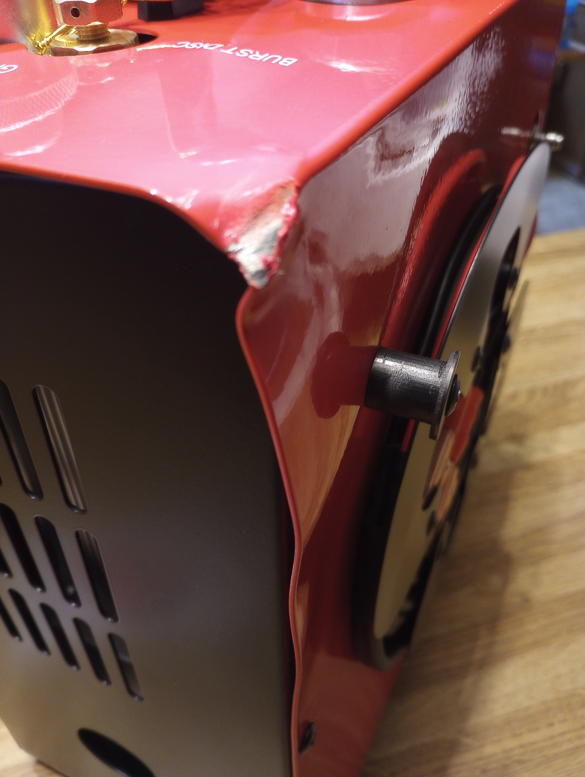

good post! I have the same exact hour meter arriving tomorrow for my one of a kind Highly customized CS 4 courtesy of our "friends" at UPS! Have flushed the system and pressurized the line verifying operation and auto shutoff. Hopefully this weekend it'll be filling little bottles and the unit will last us all awhile!
Can't figure out how that happened. My compressor came encased in thick Styrofoam and a double cardboard box.
I take it the compressor still works but are you getting reimbursed thing for the damage they cause.
Yes, the compressor still works. I topped off my 2 small 90 cu in Benjamin tanks this past weekend without an issue. Not pretty but it still works
Yes and no about the compensation. Yes: I was in constant communication with GX Pumps (bought it directly from them) and they immediately offered an additional 20% discount thinking it was just case damage, which it was. NO: Damage claim denied. UPS gave the same ol canned response that it was the shippers fault that they didn't use the magical unicorn box that they say exists and need to be used for every shipment in order to prevent damage caused by them.....oooppss I meant by accident. Not their fault even though someone or someones between shipping it from a NJ warehouse to a NY address decided to test the integrity of the box.
Wish GX could have denied the UPS denial and received full compensation, but at least I can use what I have.
This is an update to my post above, regarding the auto-shut off gauge (i.e. gauge works fine, but wouldn't auto shut-off the compressor). I had to wait some time (several weeks) to get a replacement gauge, as apparently they didn't have any spares even at the plant in China. Nevertheless, I got it a few months ago, but just now got around to replacing it.
It still doesn't shut off! I had already checked the both the new & old gauge's electrical contacts (once I got the new one, and thought about it), and both were good; i.e. the connection closed when the pressure needle's contacts met the limit contacts. So, I figure it's the cable harness or (hopefully not) the board itself. I disconnected the thermistor's connector, which is paralleled to the gauge's wires onto the board connector, then, with some small pliers, I disconnected the harness's female connector from the male connector on the board. And this is what happened:
It seems the crimped on female contacts were never properly snapped into place in the female connector. They looked to be in good condition, so I snapped them in, and they held fine (further telling me they didn't just slip out). Put it all back together, and the compressor shut off as it should. Yay for that!
On a safety note, since the thermistor is wired in parallel with the gauge, even if it tripped due to high temperature (it's rated at 65C), it never would have been able to shut the pump off, either. Strangely, when I looked up the thermistor's part number, it was listed as being normally closed, which clearly wouldn't work with the paralleled gauge being normally open. However, when I checked the thermistor's leads, they were open, so it must be a variant from the main part number.
