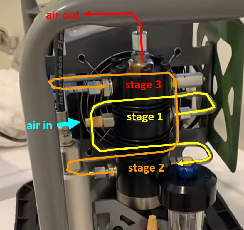

I've been tempted to get some stainless steel tubing and bend it to make a large coil between the 1st and 2nd stages and use a fan on that, same with the 2nd stage output.....
Do it with caution. Modifying the tube of the the first-stage output is probably OK as the pressure is not very high. It's unnecessary to do the same for the second stage output as the hot air is leaving the compressor there. Cooling those air will not help the compressor at all. You can see from the picture in my post above that on the Hill compressor, the tube coming out from the 3rd stage is not routed to the cooling fan. There is simply no such need.
I believe this method of cooling is less effective on 2-stagers like the Yong Heng because there is just one point for heat dissipation ( outputs of stage 1 ) along the path of compression. The Hill has one more point for the purpose ( outputs of stage 1 AND 2 )

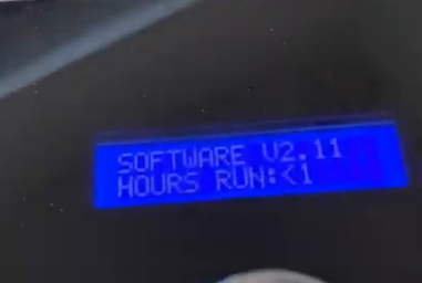

The German channel indicated a loosening of a screw/bolt in the electronic portion because they failed to loctite said bolt. He did say they were pretty circumspect about the issue
his unit was not replaced but the issue corrected and some scratches as well Hopefully Pyramid air will be more careful

Hello all - just noted that the German fellow made another update to his YouTube channel regarding his EC-3000 after having the unit returned.
https://www.youtube.com/watch?v=fydJvdu33Ak
basically the unit has been working without issue since it's return from Hill to have a screw fastened (secured with loctite) and the firmware update. One thing of note was his mention of the relative dryness of the air that the EC-3000 produces and reiterating that the unit is relatively quiet as it goes about its job. At this point it sure looks like the unit to go for, if you have the funds and/or really don't want to hassle with buckets. I would hope that resellers will have updated units on hand. Keeping the compressor's limitations in mind - not designed for filling scuba tanks...
