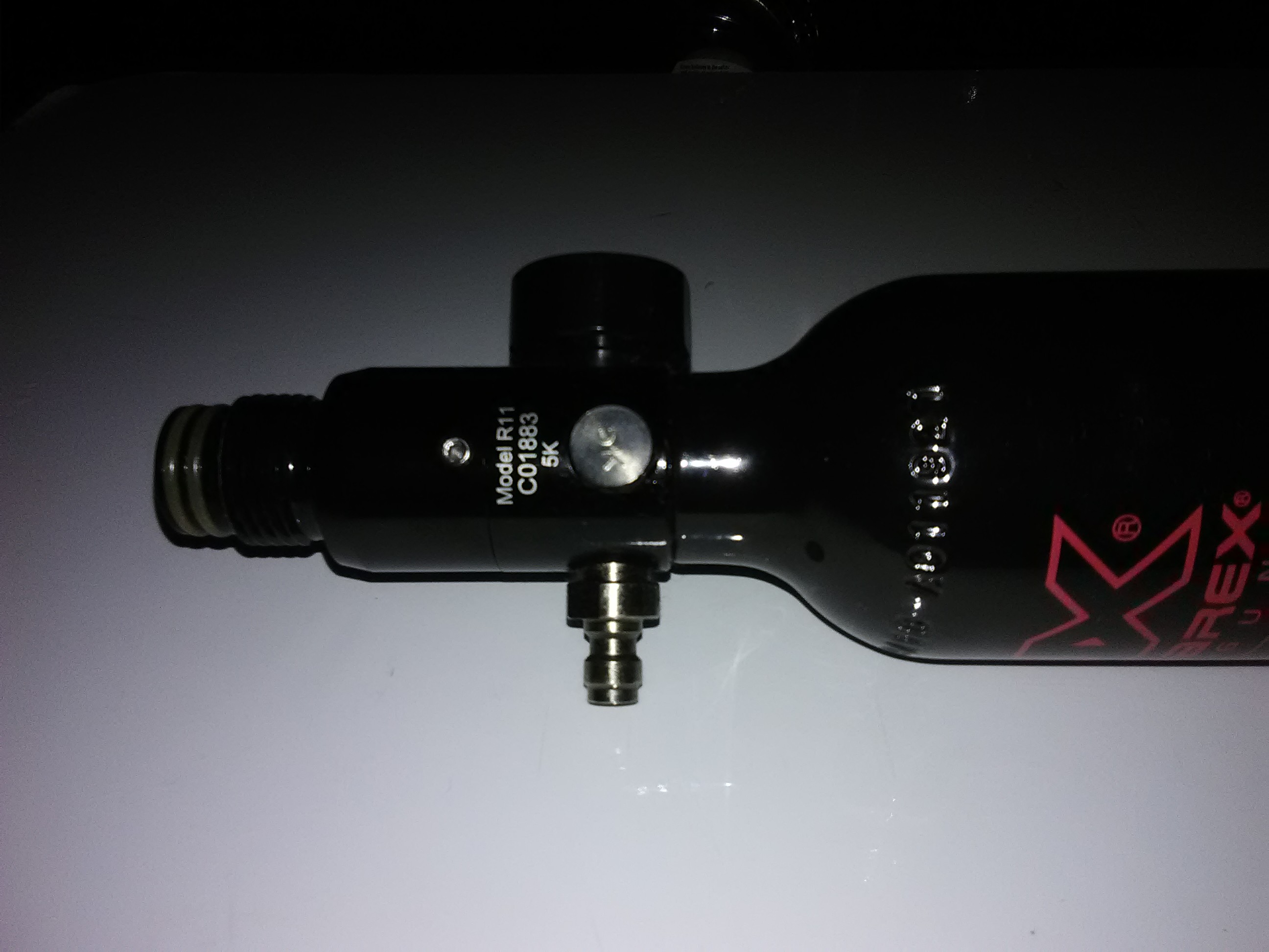

Lobi,
This regulator/tank combo is from my Umarex Gauntlet, a style common in the sport of paintball. The far-left end, with gauge, fill port and threaded end, is the regulator. The tank, or bottle, narrows at the neck and screws into the regulator. Since fill port and gauge need to be horizontally aligned to fit in shroud openings, the manufacturer found, when all is properly tightened, things don't always line up. So, to correct this, the threads, at far left, which screw into main block, were SLIGHTLY loosened till fill port and gauge were horizontal, understanding the end twin "O" rings will still seal and, when pressurized, the threads will lock tight. Recall some Umarex owners were concerned with this loose-fitting part and Hajimoto explained reasons for and a fix. This is as best I can recall of this matter, don't know if Hammer is the same design, finding the Hajimoto video would be necessary to verify. Best of Luck, WM
Lobi,
You're welcome, I'll assume from your response the Hammer has a similar regulator/tank system. If I recall correctly, Hajimoto's fix involved set screws and lining up the regulator. Been almost two years now, and my memory isn't the greatest, but I think this explanation is accurate. Learned all from Hajimoto videos so searching those to verify would be best. Good Luck at the range. WM
