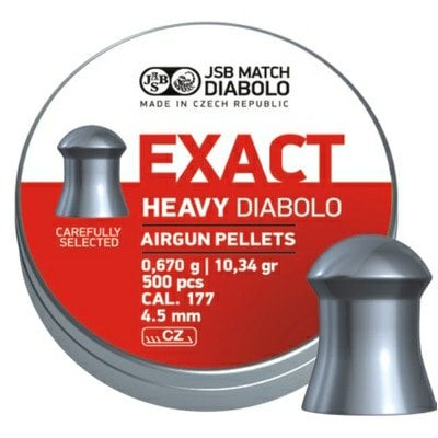

JSB is some high quality stuff with good tolerance and softer lead that uses the initial blast of the air to expand the skirt into the rifling and that's why they are accurate pellets in lots of guns. The Crosman alloys used are harder so they don't form to the rifling as tightly however because they're hard you may not find as many crushed/deformed ones in a tin as you'd think for their cost so they can also be accurate.
If you want to try heavier Crosman try these they are sorted by manufacturering die so all are from the same place unlike the 500 tin:
Or if you want to stick to JSB I have had great luck ordering from here it is always so well packaged, lots of bubble wrap etc:
FX is just rebranded JSB you can save a couple bucks:
