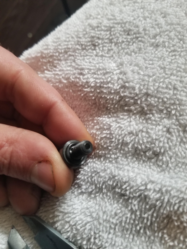

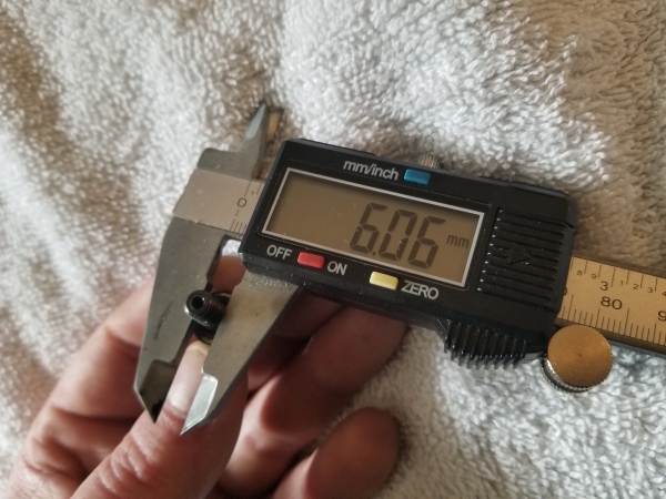

Do you still have the M5 stock mounting boss? Where the boss is that connects your stock to the action where it threads into the action is it a M5 or M6 thread?
Just found out this is another difference between low power and high power factory Royales. This might be the missing piece of the puzzle. I have also bored the ID of the threaded part that goes into the action a bit, the way you see there's also a side port in the threaded section also bored out by me. This is after my initial results however and my measurement shown here is the high power version which is why I ask. You might still have the low power version.

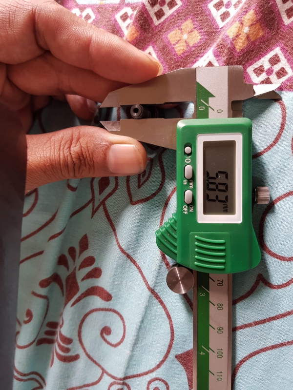

dear Glen,
here is the pic of my gun'gun's screw. I think itit's M6. With use and due to slight error in caliber it shows aa bit less.
see it and comment please.
it looks 5.83mm.

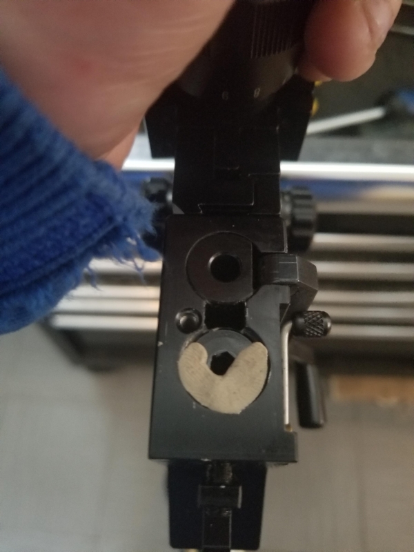

Drilled out my low power setting on the power selector and lowered my reg pressure to 150. Got it from 158 or so bar to 150 on the nose on the first try, a miracle haha. So now I have it set at one full turn back from bottomed out on the HST on high gives me 870 with the heavies and on low gives me 920 with the kings. Typically if you're shooting the heavies at one speed it'll be about 100 more fps I've found. Got the drilling out the second setting idea from Mentalist I believe.
A turn and a half back gives me 830 with the heavies and I would assume 880-890 or so with the kings. In Canada even if I can set the power low it's still a "firearm" so really no advantage to a the original low setting for me. If I ever sell it I can just buy a second power selector and include it.

And also wanted to say thanks to whoever gave the tip about using plumbers putty to keep the HST from moving, works wonderfully as I'm constantly dialing it down to where you see in the pic for indoor plinking. The (lo) column is after drilling out the low speed setting a bit to shoot lighter pellets.
