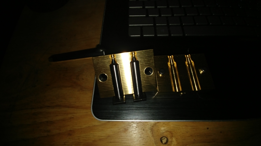

Got 2 new NOE Molds in mail yesterday
HI I got 2 molds in mail yesterday from NOE
1 is .22 caliber pellet Daiblo . 20 22 ,23 25 26 gr It is made from brass , very nice machining , it has 4 sets of pins to get to get different weight pellets , I made a few they look great but it i 2 cvity mold so it is slow ,

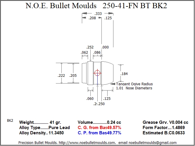

2 .25 caliber aluminum BOBs botail mold 4 cavity aluminum
1553435330_3877809105c978ac245e204.16026030_n.o.e._bullet_moulds_250-41-fn_bt_bk2__sketch.jpg
