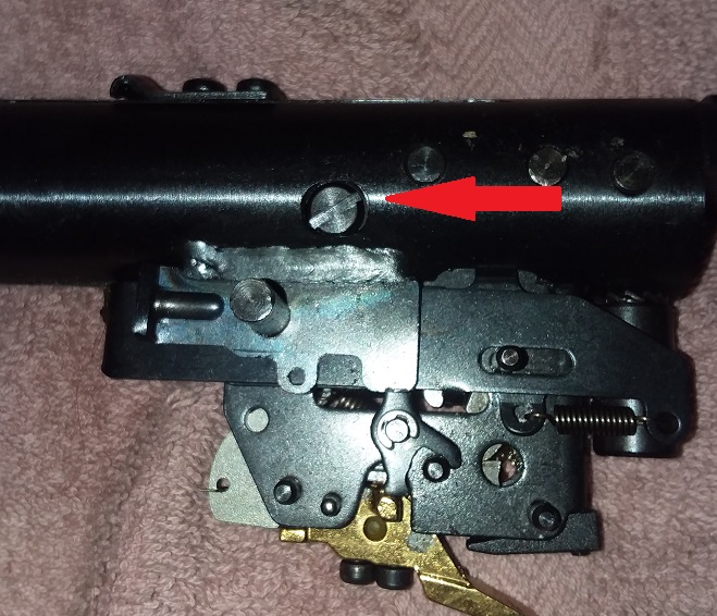

Been awhile since I've bought any guns, including Hatsans, but rumor has it they were discontinuing the pressure relief screws on the better Vortex gas pistons. Easy way to find out if yours has one is to take the stock off and look at the left rear of the receiver. You'll see a stamped hole back there which is the access to that screw, looks like this:

Someone by all means correct me if I'm wrong, but I think from the factory, they're charged to 135 bar so very obviously use caution if you're wanting to release a little pressure from the gas piston. There's another stamped hole on the right side for inserting a Hatsan fill probe. Let a little too much out, insert the fill probe, watch the gauge, pump until you feel the pressure and look at your gauge again. Only takes a pump or 2 to add a little back. Also how to add air if you want more a little more power out of it.
Spring versions I don't think anyone makes a kit for them other than Hatsan, if they even have any, selling you a replacement spring or if it is a gas piston, selling you one.
Lol..thank you teacher :) Stupid me shoulda remembered if it's got a Vortex gas piston, it will say so on the receiver. No need to look for that screw my red arrow points to since it won't be there. Never bought one myself because I already have guns in 4 calibers, not rearranging my pellet shelves to fit a 5th caliber and if I want more power, I got a couple .25 caliber PCP's.

I think they are supposed to be filled to 150 bar on the 135. About 125 bar on the 95. My 135’s were about 135-140 if memory serves. The let off screw is easy to unscrew and no worries about pressure. A slight break in the seal and the air comes out slowly. Built like this for safety reasons. I tried filling my 95 to 150 bar and it was a rocket launcher. The stock however was its victim. Started eating it up. Needs the heftier stock and weight of the 135. Had an issue with one of the Vortex rams and Hatsan sent me a new one. $40 because it was out of warranty. They were good and fast. The replacement ( if memory serves) did not have the let off screw. I have the original and will rebuild it if and when the replacement gives up the ship.
