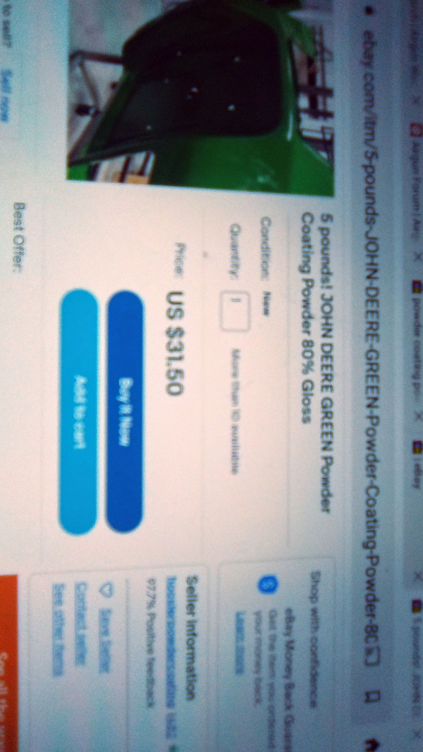

5. Powder coating slugs. Actually the clearance silver and cheap eBay AG green at $5.00/A pound worked better than some at $20.00/pound

Reedmosser, enjoyed reading your list. Good stuff for sure. I am enjoying powder coating my bullets. Thanks for talking me into that one. Looked for the cheap AG green powder and only found $12 pound plus $9 shipping .

I only have one Lee mold and its a .515 450 grain. Probably ok by the time I size to .510. Being large dropping outta mold. That AG green I got.on eBay a few years ago. Also sometimes get good deals from Columbia powder coating clearance deals. I don't think il.ever use the 15 lbs of powder coat I have. A pound makes slot of.slugs even in .510. Definitely pretty cheap
