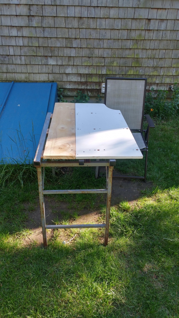

    I like Jimmy's idea. I used a fold out frame from an old chop saw table I had. Works great, folds flat, and if heavy enough to stay stable. There are many types of fold out legs so search them and then make a top. If you use plywood I would suggest a band or 1x3 to stiffen things up.
    If the legs you buy can not be adjusted I would suggest making sure the are separate and hollow. Being able to drive the legs into the ground an inch or two greatly aids in the tables stability.

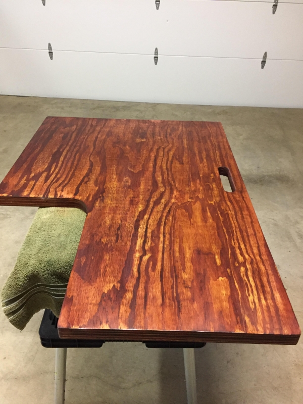

    I tried adding those legs to this table top and it it was just too unstable.
    I'm going to add 1.25" black pipe (with 15 degree angled fittings) for a much sturdier platform.
    Two layers of 3/4" 32" x 44" with 18" x 12" cutout BCX plywood.

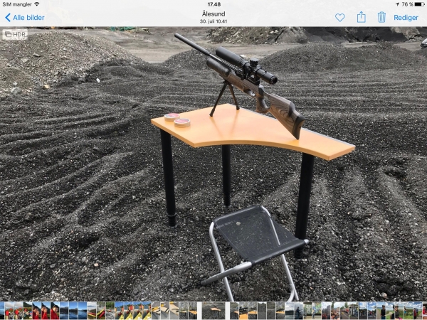

    My table is a second hand IKEA. bought it mostly for the legs but just left it all together and wrapped a tarp around the wood part. Works well, though three legs are better than four.
    Chair is a 5 gallon bucket with one of those swivel seats on top. Table was $20, tarp free from Harbor Freight, and bucket seat was about $15 total. Is it great? Lets just say it works.
    Table is $56 new, the Linnmon Table. Extremely light. But for that kind of money, buy it, throw the top away and use the legs on something a bit more shooting friendly.
    Best part is that I leave it setup and leave targets and stuff in the seat. Stays nice and dry.
