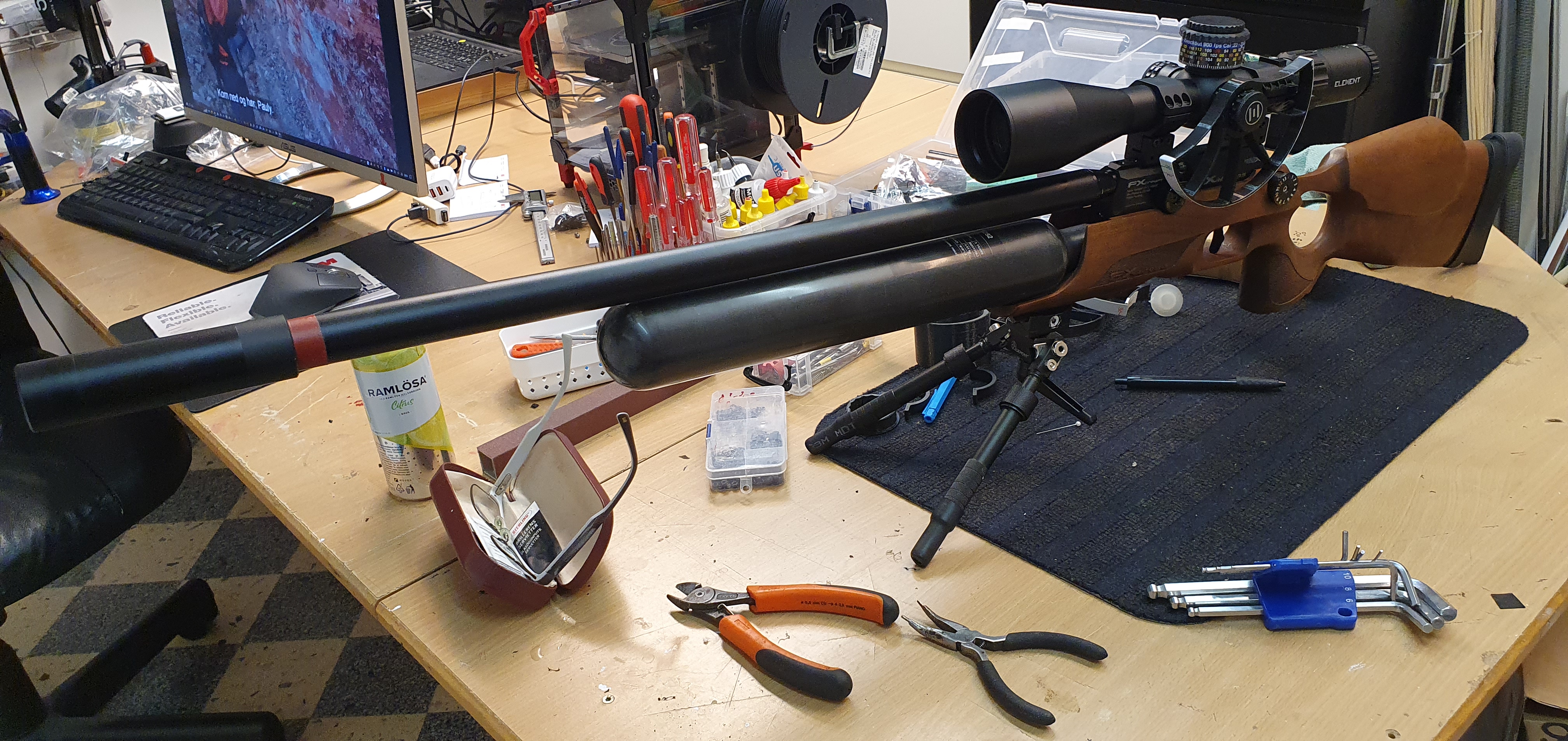

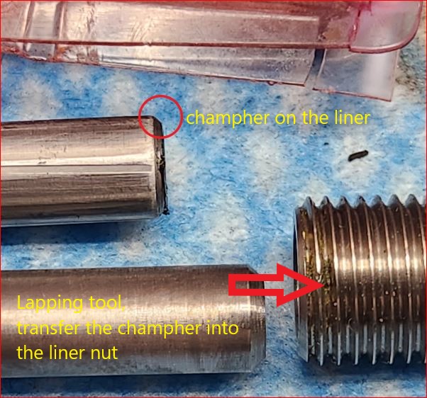

The first thing is, that I locked the liner in the barrel cannot move that 0.1mm what is a gap between the liner and the lock "nut".
Here is one old picture that can explain:

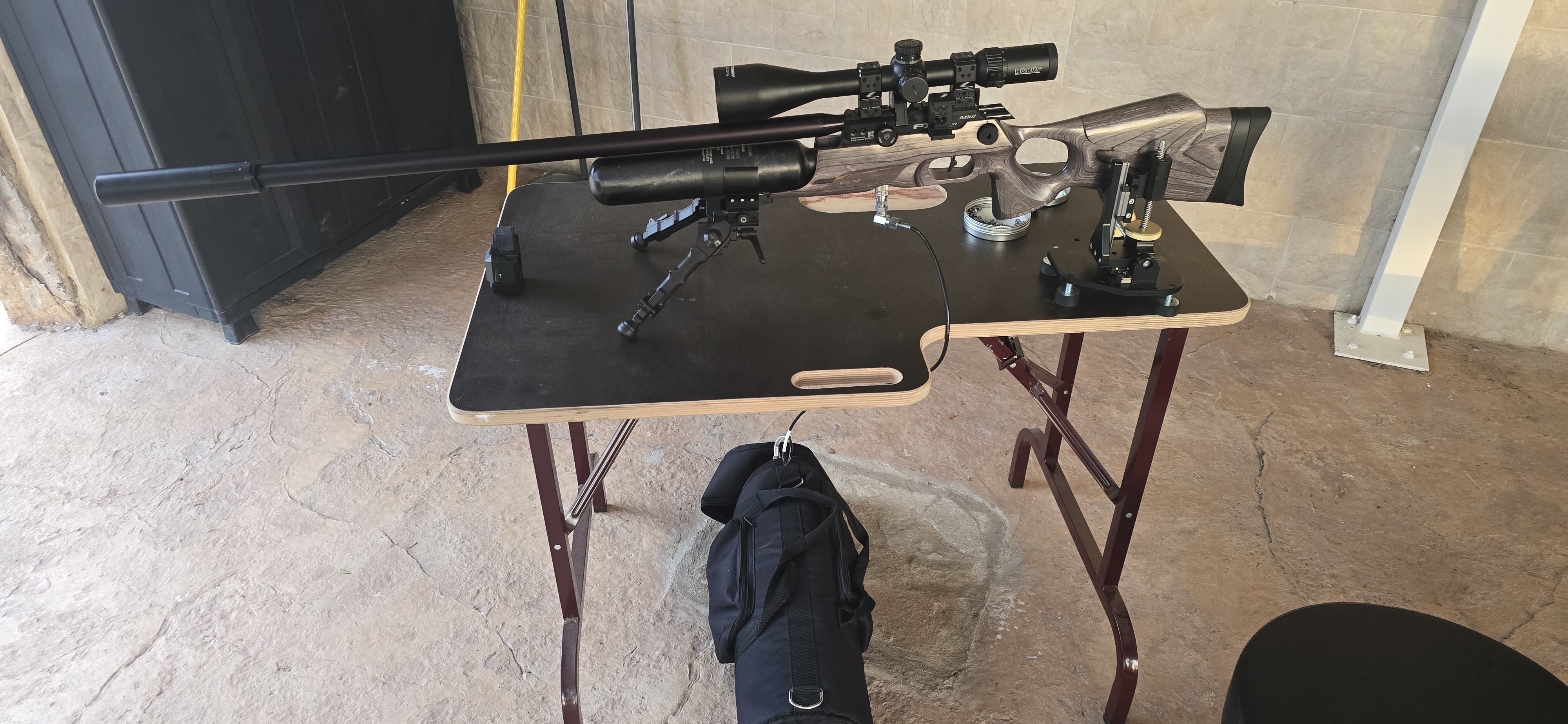

Fabricated for tunning purposes but I started using regularly - I have a one piece mechanical rest. The front swivels and the rear is L-R and height adjustable
I am using high power 10-50x56 scope and like to zoom in into very center of the target.
And with this my setup I can see what most people missing.

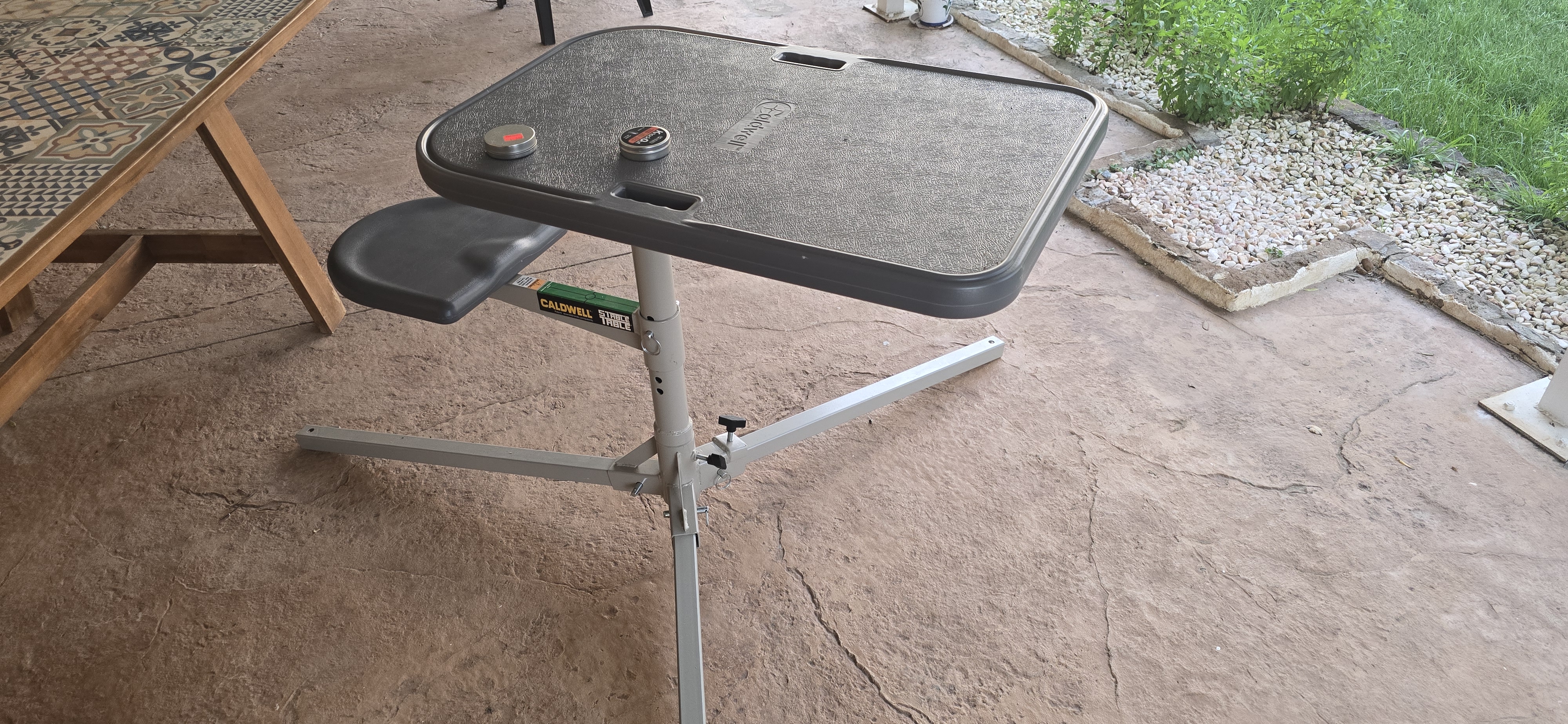

How much is the bench table top flexing? I just rest my hand on table top and I can see through the high power scope the table top flexes 4-5-6 or more MOA if I push it only with my finger.

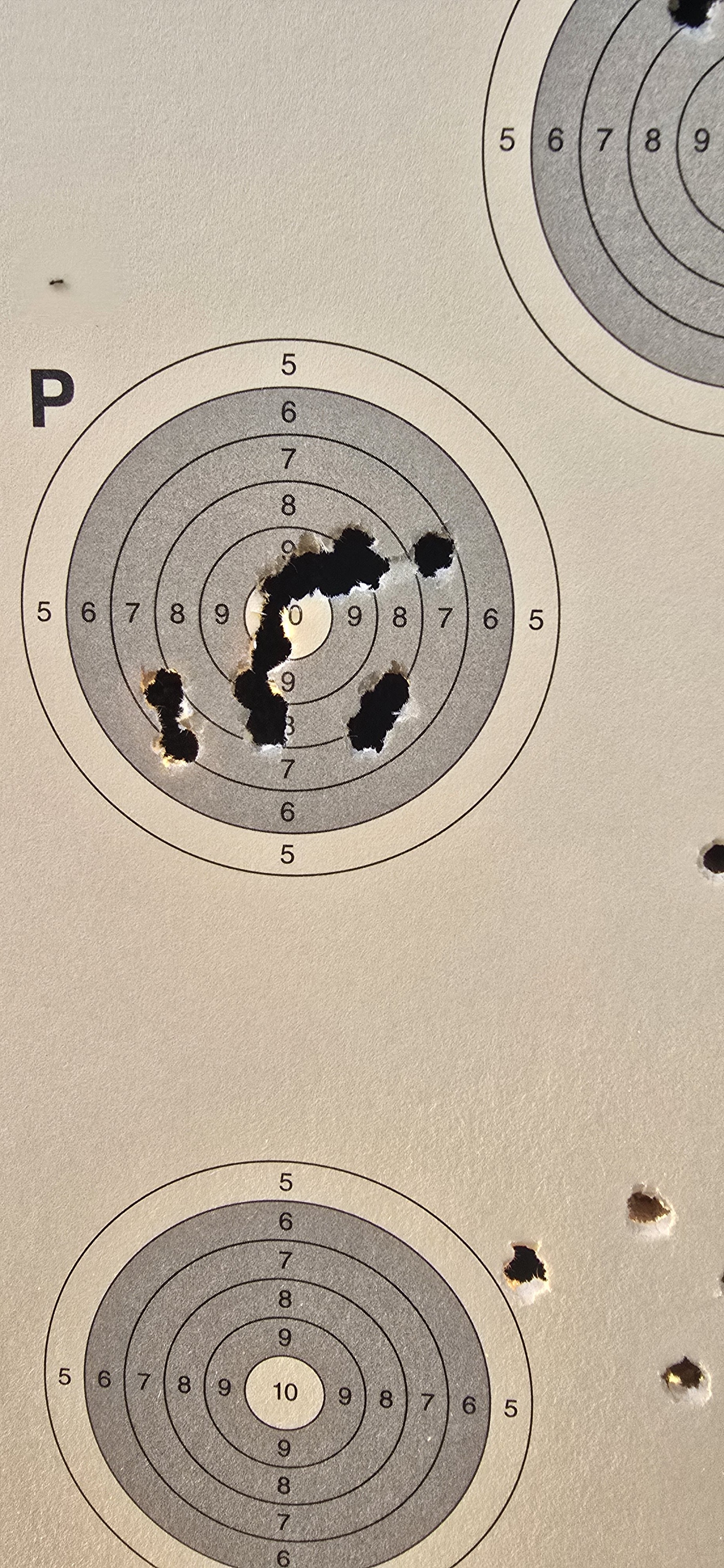

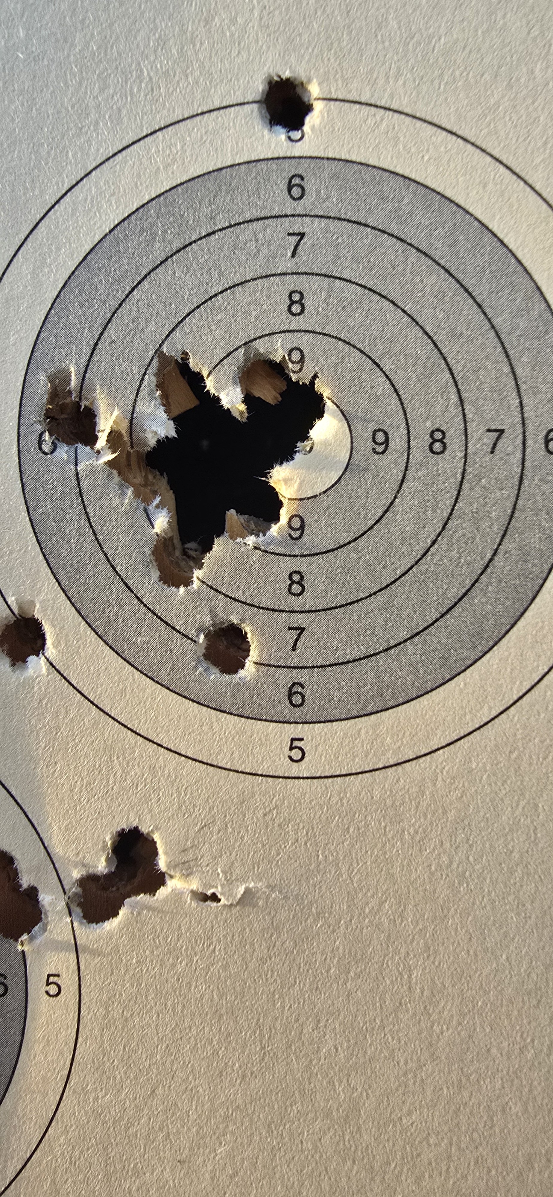

Alright, I think I’ve found the solution. Today I’ve been testing bags, bipods, barrel cleaning, pellets, slugs... until I thought of changing the shooting table — switching from a plastic Calweld to a regular, more solid one. The difference is huge. Even so, I still need to keep experimenting. I'm posting some photos of the before and after... open groups and the last group, 18-shot magazine all centered... the shot at the top was from a previous round.
I epoxed the sleeve on the liner and bought the new barrel spacers to fit and its been eliminated. If i get a POI shift its from temperature change or its dirty i have polished my barrel and when the POI shifts its usually a dirty barrel i clean with ballistol about 8 patches and its good to go takes about 5 or 6 pellets to straighten back out and its good to go
