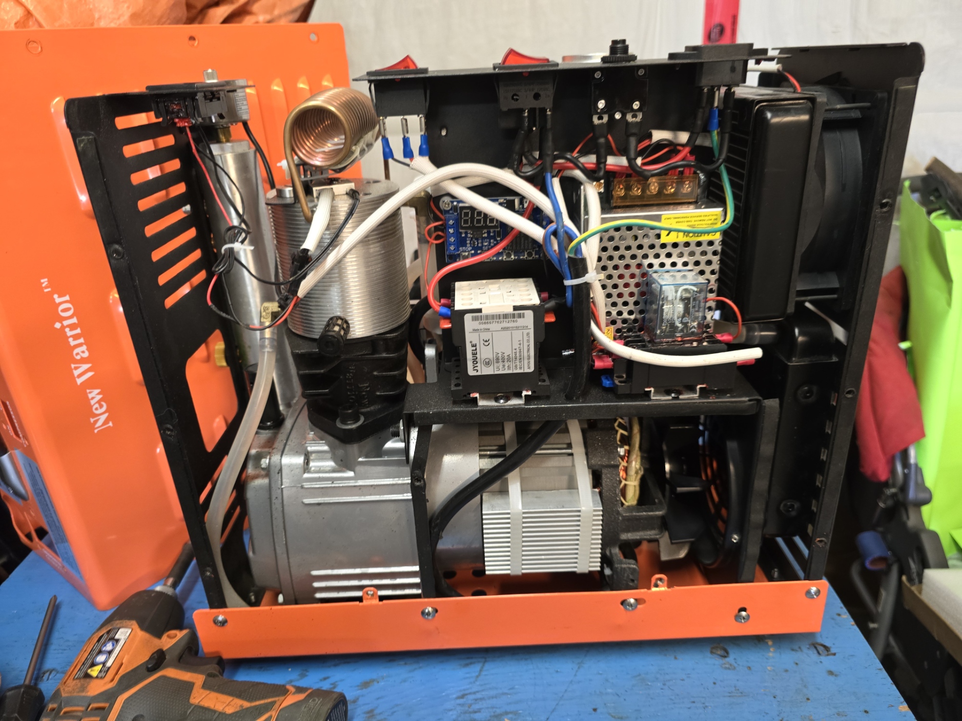

Benjamin & New Warrior look like a GX CS4 until one opens the case, then the compressor is a Yong Heng with extra bells & whistles.
