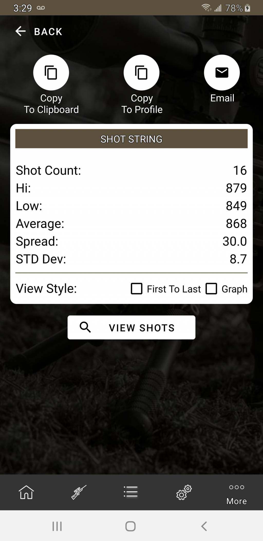

Had the gun out for some shooting/tuning. Accuracy was dead on, even in wind. Consistently hit the squirrel target wherever i wanted. Shot string numbers however were not amazing compared to what i see in the interweb.
Is that a sign of further tuning needed? or a problem with the gun? I haven't changed anything but the hammer wheel adjuster and that by only one click.

YES THATS TERRIBLE SORRY TO SAY SHOULD BE SINGLE DIGITS FOR M3 REGS TO HIGH IN THE REAR 80 BAR OR SO . LOTTA TUNES OUT THERE FOR THAT GUN TRY SHOOT FOR 900 FPS SEE HOW THAT DOES
Go dwn to 80 bar? I have seen several tunes and tuning guides. There is a split. factory specs go low reg and high hammer. A lot of fx gurus however go high reg mid hammer. over simplification for sure.
i am averaging 880 on power wheel 16. but only 18 gr projectiles. And with equally bad ext.spread and stn dev. if i lower the reg my power will lessen? Unless they passed the apex on the hammer that starts a decline?

If those are your typical 5 shot groups at 45 yards, I suggest not to change anything - those groups are really nice. Guns with lots of adjustments wind up being favored by those who like to tinker…and measure… and adjust…and measure some more. They become consumed with measuring a “perfect shot string” and may lose sight of the objective of placing lead accurately on target. Hajimoto posted a video a year or so back where he was shooting at 50 yards, and a 25fps velocity spread had a negligible effect on PoI. Trying to tune to a 5fps spread may or may not achieve better accuracy results. Not to mention…just how accurate are the measuring devices, lol. If that was my rifle shooting that well, I’d move the target out to 60 yards - and not touch a single setting- just shoot.

If you drop your reg pressure to 80 bar valve will open easier and have more dwell which can give you same speed other school of thought is shorter burst of high pressure air to give you your speed higher pressure speeds the pellet / slug up faster before it exits the barrel you want the valve closed low pressure leaves the valve open longer I like the shorter high pressure burst of air better my self

Your thoughts are close to where they need to be, please do what you are thinking process wise before you change the reg!
That will be good for you to know, and I mean adjust the hammer all the way down and work up slowly, your higher reg mentality is absolutely true on the shorter barreled Fx guns! Max hammer and low pressure is the polar opposite of harmony, just think about it🤔 good luck

I personally wouldn’t adjust the reg till I know what max fps is at said reg pressure. Here are the steps I would take.
Open valve.
Increase HS till fps no longer goes up.
Adjust reg till you 5-7% higher than your desired speed. Back of hammer will your just a couple fps faster than you desired speed.
close valve till you hit desired speed, this takes really really fine adjustments.
