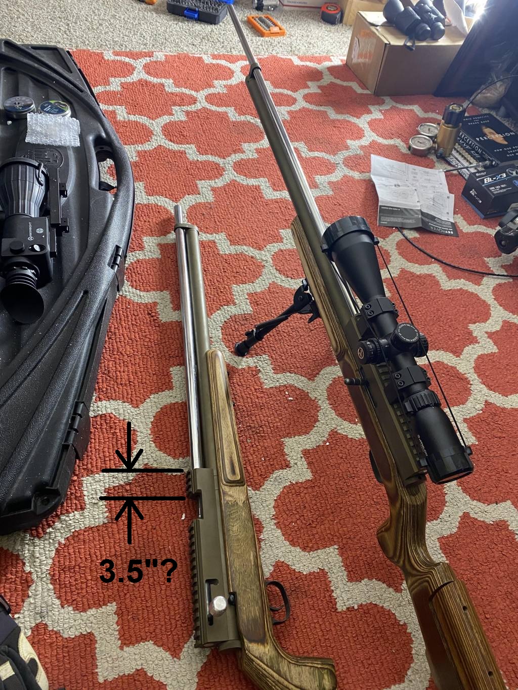

Jack's son in law, John Bowman perfected the design and builds them for those that want a rock solid platform. The Lilja is threaded 3.5" into the receiver. It's done with such tight tolerance the threads can't be cerakoted by Eric in Oklahoma. That's the only thing John doesn't do himself.

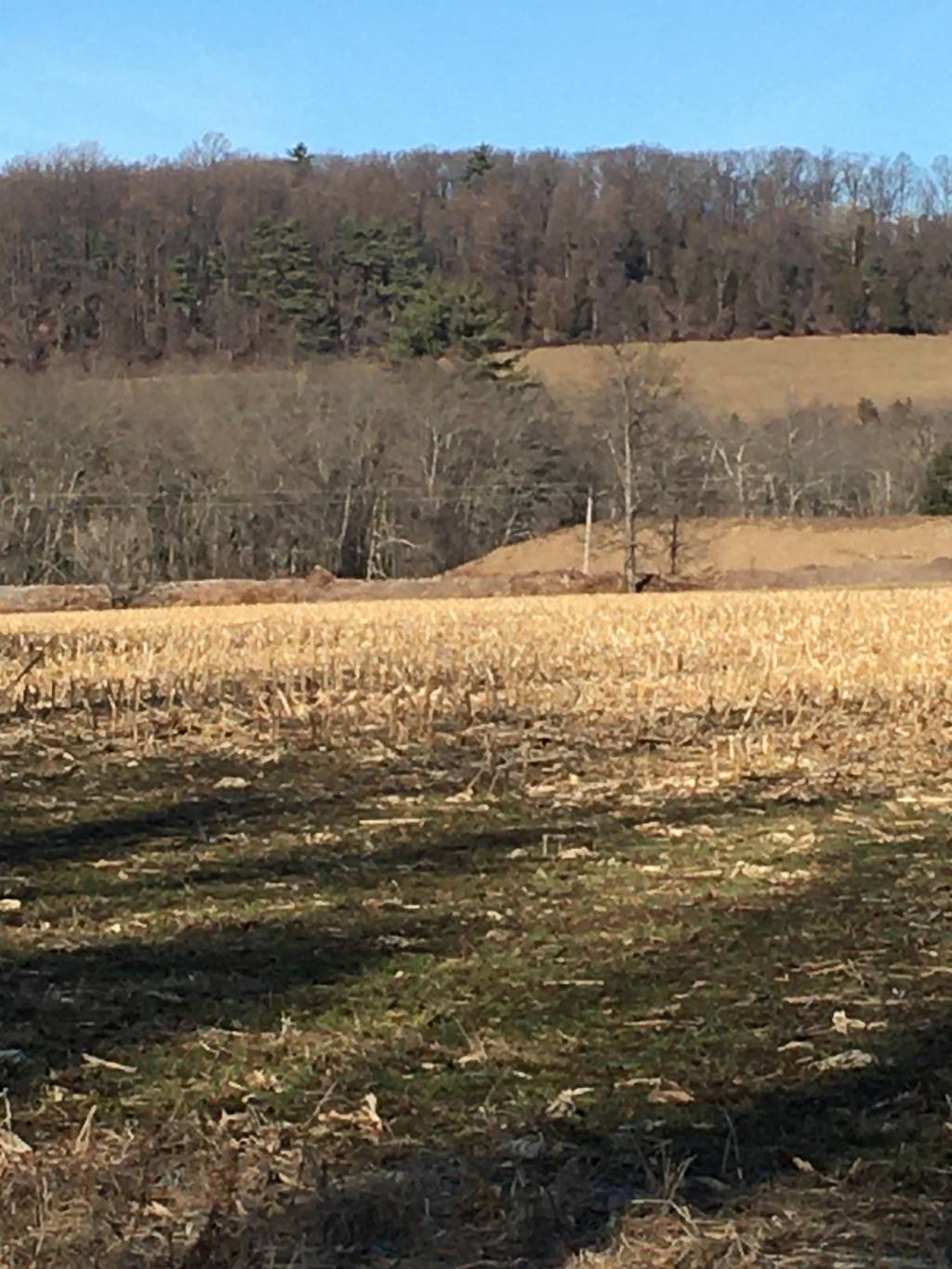

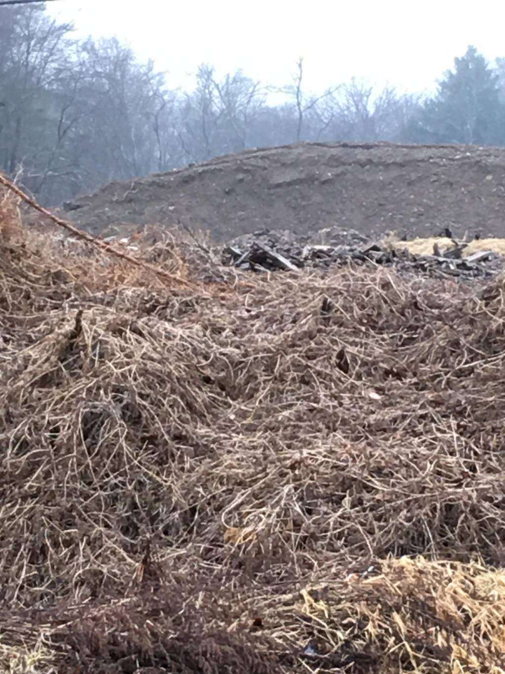

This is where I shoot long range. I have up to 600 yards but I won't be pushing slugs past 400 much until I get Tally rings or a Gen 4 Cold Shot riser. Using low magnification 2ndFP windage reticle and lots of holdover to start. Those mountains of dirt and clean fill give a great visual splash.

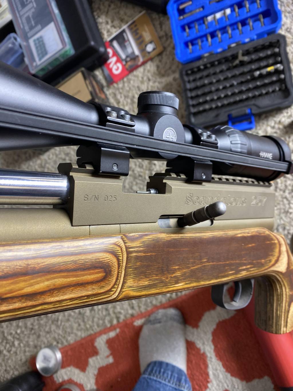

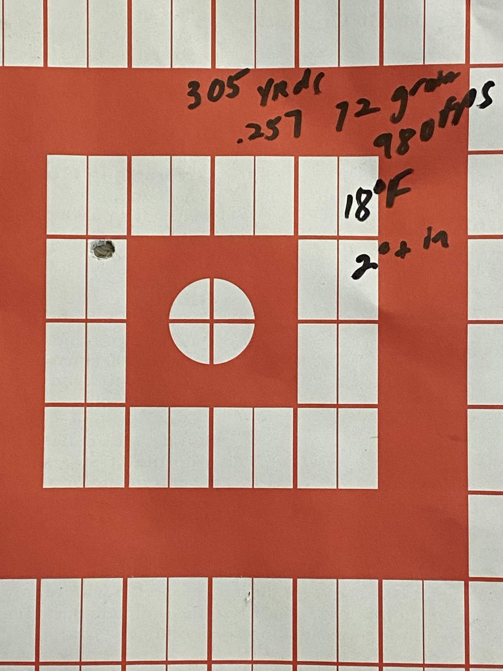

I did post a picture of same type 6" red square bullseye target that had been hit once at 305. It wasn't great but I was happy my cheap range finder, chronograph, micrometer, & StrelokPro had got me on target and good enough to be considered a good shot if had been say a Coyote. Not a impressive group but for first shot using a 130 yard previous zero & shot at that time with a 9x Hawke AMX Airmax, I was happy with myself and the Scandalous.
It's got so much unbelievable promise. It truly deserves a tier 1 scope and a mechanical rest. I also am trying to decide what barrel to have shrouded or threaded.
Not bad for 305 on 9x magnification first try. Thanks to John Bowman I know if I miss it's my fault.
