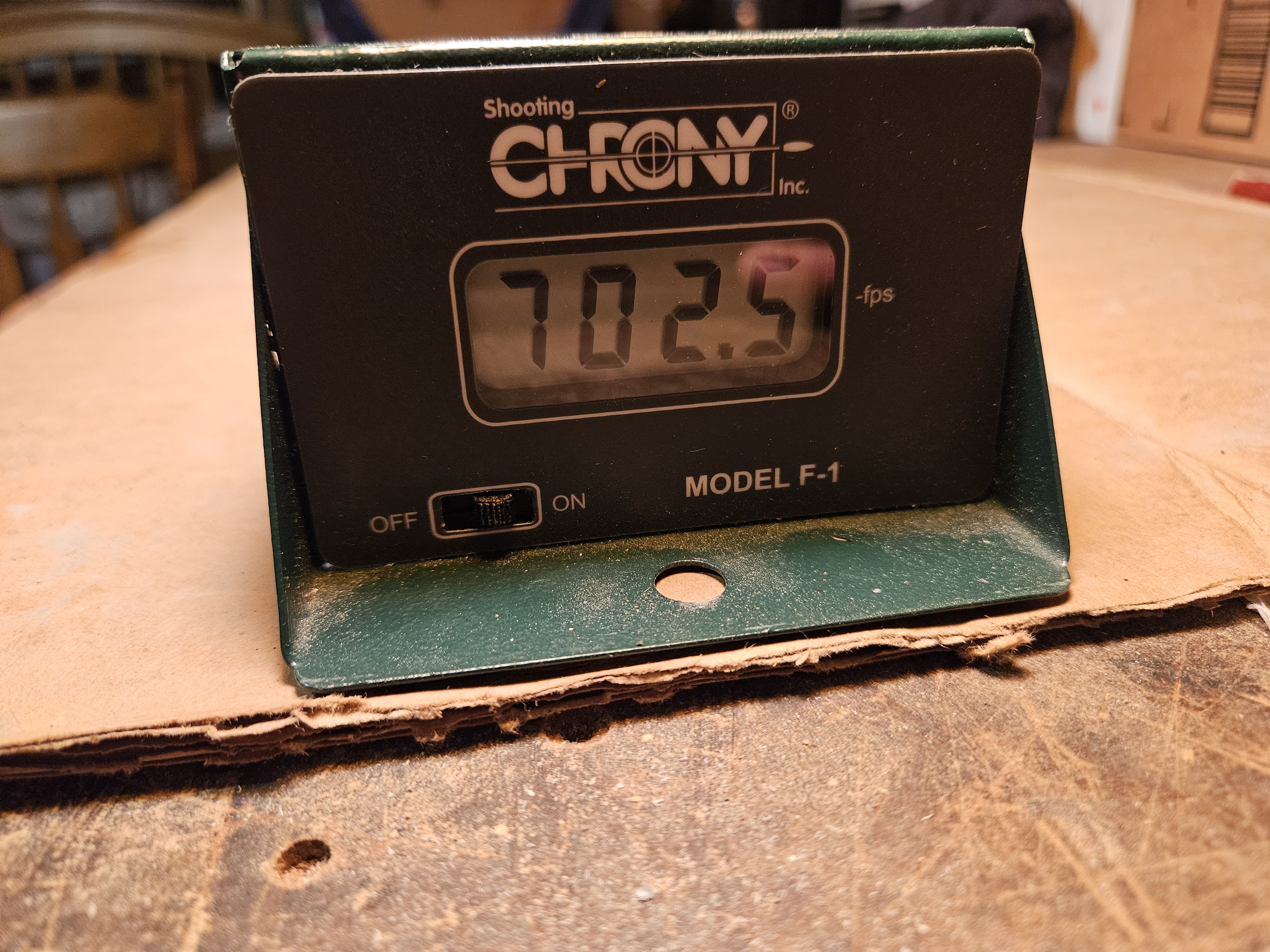

596 fps! So I gained over 100 fps from going up about a 16th of an inch!
Well I said F it, and drilled out the action to 1/4" right through the transfer port adjuster. So far its holding and not blowing out the side of the gun.
I bored the valve exhaust to 1/4", replaced the valve spring with a much lighter one, and filled to 250 bar(capable of 300). Here's the results.
Overall, I'm satisfied. Needs a moderator BAAAAAD! Shakes the whole house when I fire it lol. Got my ears on, so thats good.
I will be ordering some different hammer springs to try, but im sure I'm getting close to max. Considering the bighorn gets around 750-800 fps with similar weight pellets, I think this is a good velocity, since the BH has a bigger hammer and valve system.
