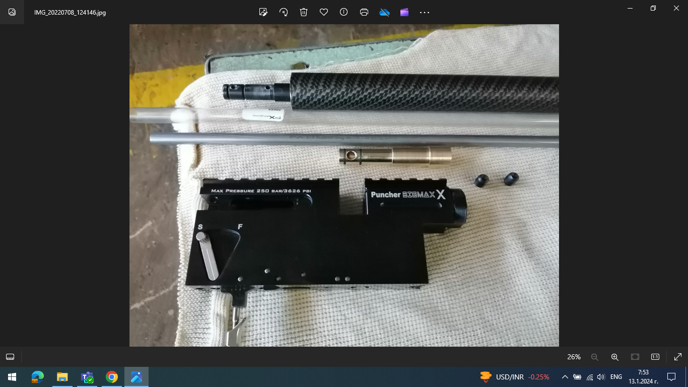

Здравейте, мисля, че няма да загубите успешно от 25 на 35 калибър и да получите добра работа с пушка. За да се постигне добра скорост на изстрела, дупката на целия въздушен път (тялото на клапана, цевната кутия, цевта) трябва да бъде нивелирана. Но ако искате да запазите способността да стреляте и от двата калибъра, не мисля, че ще го направите. Ако не обработите отвори на цевната кутия след поставяне на цев от 35 cal, отворите на цевта ще получат половината от въздушния поток. Но ако решиш пробвай.
П.С. Снимката е когато правех един Бигмакс Х със вграждане на цев хеви лайнер 700 мм. ;)

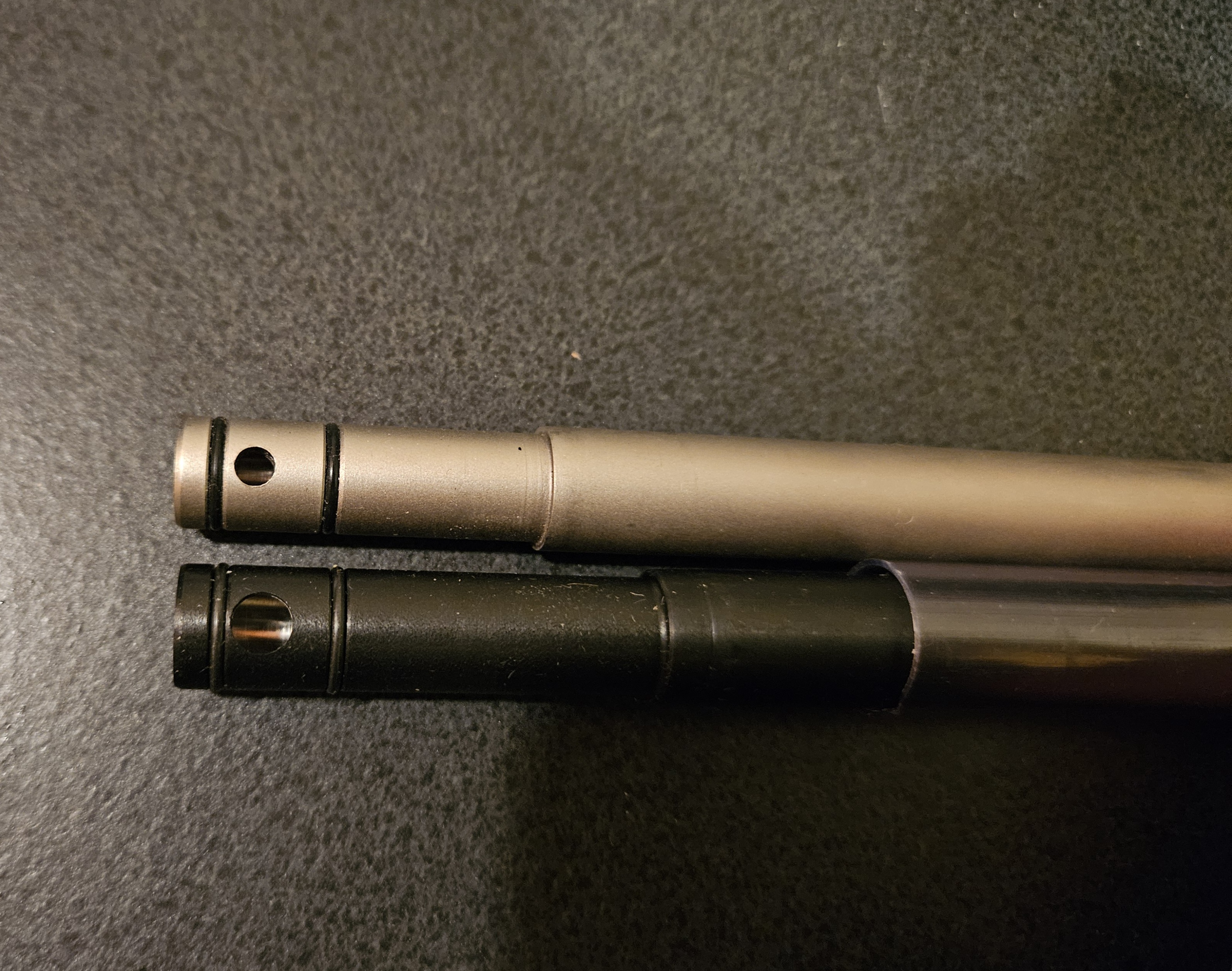

I picked up the parts for the swap today. Bolt and mags will definitely fit, but the barrel is too big around to fit the breech and too thin IMO to turn down to fit, which was my original plan.
Port in the barrel is about 5/16" also, so at this point, I'm going to try and track down a used jumbo in need of repair, or maybe a pre owned 30 cal big horn and just have both big bore calibers.

Interesting.. I like your idea there! You Got me thinking about doing something similar with one of these barrels.
Any way I could get you to measure the outside diameter on the barrel where it’s supposed to go into the breech?
Thanks
Thanks
Will do when I get home and get a chance!
Reactions: Rvaughn
The breech end of the barrel measures 1.95" as best I can get with my caliper, and is exactly .5" diameter. So call it 13mm bore in the breech to accommodate o-ring space. Outer diameter of the barrel is 15mm and it has a step back down on the last like inch that I didn't measure. Appears to be back down to 13mm and then goes into the 1/2-20 thread.

The 1/2” OD is perfect. I’d just need to turn down another 1.7 inches of the barrel to that same od due to the long breech on it.
