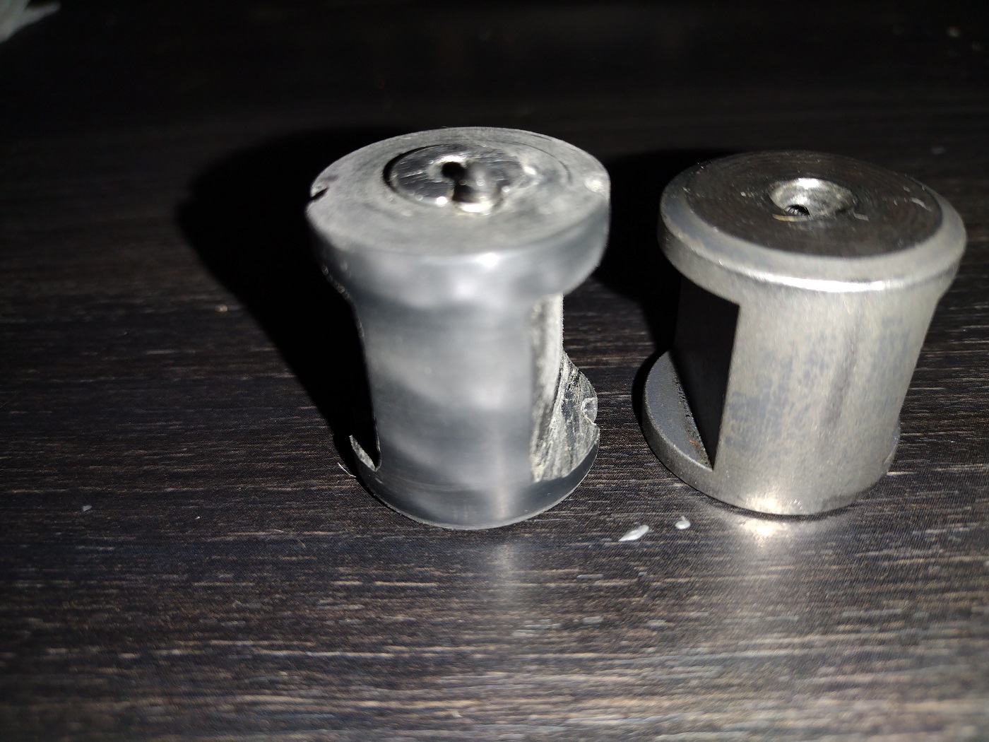

Going to extremes with balanced valves
This one weighed 12 gr which was a 1:1 copy of the stock but made in Nylon MDS
Instead of preload or shaving more off the hammer just a idea
I require preload on the spring due to limited spacing and my ssg build which allows my current .04" gap, and I am lightening the hammer because I want to run the lightest possible hammer that will plateau my valve with said preload on my 7lb spring. A preloaded spring + free flight is the goal of an SSG. Thanks for the idea but again I already run a gap/free flight.

No problemo, was good advice if I hadn't been using free flight already. I'm not so much solving a problem as exploring how light I can take the marauders hammer design (with my ssg and longer throw that requires a hammer of 1.2" in length opposed to the 1" stock). I am hoping to hit 7-8 grams dressed with striker/cocking lug.

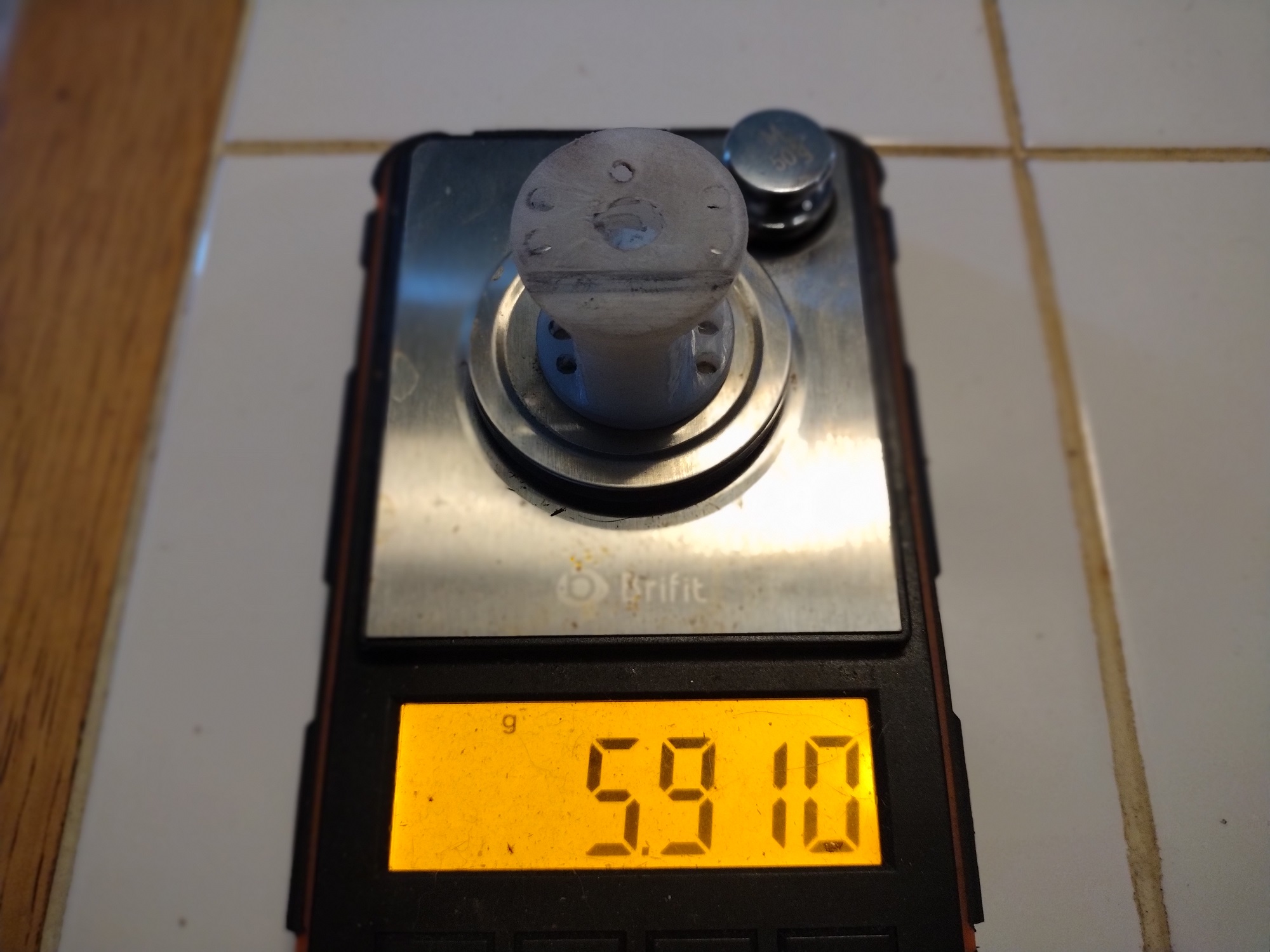

I know many marauder modders are long gone but, figure I update what a balanced valve CAN do when taken to an extreme, while some guns already boast similar, this was a complete DIY approach on a dated platform. Who says turds can't be polished?

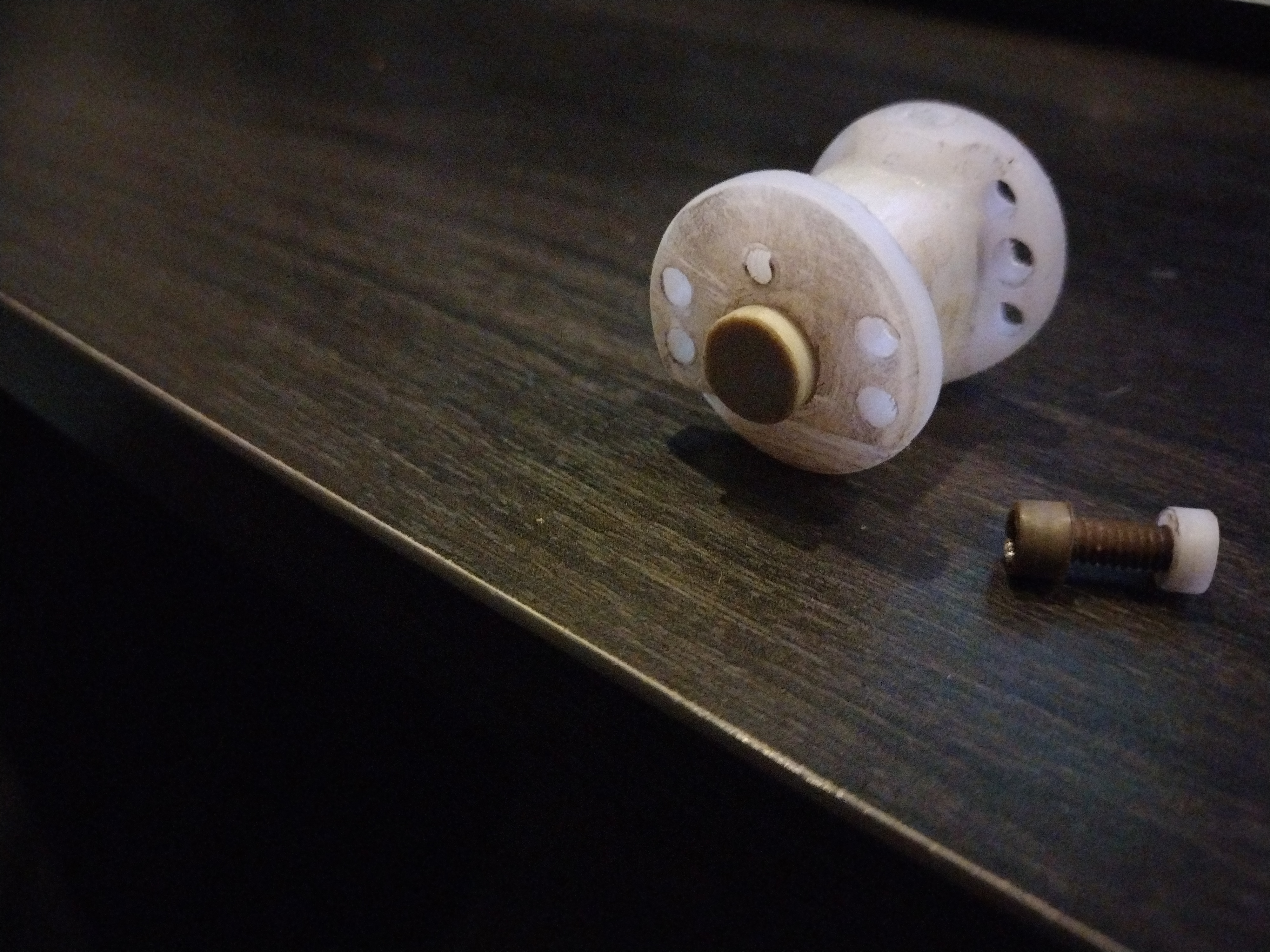

I never updated the thread since I went sub 8 gram hammer a month+ ago when I made one at 6.9 grams, since then I decided to try another design that is even lighter for a giggle.
Newest hammer made from UHMW, only 5.91 grams. Shot cycle is incredible, I am in the sub 2 ms hammer locktime even with a 3# spring.
That'll close this chapter for myself and going to extremes with 'balanced valves', as I feel there I can't go much more extreme without diminishing returns, and this is an end goal I set for myself on hammer weight.
The offset on the face for the sear is so I can run a fairly flush striker while still utilizing my lift limiter, plus it shaved a tad more weight.
-Matt

Dressed with the peek lug and striker its at 6.6 grams right now, gonna shave another hair off but this is where it'll be! I still plateau on just 5 lbs of spring.
Once I hit sub 10 grs the strike became imperceptible, so little momentum anymore.
-Matt

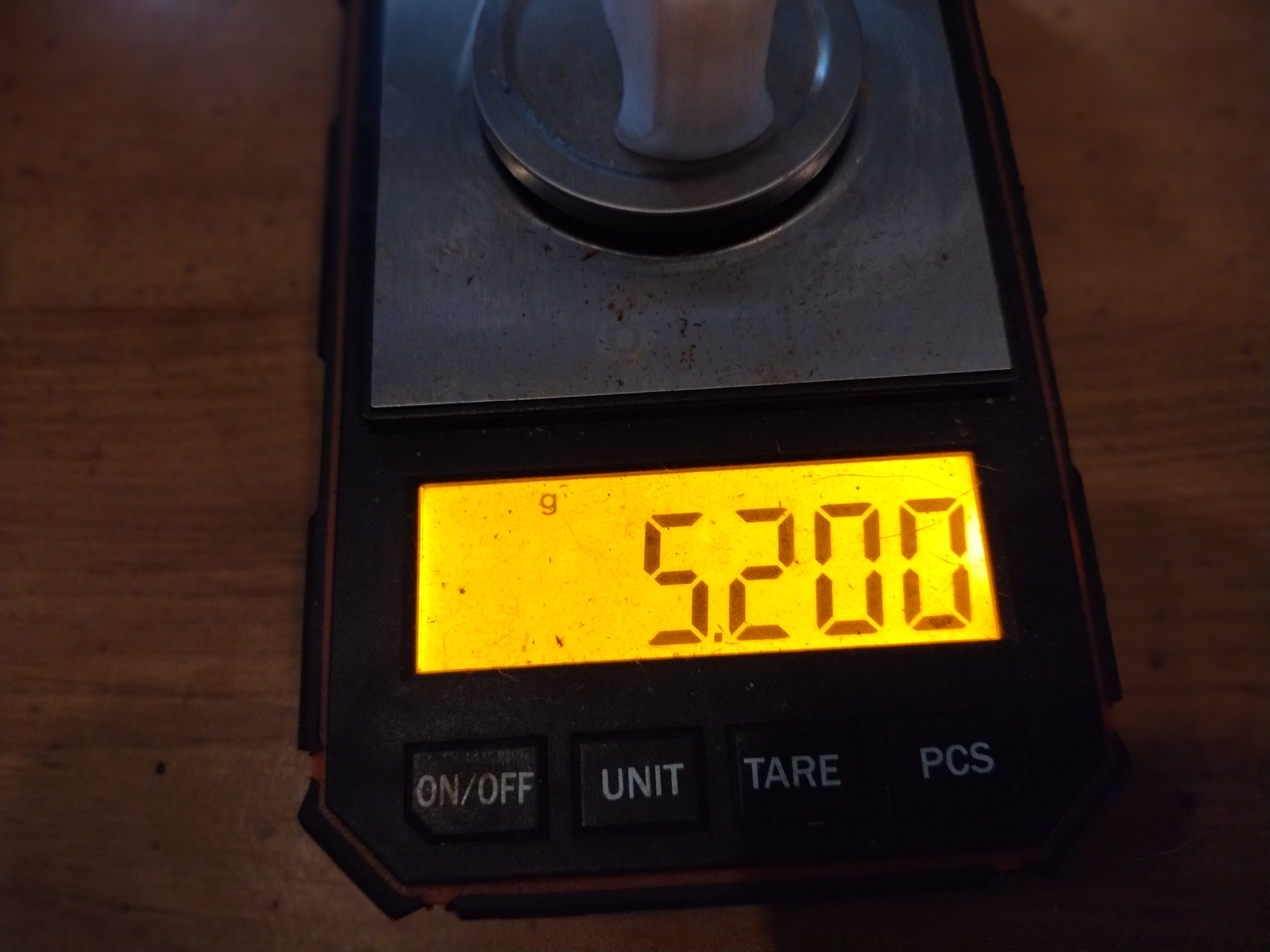

What can I say...I can't help myself...this is the fully loaded weight with striker and cocking lug.
I am also running only .53" hammer travel currently and plateauing on just 5 lbs of hammer spring with about 0.05 preload or so, so around 3 lbs to cock the gun, alternatively a 3# spring with .45" preload also plateaus the gun currently, the 4.8 lbs weight of the gun easily cocks the bolt itself if you let gravity take hold while gripping the bolt alone..
-Matt
