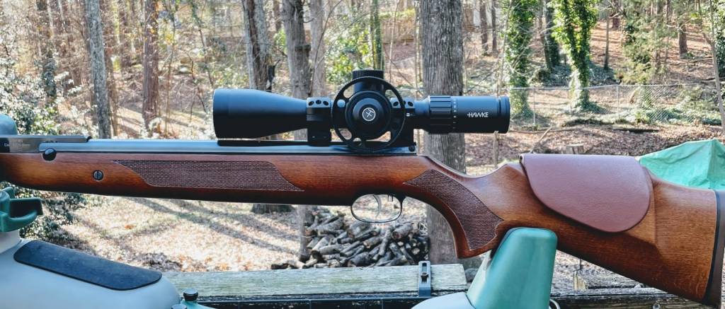

I believe that you will want more magnification than 9 for an Air Rifle but that is just me. I use a Hawke 4-16 x 44 mm IR, SF compact scope on my HW95.

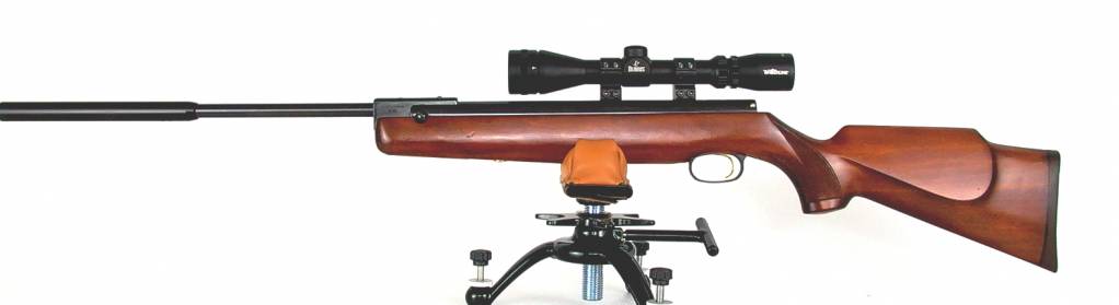

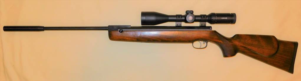

Once I received my fully tuned R8 back from Paul Watts I installed a Burris Timberline 4.5-14X with the ballistic plex reticle ( I like this reticle). Small, lightweight and focuses down to 7 yards.
Another good scope but no longer in production.

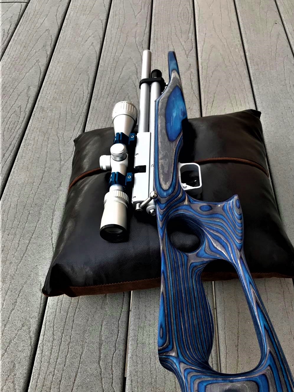

Clearidge Ultra RM 3-9X32 with the target dot reticle. In GLOSS black.
Ultralight, tough, clear, and affordable while being Japan made.
These were unknown to me, thanks for posting!

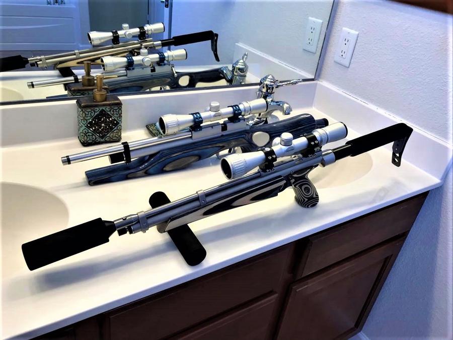

They are rated for springers, too, but they are on my custom PCP's:
I am getting a 3rd one, probably the the 14x XP, but I may just go silver RM again, as I really like silver scopes.
Their finish is flawless like my guns 😁
